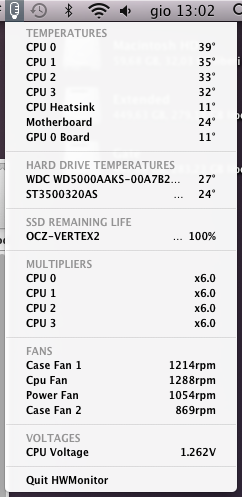

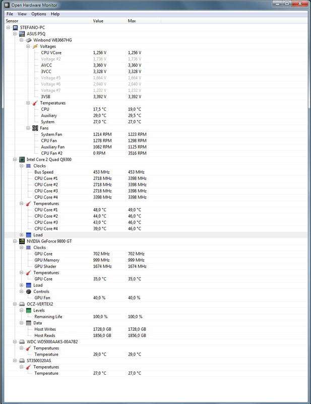

stefano.85 Posted February 23, 2012 Share Posted February 23, 2012 hi kozlek, your set of monitoring kexts works beautifully on the system in signature, apart nvclockx (updated from your git repository just yesterday) The temperature detected is not correct, you can see below the difference between windows and osx Thanks for your work and your attention. Cheers. Link to comment Share on other sites More sharing options...

stefano.85 Posted February 24, 2012 Share Posted February 24, 2012 Please, install attached debug version of NVClock and show me your kernel.log OK! Here's the kernel log with the nvclock debug version.... tnx kerneldebug.rtf Link to comment Share on other sites More sharing options...
kozlek Posted February 24, 2012 Author Share Posted February 24, 2012 OK! Here's the kernel log with the nvclock debug version.... tnx kerneldebug.rtf Seems NVClock wasn't found integrated monitoring device so trying to read temperature directly from video registers but: /* Reading of the internal gpu sensor, it not entirely correct yet */static int nv50_get_gpu_temp(void *sensor) { int temp; int correction=0; float offset; float slope; /* For now use a hardcoded offset and gain. This isn't correct but I don't know how the new temperture table works yet; this at least gives something */ offset = -227.0; slope = 430.0/10000.0; if(nv_card->debug) { printf("NV_20008 (0x20008): %08x\n", nv_card->PMC[0x20008/4]); printf("slope=%f, offset=%f, correction=%d\n", slope, offset, correction); } temp = nv_card->PMC[0x20008/4] & 0x1fff; return (int)(temp * slope + offset) + correction; } Link to comment Share on other sites More sharing options...
stefano.85 Posted February 24, 2012 Share Posted February 24, 2012 is it maybe related to the fact that i haven't a stock cooler? (it has an aftermarket "accelero passive cooler") Link to comment Share on other sites More sharing options...
