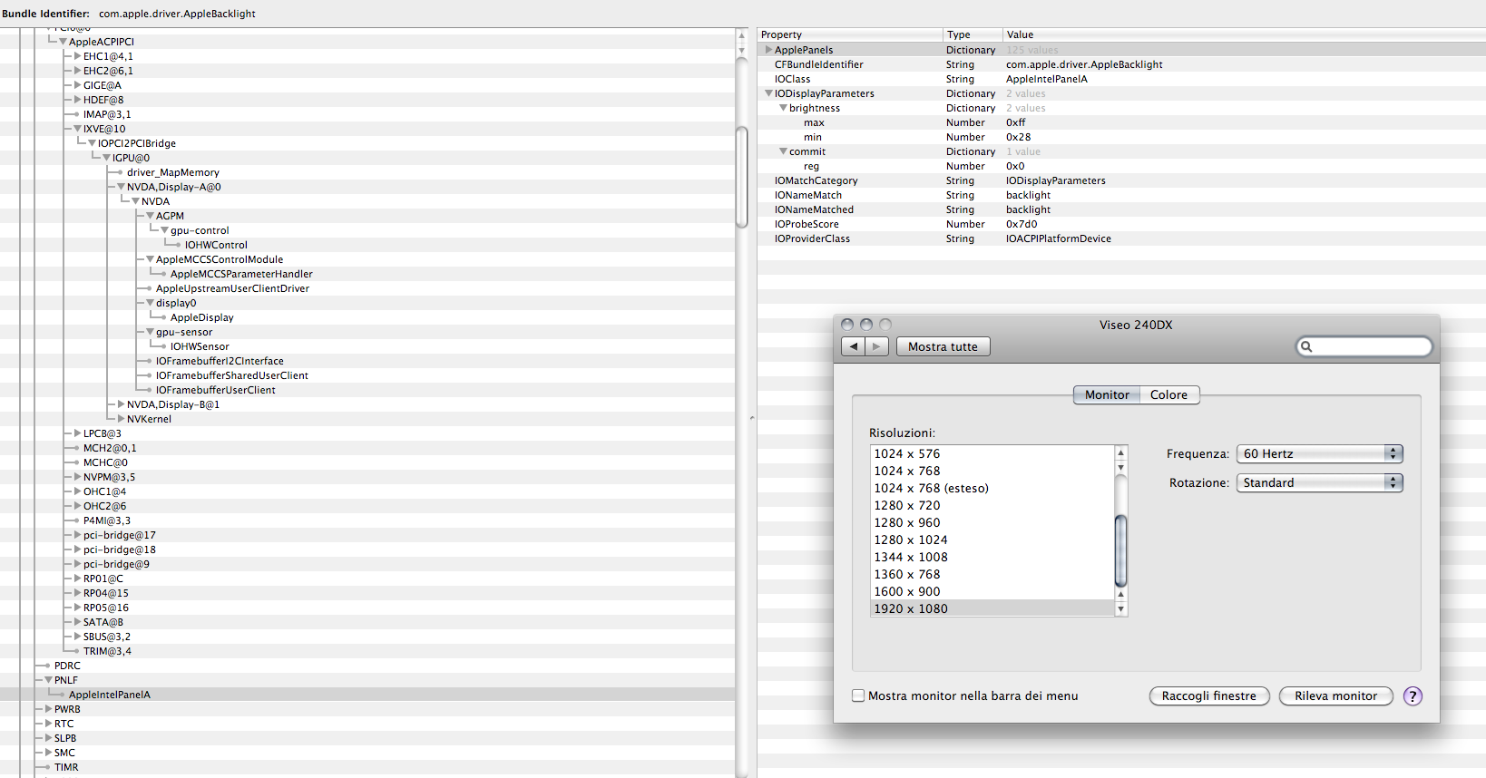

I think this is related to pwm-info.
Maybe if someone could post registers with slider working with same graphics as yours.
I posted what this registers are. Maybe writing some value on boot in _INI method could fix that.
Maybe min/max is readed from there.

Native controll (without my driver) will never work. Apple doesn't use EC to controll brightness.
I ment your other method, using native slider, not pure vanilla without your kext :(
I did it ! :-D I put pwm-info from MacBookPro6,1 which has GT 330M and I have GT 320M.
You are awesome, thanks so much.
I have the slider now and it's working with the keyboard as well.
The only strange thing is that there is delay after slider movement (about one-two seconds) before the screen backlight changes.
@aikidoka25
Pause/Scrlk work?
Native keys won't work it their scancodes are not mapped to apple keycodes.
@NIXin
Nice!!
So brightness is readed from pwm-info for this graphics.

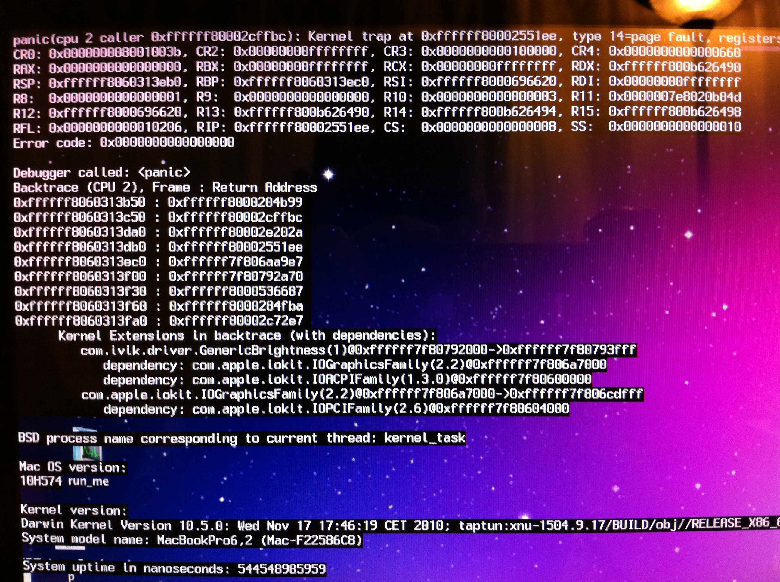

Hi there,
We just got this working on an HP Pavilion laptop DV8-1100 (VF836AV), which has an nVidia GT 320M. I had a HDMI cable connected to our HDTV for about 2 hours when GenericBrightness KPed upon disconnection of the HDMI cable.
I had done a couple of lid sleeps prior, screen saver came up a couple of times, and the brightness was adjusted a few times too. I wasn't using the HDTV anymore, so I first powered it off. After that, I pulled the HDMI cable out of the laptop and it immediately KPed. Unfortunately, the KP was most obscured by being blended with the desktop GUI, but I could see the section where it pointed to GenericBrightness.kext.
We are running OS X 10.6.5 and in full 64-bit mode.

Hi there,
This happened when on extended desktop. Here is a screen shot when inserting the HDMI cable:
So this happens right away if HDMI cable is pulled or inserted, and also at various times, such as when on web sites with heavy graphics, such as when on Disney's official TRON Legacy web site.
There is some talk that this could be caused by our AppleHDA.kext we are using. We are using an older version: 1.8.7f1. We are also having to use a legacy kernel due to HP's Insyde BIOS.
Our thread is here with all info on our machines:
http://www.insanelymac.com/forum/index.php?showtopic=221653
