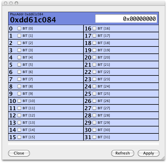

sw170 Posted December 11, 2010 Share Posted December 11, 2010 @swavek Could you please read post 50 and 193? It looks like brightness register is BAR0 + 61c084 for nvidia. Problem is that you have this register set to max, but your laptop controls brightness with EC. Try moving slider, and read that memory. If this values changes, then we could easy sync boot brightness to one from EC. Hi Ivik going to need more help with reggie_se command, no idea where to start thanks Link to comment https://www.insanelymac.com/forum/topic/236835-updated-2012-genericbrightnesskext/page/14/#findComment-1600415 Share on other sites More sharing options...

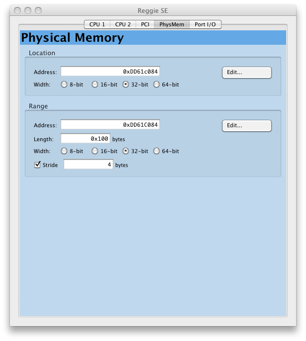

sw170 Posted December 11, 2010 Share Posted December 11, 2010 ok, found it, will post results soon.. EDIT: not doing too well here: my BAR0 is 0xDD000000, added 0x61c084 equals 0xDD61C084 typing number here: changing brightness?, huh! probably doing something dum but nothing changes any hints ? Link to comment https://www.insanelymac.com/forum/topic/236835-updated-2012-genericbrightnesskext/page/14/#findComment-1600424 Share on other sites More sharing options...
ivik Posted December 11, 2010 Author Share Posted December 11, 2010 Did you press edit on first input box (must be 32bit) and see some values? And change brightness with slider. Link to comment https://www.insanelymac.com/forum/topic/236835-updated-2012-genericbrightnesskext/page/14/#findComment-1600449 Share on other sites More sharing options...
sw170 Posted December 11, 2010 Share Posted December 11, 2010 Yes: nothing changes while moving slider Link to comment https://www.insanelymac.com/forum/topic/236835-updated-2012-genericbrightnesskext/page/14/#findComment-1600458 Share on other sites More sharing options...
ivik Posted December 11, 2010 Author Share Posted December 11, 2010 Did you press refresh after moving slider? Then try BAR0+ 0x61C084. Edit: 0x15f2 offset. Link to comment https://www.insanelymac.com/forum/topic/236835-updated-2012-genericbrightnesskext/page/14/#findComment-1600461 Share on other sites More sharing options...
sw170 Posted December 11, 2010 Share Posted December 11, 2010 with 0x15f2 I'm getting from brightness min -> 0x00000000,0x00000001,0x00000002,0x00000003,0x00000004 <-max Link to comment https://www.insanelymac.com/forum/topic/236835-updated-2012-genericbrightnesskext/page/14/#findComment-1600469 Share on other sites More sharing options...
ivik Posted December 11, 2010 Author Share Posted December 11, 2010 Don't know then. Try changing with your hardware keys then(with no sun). It should be number of levels you have in _BCL minus first 2. (ac/dc) Link to comment https://www.insanelymac.com/forum/topic/236835-updated-2012-genericbrightnesskext/page/14/#findComment-1600472 Share on other sites More sharing options...
sw170 Posted December 11, 2010 Share Posted December 11, 2010 Don't know then. Try changing with your hardware keys then(with no sun). It should be number of levels you have in _BCL minus first 2. (ac/dc) okay, will play with different setting and let you know later, thanks a million s Link to comment https://www.insanelymac.com/forum/topic/236835-updated-2012-genericbrightnesskext/page/14/#findComment-1600474 Share on other sites More sharing options...

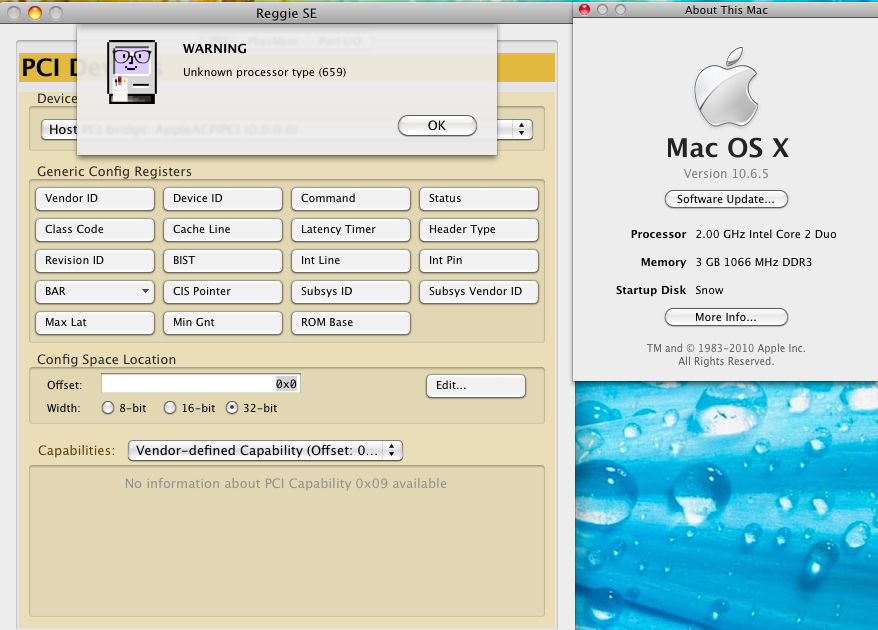

weizh126 Posted December 12, 2010 Share Posted December 12, 2010 ok, found it, will post results soon.. EDIT: not doing too well here: my BAR0 is 0xDD000000, added 0x61c084 equals 0xDD61C084 typing number here: changing brightness?, huh! probably doing something dum but nothing changes any hints ? Hi, it is very strange here, when I open Reggie_SE, it gives me a warning. Bootloader is chameleon RC5, and CPU is C2D T6400, I am sure chameleon recognizes T6400, in verbose mode, I can find related message. Do you have any idea? Thanks advance. Link to comment https://www.insanelymac.com/forum/topic/236835-updated-2012-genericbrightnesskext/page/14/#findComment-1600808 Share on other sites More sharing options...
sw170 Posted December 12, 2010 Share Posted December 12, 2010 Hi, it is very strange here, when I open Reggie_SE, it gives me a warning.Bootloader is chameleon RC5, and CPU is C2D T6400, I am sure chameleon recognizes T6400, in verbose mode, I can find related message. Do you have any idea? Thanks advance. Me - don't really know, but I would probably check smbios.plist for some dodgy conflicts, fiddle with com.apple.boot.plist - Pstate, Cstate settings, try to change bootloader? RC5 is still in kind of testing phase (well.. which one is not:) I use MyHack bootloader as it clears memory allocation error, that I was getting sometimes at boot with other bootloaders. s Link to comment https://www.insanelymac.com/forum/topic/236835-updated-2012-genericbrightnesskext/page/14/#findComment-1600812 Share on other sites More sharing options...
weizh126 Posted December 12, 2010 Share Posted December 12, 2010 @swavek Thanks, I will check them, maybe I miss something. Edit: No good news. Thanks anyway : ) Link to comment https://www.insanelymac.com/forum/topic/236835-updated-2012-genericbrightnesskext/page/14/#findComment-1600815 Share on other sites More sharing options...
