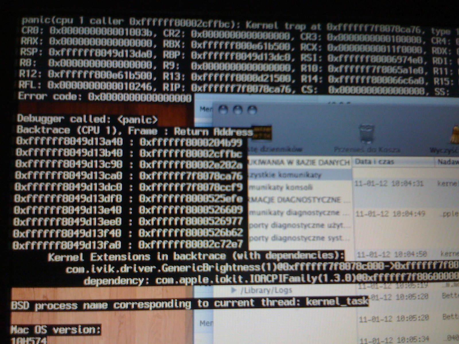

After 5 second after manually loading I got KP.
Driver loaded correctly, I thing:

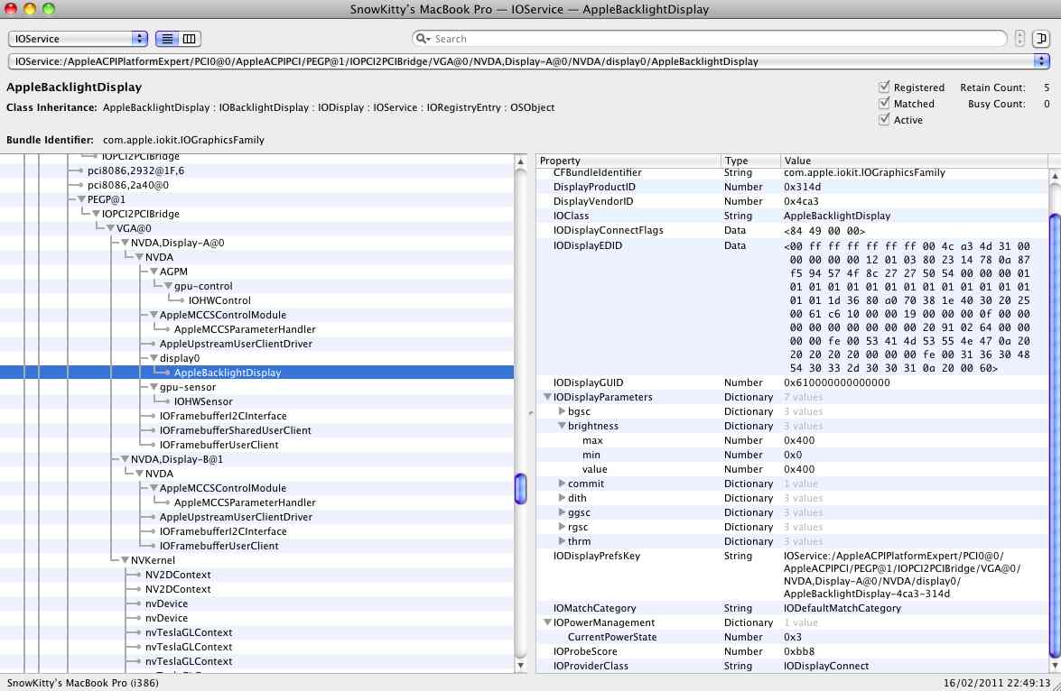

I posted some links in this topic where apple hardware store brightness levels for nvidia, but i can't test them since i don't have hardware. I know for intel graphics and i can set brightness slider on boot with just dsdt hack, reading EC value for brightness and then changing that memory on ec init.
Driver only reads ioreg value and then sets that to real brightness. I don't change ioreg value. Apple reads this from somewhere, depending on graphics card.

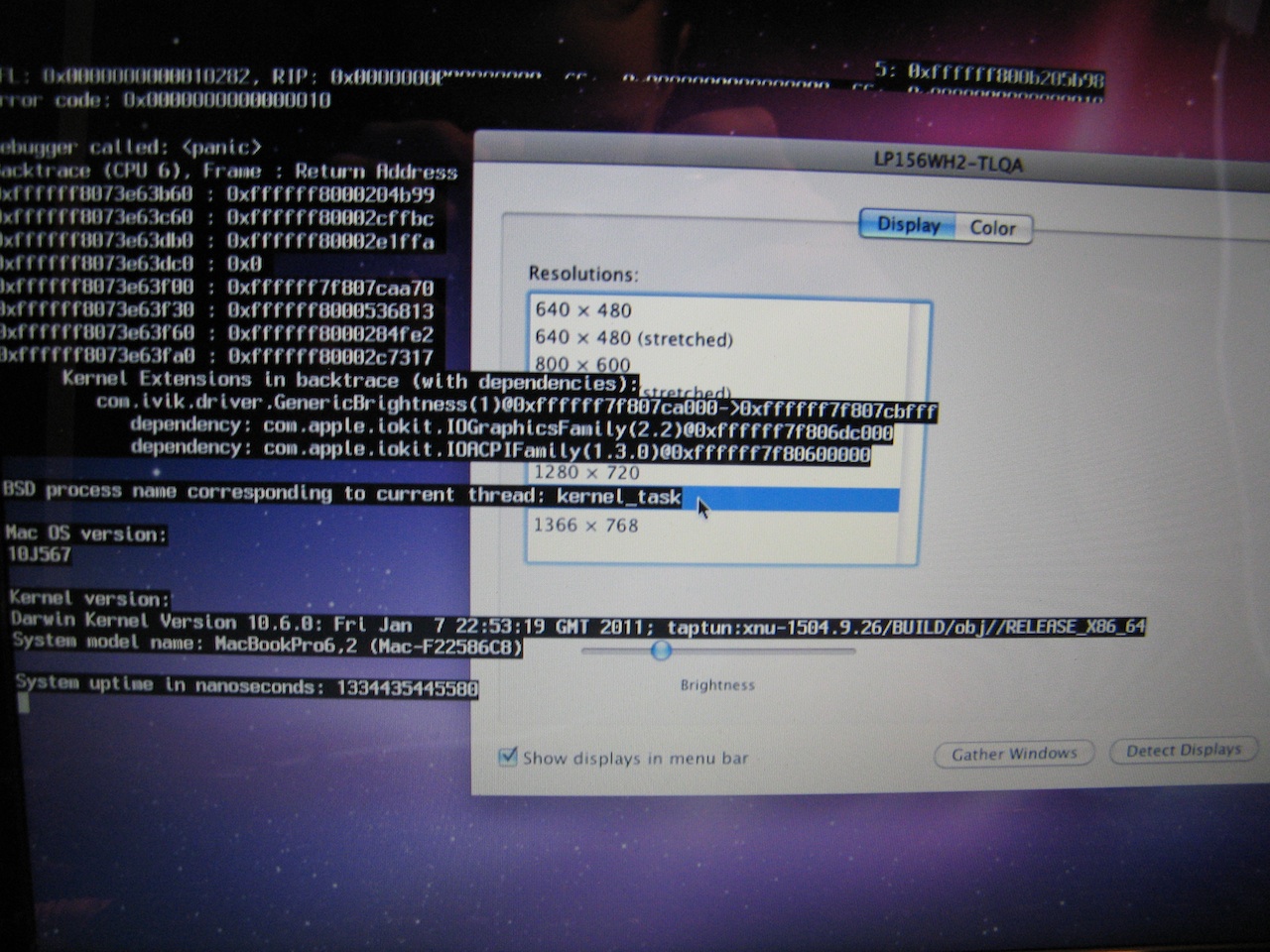

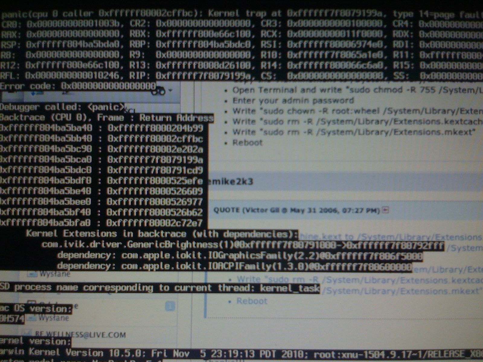

UPDATE: It's actually quite ironic what had just happened. I tried changing the resolution of the display, cause somewhere on the net I found that for real macs, if they stop remembering the backlight level after reboot, the solution is to change the resolution and change it back. So I tried that, but as soon as I changed the resolution, it KP'ed.
Hi folks,
I confirm this what 'NIXin' wrote about KP after resolution change
Ivik any chance you could fix this in your kext ?
Thanks

I followed a similar approach and get the brightness kext, slider loaded. FN+Pg up, and FN+Insert are assigned to the brightness control. I have sun appear while changing the brightness.
40 0 0x566e2000 0x4000 0x3000 com.apple.driver.AppleBacklight (170.0.34) <39 21 14 5 4 3>
This is the DSDT code I used. I took the values from MacbookPro5,1, which has a 9600M GT. EDID and a few other things are different from the original one.

But it seems that i have problem with brightness values. See below.

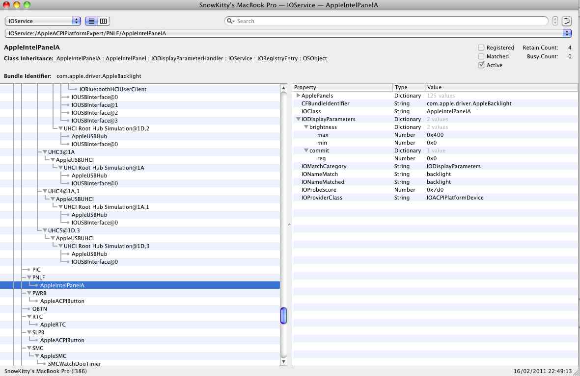

And this the PNLF device.
Finally, this is my DSDT file.
http://www.mediafire.com/?82n4x89yovpodcs
This is the ioreg dump.
http://www.mediafire.com/?y433p96w52gb3c4
It seems that i am on the right path but there is something missing. I also tried different combination e.i GraphicsEnabler, EFI string etc. Same result.
Any ideas?
Edit: When I change the brightness and update the ioreg afterwards, I can see the brightness values changing but actual LCD brightness doesn't change.
Edit 2: Please see the post below as I have it working now.
