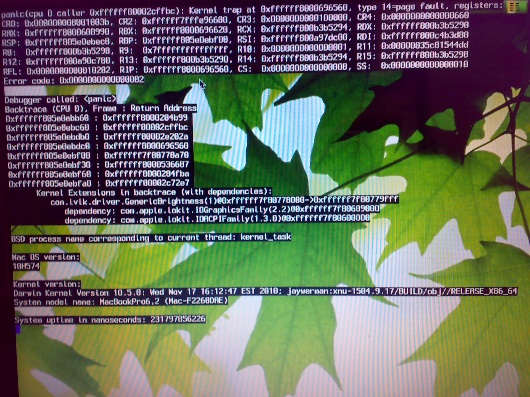

forch Posted January 10, 2011 Share Posted January 10, 2011 So, the GB.kext (82kb, from GenericBrightness.zip) which needs PNLF KP's when con./disc. HDMI. Kernel panic dependency backtrace is the same as in Mammoth KP screenshot. The one with the AppletSlider (GB.kext is 86kb in NoSlider.zip) does not KP when con./disc, though brightness controls only possible with AppletSlider, keys and Display slider don't work (as expected I guess). ioreg values are set, but brightness property does not change value when using AppletSlider (guess also as expected). Also boot time with both GB.kext's is between 6 and 10 seconds more, normal boot time is about 2/3 seconds starting from apple logo appearing (SSD). -- not using any brightness methods in PNLF -- the AppletSlider in NoSlider.zip is not a blend overlay right? It but does actually interact with the LCD? Anything else I can do or check? Cheers Link to comment https://www.insanelymac.com/forum/topic/236835-updated-2012-genericbrightnesskext/page/20/#findComment-1619336 Share on other sites More sharing options...

forch Posted January 10, 2011 Share Posted January 10, 2011 Messages in console.app (kernel.log) and dmesg are only updated when brightness is changed (slider or battery power). It doesn't panic? It does panic, but it doesn't log anything concerning the panic, when changing brightness I get these bytewise values brightnessmin 0, brightnessmax 1024, currentbrightness 0 brightnessmin 0, brightnessmax 1024, currentbrightness 64 brightnessmin 0, brightnessmax 1024, currentbrightness 128 brightnessmin 0, brightnessmax 1024, currentbrightness 192 brightnessmin 0, brightnessmax 1024, currentbrightness 256 brightnessmin 0, brightnessmax 1024, currentbrightness 320 brightnessmin 0, brightnessmax 1024, currentbrightness 384 brightnessmin 0, brightnessmax 1024, currentbrightness 448 brightnessmin 0, brightnessmax 1024, currentbrightness 512 brightnessmin 0, brightnessmax 1024, currentbrightness 576 brightnessmin 0, brightnessmax 1024, currentbrightness 640 brightnessmin 0, brightnessmax 1024, currentbrightness 704 brightnessmin 0, brightnessmax 1024, currentbrightness 768 brightnessmin 0, brightnessmax 1024, currentbrightness 832 brightnessmin 0, brightnessmax 1024, currentbrightness 896 brightnessmin 0, brightnessmax 1024, currentbrightness 960 brightnessmin 0, brightnessmax 1024, currentbrightness 1024 Is that what you need? Link to comment https://www.insanelymac.com/forum/topic/236835-updated-2012-genericbrightnesskext/page/20/#findComment-1619637 Share on other sites More sharing options...
ivik Posted January 10, 2011 Author Share Posted January 10, 2011 So problem comes from reading ioreg when pluging/unpluging hdmi. If you could see what happens to those values when system panics... It looks like something is lost during this event. (backlight service?) Does this panic also happens on login window? Try connecting hdmi on login window. Link to comment https://www.insanelymac.com/forum/topic/236835-updated-2012-genericbrightnesskext/page/20/#findComment-1619645 Share on other sites More sharing options...

forch Posted January 10, 2011 Share Posted January 10, 2011 hi guys,I have no brithness controll in my dell running 10.6.5 this is my DSDTdsdt.aml.zip can somebody help me?ty Login in window funny enough has a delay of 2 or 3 seconds, after that the panic gets called. I can give you screenshots of the panic this time, don't know if it has any value to you. Link to comment https://www.insanelymac.com/forum/topic/236835-updated-2012-genericbrightnesskext/page/20/#findComment-1619677 Share on other sites More sharing options...
ivik Posted January 10, 2011 Author Share Posted January 10, 2011 Please do some research. Watch ioreg when pluging/unpluging. To see what actually changes. Something gets lost. You have sound with hdmi? Link to comment https://www.insanelymac.com/forum/topic/236835-updated-2012-genericbrightnesskext/page/20/#findComment-1619688 Share on other sites More sharing options...
forch Posted January 10, 2011 Share Posted January 10, 2011 Don't get me wrong, I am doing research, if this would be a linux machine, I would attach a separate distro to it, put this kernel in debug mode, attach kernels and catch everything there is to debug, but it's not linux and I'm damn unfamiliar with this whole OSX stuff and this flipp'in kernel .. I could't even get OSX in debug mode to start with, would lock up every-time, but that's a different story .. There is no output, no change in ioreg, nothing. System just freezes and hits panic, 7 out of 10 times the internal display gets scrambled, the HDMI is connected to a plain external 23" LCD monitor, I'm not able to test sound, also I have to reconfigure pins in VoodooHDA to get the HDMI digital outs, which fail at the moment. I'll be glad to hear any suggestions to see changes in the ioreg before the panic hits without scrambling my screen But I guess this is a dead-end, and don't get me wrong, your situation trying to solve this is the worst and I can only say thumbs up for the time you put into this and keeping the thread so active . Link to comment https://www.insanelymac.com/forum/topic/236835-updated-2012-genericbrightnesskext/page/20/#findComment-1619730 Share on other sites More sharing options...
