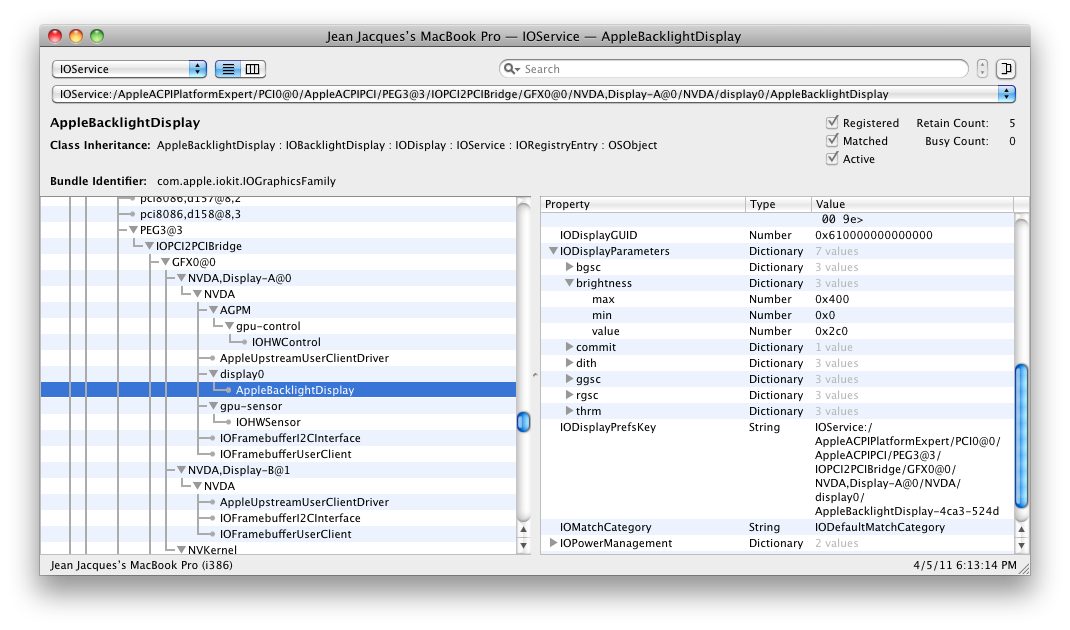

Edit: When I change the brightness and update the ioreg afterwards, I can see the brightness values changing but actual LCD brightness doesn't change.

For those who have apple brightness slider working (max backlight>0 in ioreg) can use GenericBrightness.kext.zip. There is also VoodooPS2Controller with mapped keys for brightness for hp, acer, dell, samsung and lg.
To make native slider work, you need to add PNLF device:

After that you need to find where _BCM, _BCQ and _BCL methods are and what graphics you use, since a lot of dsdt had multiple methods, because there is support for multiple cards in bios.
If your graphics is (for example) GFX0 (search it from ioreg), then you should find that device in dsdt. Under that device, there are other devices (usually LCD, CRT, TV...). Look for the device that has those methods (_BCM, _BCQ and _BCL) and then put Name (_HID, EisaId ("LCD1234")).

Big thank you for your method. I'm closer to getting brightness fully working.
I have an Asus M60J notebook Core i7 720QM with nvidia GT 240M. I'm using MacBookPro6,1 as the identifier.
I'm using Scorpy22's MacBookPro6,1 device properties string to which I made a few customizations. (Thanks Scorpy22 for that discovery)
- I corrected the Display device ACPI path to mine PciRoot(0x0)/Pci(0x3,0x0)/Pci(0x0,0x0)
-Removed EDID and NVMT injection (those are screen specific I believe)
-Removed the whole ACPI path section PciRoot(0x0)/Pci(0x2,0x0) (that's for integrated graphics processor which I don't have)
-Removed AAPL01, blackscreen-preferences (According to Krazubu, that's for an internal secondary display which I don't have)
-Corrected the NVCAP to mine
-Changed @1,connector-type to 0x00000800 (HDMI Connector). 0x00000400 is for DisplayPort
The last ACPI device path is for the firewire device. I corrected the ACPI path to my firewire's ACPI path
Now, for the Brightness method.
I'm using the GenericBrightness kext in S/L/E. I added the PNLF device to my dsdt.
RESULTS:
-Slider works, SUN with brightness level notches appear and work. But effects are reversed. Moving to the right decreases brightness. Moving to the left increases brightness. I think there is a big clue about that in the kernel log:
kernel[0]: Acpi brightness levels:14, lowest brightness:90, highest brightness:12
How do I correct this? I have included my dsdt.
Also, is it possible to implement your GenericBrightness driver in dsdt alone? Using your GenericBrightness kext gives me a kernel panic anytime I plug or unplug the hdmi connector. When not using your kext, slider and SUN brightness level notches work but no effect on brightness.
SIDENOTE: using the MacBookPro6,1 device properties string has the added unexpected benefit of giving me some speedstep with the GT 240M. Before, my GT 240M was always operating on high speed. The resting temperature was 78 Celsius doing nothing just outputting the desktop to my 21 inch 1080p monitor. Now, the resting temperature is 68 Celsius. A full 10 degrees cooler. The notebook fan speed is much quieter too for running at a lower speed. When using Geekbench I still get 5600+, so it can still switch to high gear when needed and lower gear when doing nothing (some degree of speedstep). But I don't have GPULimit 0x0 in IORegRegistryExplorer.
Thanks again to you and Scorpy22 for getting me closer to fully working brightness.
dsdt.aml.zip
