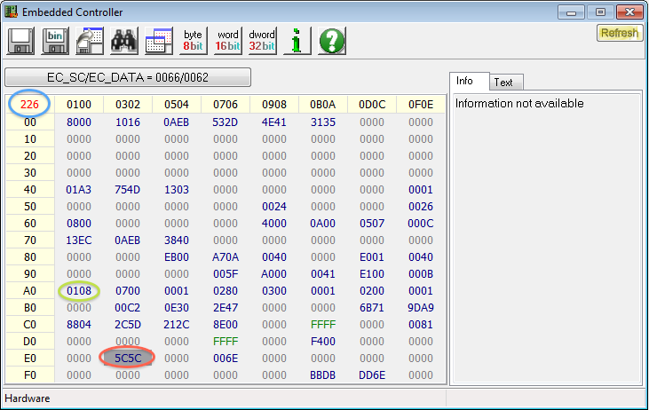

I've found out with RW-Everything that the EC register for changing the backlight in my laptop (HP DV6t) is:
						DLYT,   8,
							Offset (0xE2),
					BRTL,   8,
							Offset (0xE6),
DLYT is for storing the value of the backlight, going in 100 steps from 0x00 to 0x63.
BRTL is read-only for reading the current backlight value.
How does this help me?
Thanks.

Do you have moving slider?

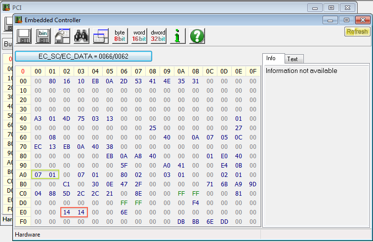

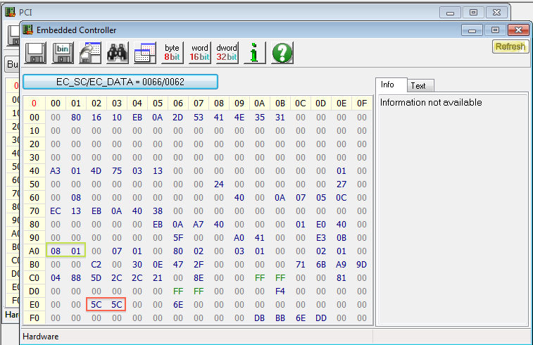

Check in rw-everything if this is register for brightness and try writing to it. If brightness changes (when you write to it), there is hope for you.
am total noob when it's related to rw-everything; btw, I 've got those screenshots and some the values changing in parallel when I change brightness:
brightness up & down respectively seem to be the ones in green: 0801 & 0701
brightness values seem to be the ones in red
I just installed windows to get those values. If you need anything else, please let me know.
Thanks.
E2 register is BRTL. Did you try writing to it?
Write down value for every brightness levels.
sorry but am lost here. And yes tried to follow post 50 and your suggestions for swavek, but I don't even know how to:
then I corrected offset to what you did suggest for nvidia, but still, same thing: nothing shown
please help

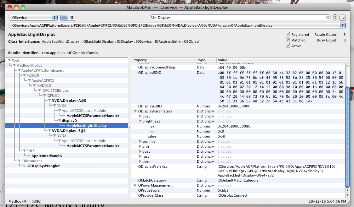

I added PNLF into our DSDT and modified GraphicsEnabler to inject the pwm etc into the DSDT.
Here are what I observed during my test:
- Without the pwm injection the slider doesn't stay (always return to max)
- With pwm injection the slider stays, the value on ioreg changed too, but there was no effect on the brightness.
- Using Fn+Brightness Up/Down, I am able to adjust the brightness, only there are no On Screen Display (the sun) indicator. This has been working without PNLF and/or pwm. Also this doesn't move the slider.
One strange thing is, the max brightness value in ioregexplorer was very large.

PNLF loads backlight drivers and gives you slider.
For nvidia, there must be some other info injected (PWM...), from where max brightness is read.
Some notebooks have brightness controll with nvidia graphics. Apple also. https://gist.github.com/raw/451904/ecdf2c40...bf8/nvidia_bl.c
This is why some dells, samsung, LG have native brightness. (confirmed on this topic)
I think that your laptop controlls it with EC0.BRTL.
Hm.. that is some big max brightness. Usually is 0x400 for nvidia. Do values from ioreg lineary change when you move slider? (from 0 to max?)

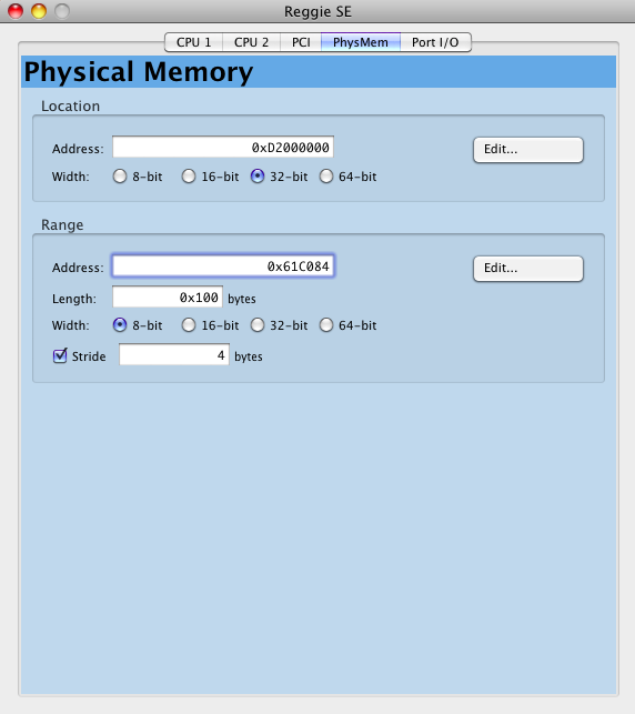

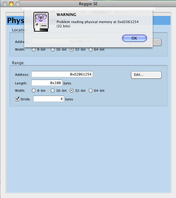

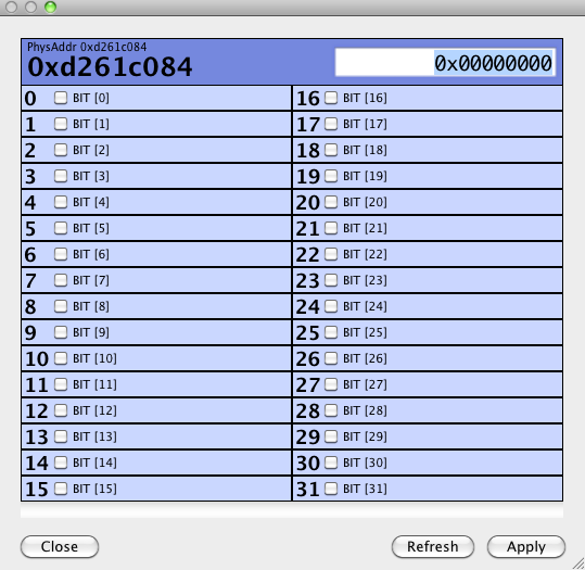

I 've finally ended up understanding how to go with reggie_se.
ps: I have 9600m GT so I should add 61c084 to bar0 (0xD2000000) to get 0xD261C084
but using your kext from the All.zip no value does change (into reggie_se) with brightness (menu-let):
Also, regarding all the values of brightness, (I got them from rw-everything) from lowest to highest:
14 14, 19 19, 1f 1f, 24 24, 29 29, 2e 2e, 34 34, 3d 3d, 48 48, 55 55, 5c 5c
can you do something with it?
