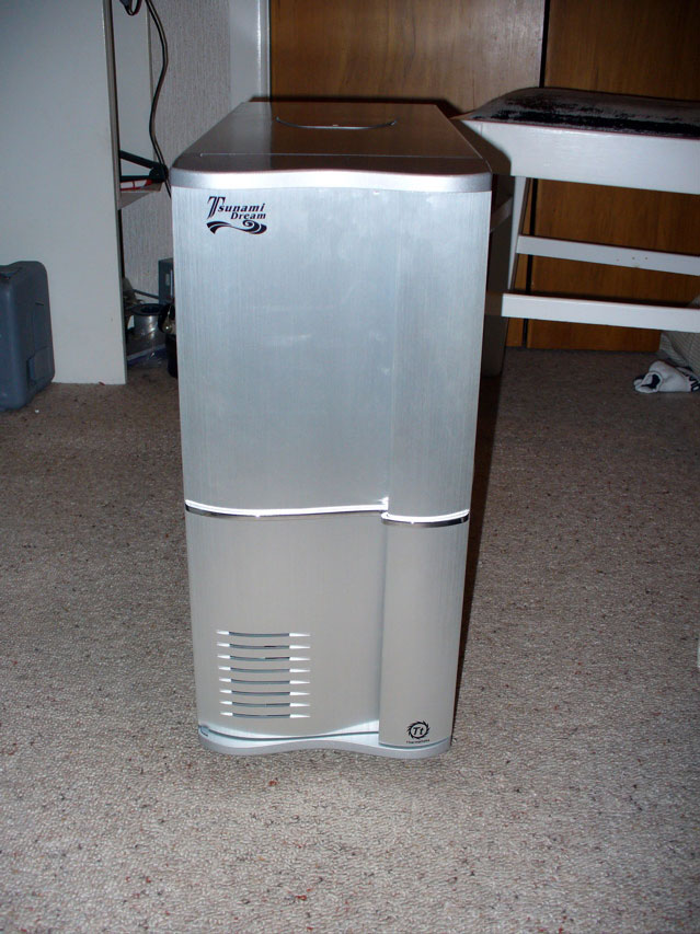

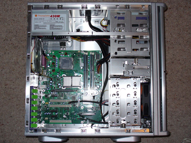

sbeehre Posted August 9, 2006 Share Posted August 9, 2006 started building my Conroe box today So far it consists of:- A Thermaltake Swing Aluminum Case Intel DP965LT Motherboard (im prepared to wait for support with this) 2GB 667 Cosair RAM Pioneer DVR111D DVD Writer Im waiting on my 2.13GHZ Conroe to turn up along with my 200GB Hard Drive and my ATI Radion x1600 pro Link to comment https://www.insanelymac.com/forum/topic/23246-core2duo-conroe-chipsets-and-chipsets-for-osx86/page/6/#findComment-159521 Share on other sites More sharing options...

RiceTea Posted August 9, 2006 Share Posted August 9, 2006 A Thermaltake Swing Aluminum CaseIntel DP965LT Motherboard (im prepared to wait for support with this) 2GB 667 Cosair RAM Pioneer DVR111D DVD Writer Im waiting on my 2.13GHZ Conroe to turn up along with my 200GB Hard Drive and my ATI Radion x1600 pro Hope that an OSX86 solution will be found for the 965 chipset. Concerning your choice of graphics card, the situation seems quite confusing to me for X1600XT cards (DVI out working or not etc., etc.). Are lower spec X1600 Pro cards a better choice especially for the DVI issue? Link to comment https://www.insanelymac.com/forum/topic/23246-core2duo-conroe-chipsets-and-chipsets-for-osx86/page/6/#findComment-159570 Share on other sites More sharing options...

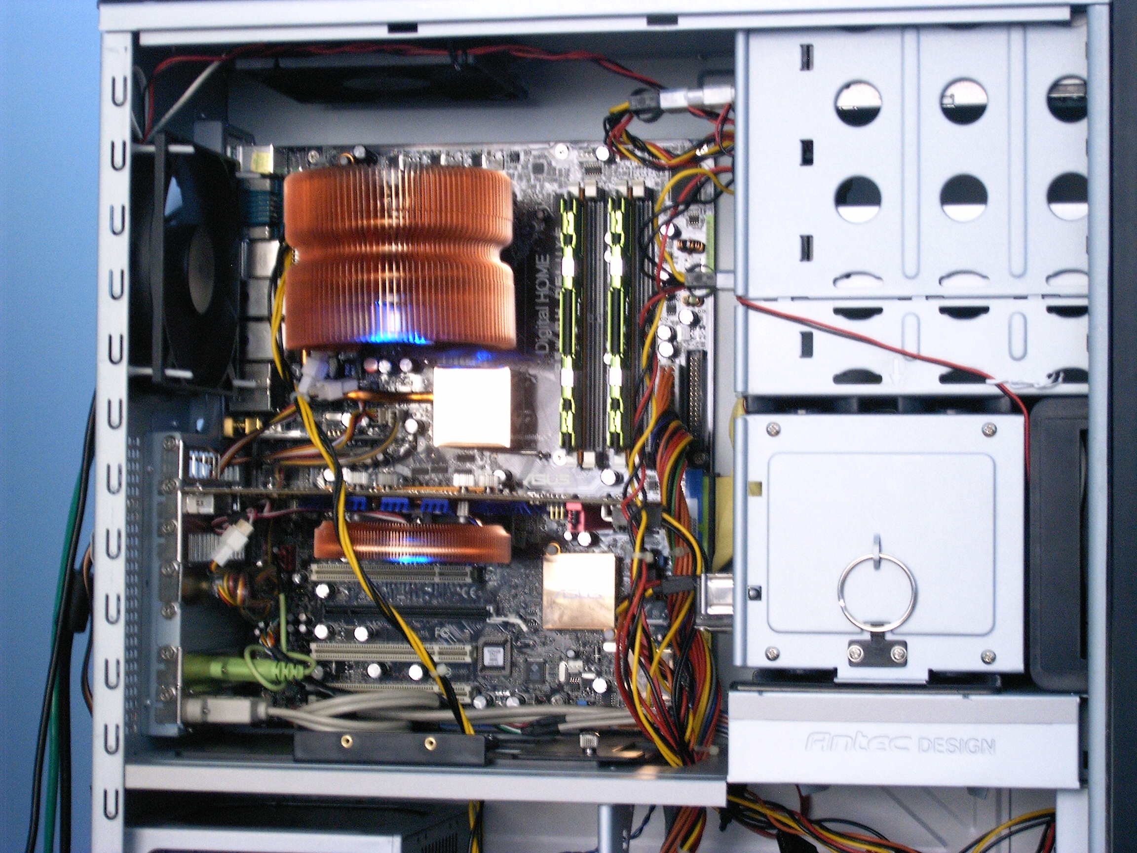

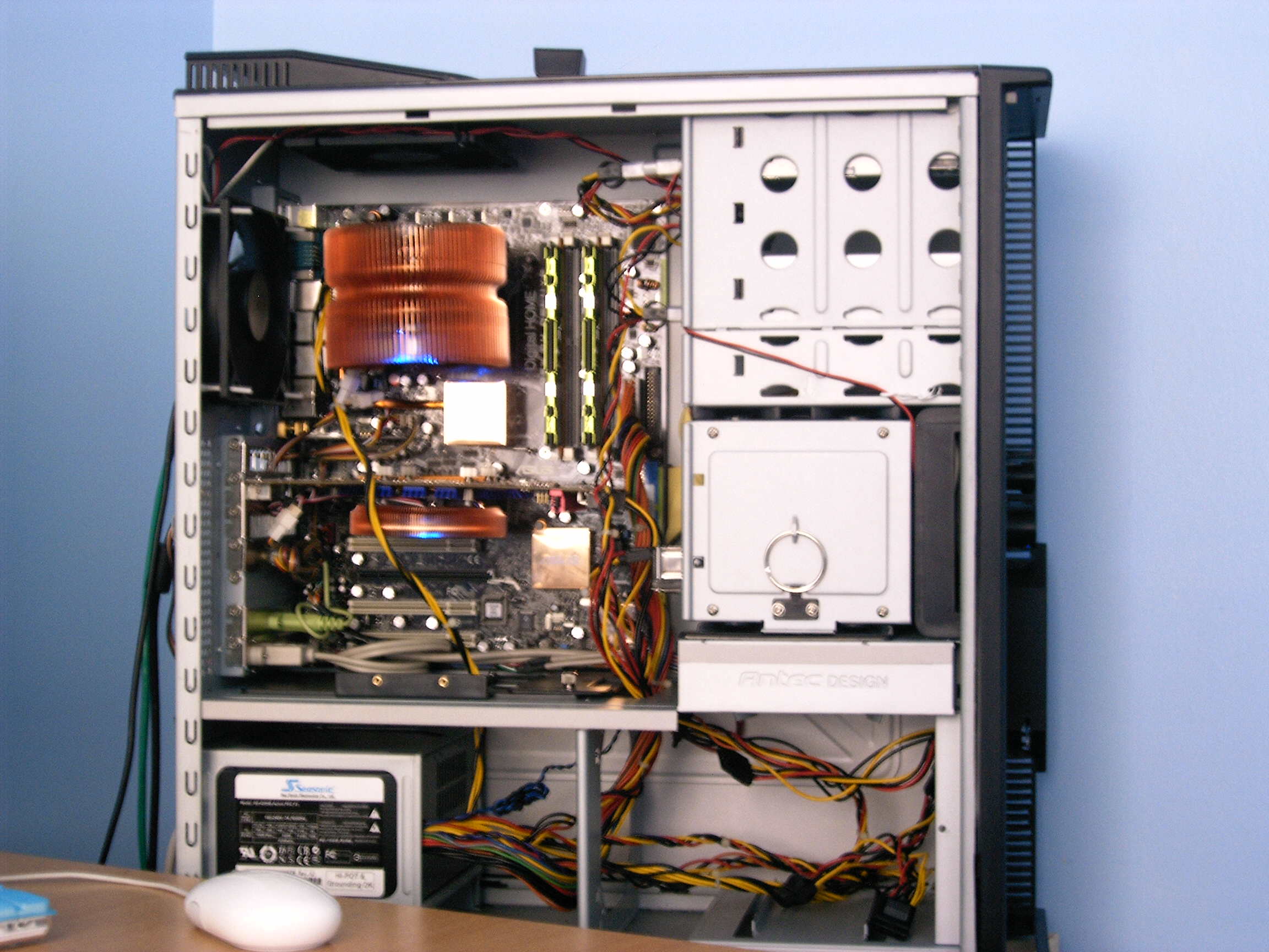

Graeme43 Posted August 9, 2006 Share Posted August 9, 2006 here's my rig Link to comment https://www.insanelymac.com/forum/topic/23246-core2duo-conroe-chipsets-and-chipsets-for-osx86/page/6/#findComment-159706 Share on other sites More sharing options...
stainboy Posted August 9, 2006 Share Posted August 9, 2006 thats not a rig.... thats a RIG !!! ehehe nice job Link to comment https://www.insanelymac.com/forum/topic/23246-core2duo-conroe-chipsets-and-chipsets-for-osx86/page/6/#findComment-159728 Share on other sites More sharing options...

aberracus Posted August 9, 2006 Share Posted August 9, 2006 here's my rig it looks like my rig, but your zalman cpu cooler should blow to the exhaust fan of the back of our case.... donicci, that mainboard uses VIA chipset controler The VT8237A , i dont know if its compatible with the thigs we have byes Link to comment https://www.insanelymac.com/forum/topic/23246-core2duo-conroe-chipsets-and-chipsets-for-osx86/page/6/#findComment-159897 Share on other sites More sharing options...
Graeme43 Posted August 9, 2006 Share Posted August 9, 2006 I was wondering which way to point the fan, I'm gonna change it thanks It probably won't make any difference seeing as its 22C for the CPU temp might help mobo tho Link to comment https://www.insanelymac.com/forum/topic/23246-core2duo-conroe-chipsets-and-chipsets-for-osx86/page/6/#findComment-159899 Share on other sites More sharing options...
