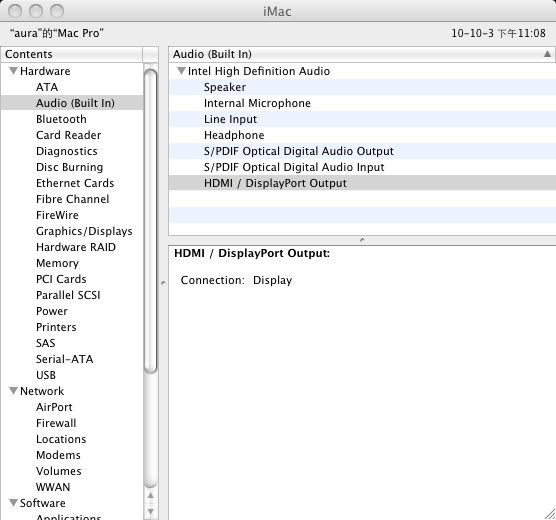

aura Posted October 3, 2010 Share Posted October 3, 2010 I bought Sapphire vapor-x HD 5770 1GB and tested it with OS X 10.6.4 today. I tried to find this Sapphire HD 5770 but it's not available at local stores. So, I got vapor-x one. PN 288-1E147-301SA, SKU# 11163-05-41R. I saw a new version of vapor-x HD 5770, its PCB is different from the one I got. I have no idea whether native HDMI audio is working on such OS X 10.6.4 or not. So, I listed PN and SKU#. I got native HDMI working as extended monitor and got HDMI audio thru native HDMI port. Connecting ATI DVI2HDMI adaptor to both DVI ports had no HDMI audio. I also tested my new vapor-x one under Windows 7. Connecting ATI DVI2ATI adaptor to DVI ports got no HDMI audio device. Connecting to native HDMI and DisplayPort via DP2miniDP cable plus miniDP2HDMI got HDMI audio device. Finally, I think it is about how to design graphic cards. P.S. At startup, fan speed's full for a few minutes after that it went to normal. I will try to use 1002_68b8.rom later. In contrast, I tested Gigabyte HD 5770 (batman) (sold) and I got native HDMI working as mirror and got no audio thru HDMI (but under Windows 7 got sound thru every port). Added to DSDT, got to do it yourself. Device (PEGP) { Name (_ADR, 0x00010000) <------ it depends on each mother board. Name (_PRW, Package (0x02) { 0x09, 0x05 }) Device (GFX0) { Name (_ADR, Zero) Method (_DSM, 4, NotSerialized) { Store (Package (0x02) { "hda-gfx", Buffer (0x0A) { "onboard-1" } }, Local0) DTGP (Arg0, Arg1, Arg2, Arg3, RefOf (Local0)) Return (Local0) } } Device (HDAU) { Name (_ADR, One) Method (_DSM, 4, NotSerialized) { Store (Package (0x02) { "hda-gfx", Buffer (0x0A) { "onboard-1" } }, Local0) DTGP (Arg0, Arg1, Arg2, Arg3, RefOf (Local0)) Return (Local0) } } } Got sound assertions, I will try to find out when I have a time. Aug 29 19:45:07 Mac-Pro kernel[0]: Sound assertion "( cyclicBufMemoryDescriptor->getCapacity() * 2 ) > mDspFuncManager->getBufferSizeForFuncs()" failed in "/SourceCache/AppleHDA/AppleHDA-187.4.1/AppleHDA/AppleHDAEngine.cpp" at line 2374 goto Exit Edited: using AppleHDA.kext version 1.8.9f1, this error's gone. ........ Got these after using DVD Player Aug 29 19:46:25 Mac-Pro kernel[0]: Sound assertion "0 != result" failed in "/SourceCache/AppleHDA/AppleHDA-187.4.1/AppleHDA/AppleHDAWidget.cpp" at line 3891 goto handler Aug 29 19:46:55: --- last message repeated 2 times --- Aug 29 19:46:55 Mac-Pro kernel[0]: Sound assertion "0 != result" failed in "/SourceCache/AppleHDA/AppleHDA-187.4.1/AppleHDA/AppleHDAWidget.cpp" at line 3891 goto handler Aug 29 19:47:30: --- last message repeated 1 time --- Edited: still got sound assertion after opening DVDPlayer. It is possible to be software issue. Aug 31 23:20:42 Mac-Pro kernel[0]: Sound assertion "0 != result" failed in "/SourceCache/AppleHDA/AppleHDA-189.4.1/AppleHDA/AppleHDAWidget.cpp" at line 3891 goto handler Edited: P.S. I think why some could not get HD 5770 working properly while they're using "boot" to run at 64 bit because graphic card bus address's not 0x00010000. So, they got to add 1002_68b8.rom into /Extra since boot could not get bin image from such 0x0003000 even though there is DSDT.aml in /Extra, for example. Need talent people, like trauma! and netkas to fix this problem. hi~could you help me???thanks!!! my card is ATI HD 5770, flashed Sapphire.HD5770.1024.100119.bin my bootloader is Chameleon RC5 rev516 download in http://www.insanelymac.com/forum/index.php?showtopic=231756 my macosx is 10.6.5 10h542 my dsdt.aml is dsdt.aml.zip my com.apple.boot.plist is <?xml version="1.0" encoding="UTF-8"?> <!DOCTYPE plist PUBLIC "-//Apple//DTD PLIST 1.0//EN" "http://www.apple.com/DTDs/PropertyList-1.0.dtd"> <plist version="1.0"> <dict> <key>Default Partition</key> <string>hd(0,1)</string> <key>GraphicsEnabler</key> <string>yes</string> <key>Kernel</key> <string>mach_kernel</string> <key>Kernel Flags</key> <string></string> <key>PCIRootUID</key> <string>1</string> <key>Theme</key> <string>Blackosx_Big_Screen_Theme (2 devices)</string> <key>UseAtiROM</key> <string>yes</string> </dict> </plist> Using PCI-Root-UID value: 1 ATI VGA Controller [1002:68b8] :: PciRoot(0x1)/Pci(0x3,0x0)/Pci(0x0,0x0) 3rd display was OK! but my ATI5770 hdmi SOUND is no run。。。 add your DSDT code still so....my _ADR 0x00010000??? why your without 1002_68b8.rom? help me!!!!!!!!thank you very mach!!!!!! uppci.tiff up5770.tiff upmidi.tiff myIORegistryExplorer Mac_Pro.zip Link to comment https://www.insanelymac.com/forum/topic/205802-ati-hd-5770/page/35/#findComment-1558440 Share on other sites More sharing options...

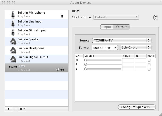

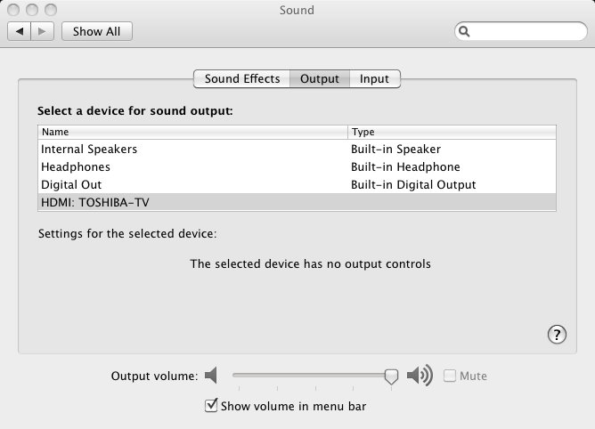

FKA Posted October 11, 2010 Share Posted October 11, 2010 as me Hi Mo' Currently messing around with an asus motherboard that has the same VT1708S audio chipset you have. If I use your latest patched voodooHDA I get all outputs listed as you do but when I select HDMI audio I get nothing, audio wise, from the LCD TV. Is working fine (HDMI audio ONLY) with ApplehDA and hda DSDT edit, without voodooHDA, but I'd like to be able to use my analogue outputs too! Can you confirm that you have the HDMI audio output listed, you have tested and it actually works for you? Are you using any hda DSDT edit? Rgds D Link to comment https://www.insanelymac.com/forum/topic/205802-ati-hd-5770/page/35/#findComment-1562933 Share on other sites More sharing options...

FKA Posted October 12, 2010 Share Posted October 12, 2010 @fka: Should be possible to run AppleHDA and VoodooHDA at same time. Try to only provide HDAU code in the DSDT, and just rename your HDA codec as HDEF in DSDT. Do not use any DSM injection under the HDEF device, and AppleHDA should leave this codec alone and only handle HDAU.On the other side, disable HDMI within VoodooHDA.... I think it should work! Bye. Thanks - will give it a go D Link to comment https://www.insanelymac.com/forum/topic/205802-ati-hd-5770/page/35/#findComment-1563462 Share on other sites More sharing options...
Mohamed Khairy Posted October 12, 2010 Share Posted October 12, 2010 Hi Mo' Currently messing around with an asus motherboard that has the same VT1708S audio chipset you have. If I use your latest patched voodooHDA I get all outputs listed as you do but when I select HDMI audio I get nothing, audio wise, from the LCD TV. Is working fine (HDMI audio ONLY) with ApplehDA and hda DSDT edit, without voodooHDA, but I'd like to be able to use my analogue outputs too! Can you confirm that you have the HDMI audio output listed, you have tested and it actually works for you? Are you using any hda DSDT edit? Rgds D HDMi nearly doenot work with voodooHDA you can use my kext on sound section for analog and try to patch appleHDA TO make HDMI of card to work anther thing hdmi on voodoohda.kext i did is for via chipset not for ATI HD5770 codec so it must not work you can patch voodoohda.kext to add ati codec also but not sure if it will work or not if you want voodooHDA.kext with two cards pinconfiged tell me Link to comment https://www.insanelymac.com/forum/topic/205802-ati-hd-5770/page/35/#findComment-1563488 Share on other sites More sharing options...
jsl Posted October 13, 2010 Share Posted October 13, 2010 I am using Mohamed Khairy's solution with 5770 ROM from http://www.insanelymac.com/forum/index.php?showtopic=231756 MSI Hawk has three ports one DVI one HDMI and one Display Port. As of now only DVI port is working for me. HDMI is not working. HDMI-Audio is also not working. I was wondering if anybody has developed generic kext for HDMI audio in ATI 5770 card. I have used Kabyl's boot which made my MSI Hawk 5770 working in 10.6.4 with Vervet. I can get HDMI working, but it always display the same as DVI port and System Profile just shows one is working even both DVI and HDMI showing the same display. It's a pity HDMI-Audio is not working yet either for me. Link to comment https://www.insanelymac.com/forum/topic/205802-ati-hd-5770/page/35/#findComment-1563730 Share on other sites More sharing options...
FKA Posted October 13, 2010 Share Posted October 13, 2010 HDMi nearly doenot work with voodooHDA you can use my kext on sound section for analog and try to patch appleHDA TO make HDMI of card to work anther thing hdmi on voodoohda.kext i did is for via chipset not for ATI HD5770 codec so it must not work you can patch voodoohda.kext to add ati codec also but not sure if it will work or not if you want voodooHDA.kext with two cards pinconfiged tell me got to be honest Mohamed, with your pin config added to voodooHDA I can not get the kext to load at boot (kextload post boot works but no sound.) we must have different pinconf ?? Standard VHDA 2.7.2 without ATI device id added gives KP with HDAU device in DSDT. RE Trauma's suggestion.... No AppleHDA HDMI audio unless I have in DSDT: Device (GFX0) { Name (_ADR, Zero) Method (_DSM, 4, NotSerialized) { Store (Package (0x02) { "hda-gfx", Buffer (0x0A) { "onboard-1" } }, Local0) DTGP (Arg0, Arg1, Arg2, Arg3, RefOf (Local0)) Return (Local0) } } Device (HDAU) { Name (_ADR, One) Method (_DSM, 4, NotSerialized) { Store (Package (0x02) { "hda-gfx", Buffer (0x0A) { "onboard-1" } }, Local0) DTGP (Arg0, Arg1, Arg2, Arg3, RefOf (Local0)) Return (Local0) } } } Although I can change HDAU to HDEF with no problems. Simply having: Device (HDAU) \ or Device (HDEF) { Name (_ADR, One) Method (_DSM, 4, NotSerialized) { Store (Package (0x02) { "hda-gfx", Buffer (0x0A) { "onboard-1" } }, Local0) DTGP (Arg0, Arg1, Arg2, Arg3, RefOf (Local0)) Return (Local0) } } } Gives nothing. Not sure if simply disabling the HDAU node in voodooHDA info.plist will allow VHDA to load - going to try adding ATI HDAU device id to info.plist and then disable node. Work-in-progress - any other suggestions welcomed ! D I had the exact same problem once with my 5770. It was caused by the BIOS option "Repost Video on S3 Resume". I had to disable that (set to no) for the video to come back properly after awakening. (Look at this screenshot from the Asus P6T guide) Hay roelroel! I was also getting digital break-up and reduced video size on wake from sleep with my Asus MB and this 'fix' works - Many thanks! However this didn't work with my MSI board that posted NO video at all on wake from sleep. D Link to comment https://www.insanelymac.com/forum/topic/205802-ati-hd-5770/page/35/#findComment-1563797 Share on other sites More sharing options...
