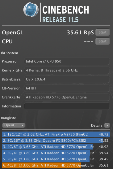

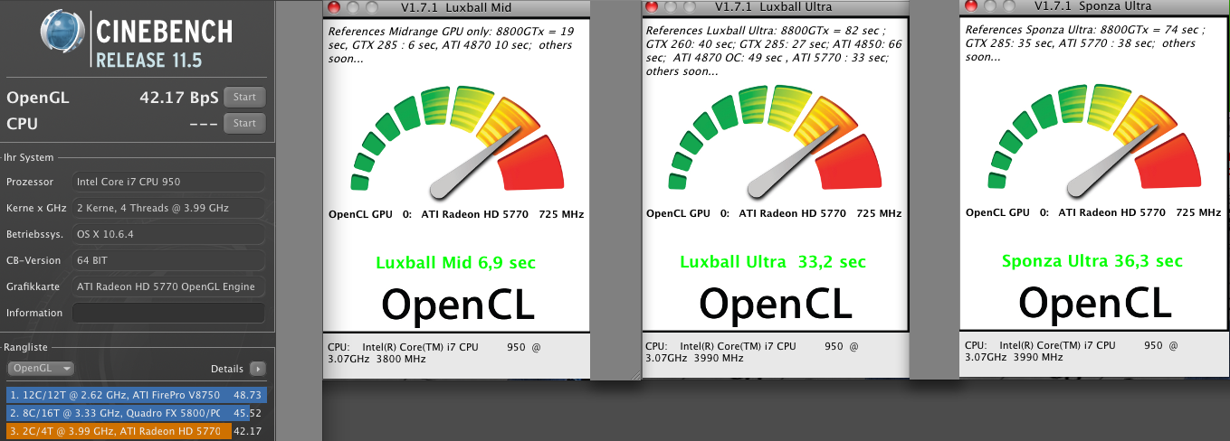

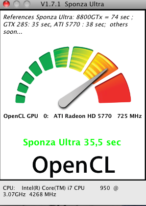

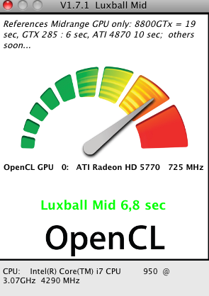

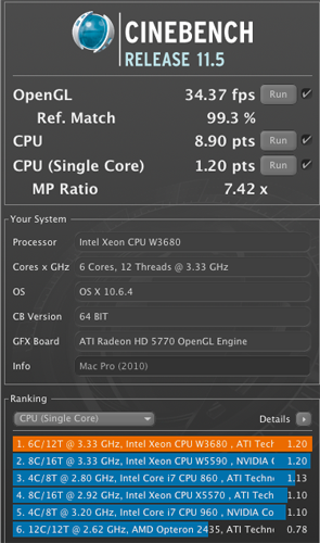

HD 5770 performance with i7 CPU @ stock (and overclocked )
As I just finished a new , fresh install of 10.6.4 I want to give HD 5770 users
an orientation , what they can expect from this card with i7 CPUs in OpenGL and OpenCL.
You will find my similar database for QuadCore 9550 CPUs here in this thread.
OpenGl performance is very important for games and pro apps (Motion,Photoshop, Aperture,Premiere etc.)
OpenCl performance will be very important in near future , right now only a few apps (i.e. Starfire) use it.
Test : i7 CPU @ stock 3.06 GHz , HT on , all Powersaving states enabled, fresh 10.6.4.
Sapphire HD 5770 (ATI reference design) , stock bios:
post-253749-1285531845_thumb.png 4 core CustomMac @3,06 post-253749-1285484191_thumb.png6 core MacPro2010 @3,33
Dont worry if your results differ one or 2 frames , these results are based on a very lean installation.
If your results differ more than 3 frames at the same CPU speed you should have a look at your configuration.
I couldn´t resist to add the results of the brandnew 2010 MacPro 6 core Westmere ,
equipped with the Apple HD 5770 @ 3,33 GHz CPU.
So you see we are happy campers in the OSX 86 scene.. :)

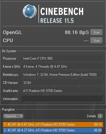

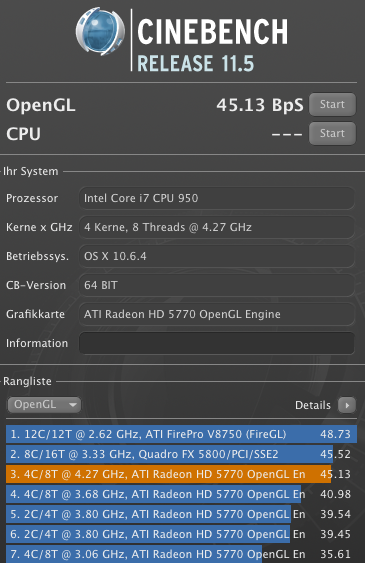

OC results :
If you have overclocked your CPU I attached my results , trying to squeeze the most out of my
rig , though this is not meant for 24/7 use .

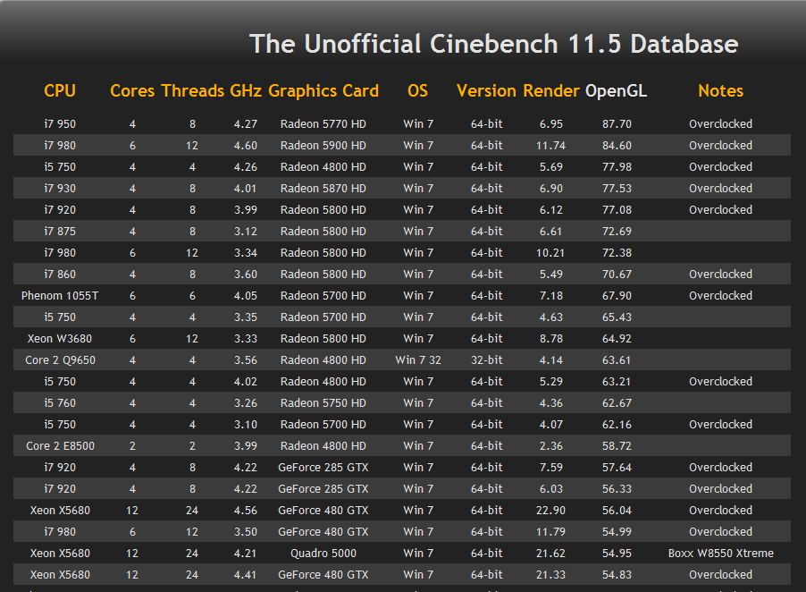

HD 5770 @stock -i7 950 CPU @ 4,2 (on air) *this CPU boots in Windows @4,52 GHz on air :-)
post-253749-1285595937_thumb.pngpost-253749-1285596430_thumb.pngpost-253749-1285596490_thumb.png
Win7 : HD 5770 OC @930/1380 : 88,16 fr.
Currently my HD 5770 scores Nr. 1 in Cinebench OpenGl on Win 7 and MacOS 10.6.4
