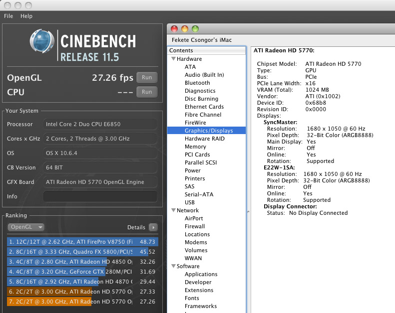

I took the screenshots with an overclocked i7 @ 4Ghz and one HD 5850 @ 900 mhz gpu clock / 1200 mhz memory clock.
ATI 58xxx and 59xxxx are amazingly fast in OpenCL even in Win 7
Though I would expect a little bit more from a 58xx card in Cinebench
I think you should easily get more than 45 fr.
Apple/ATI are far behind in their OpenGl implementation a.t.m.
I got nearly the double framerate in Win 7 in Cinebench > 73 fr.

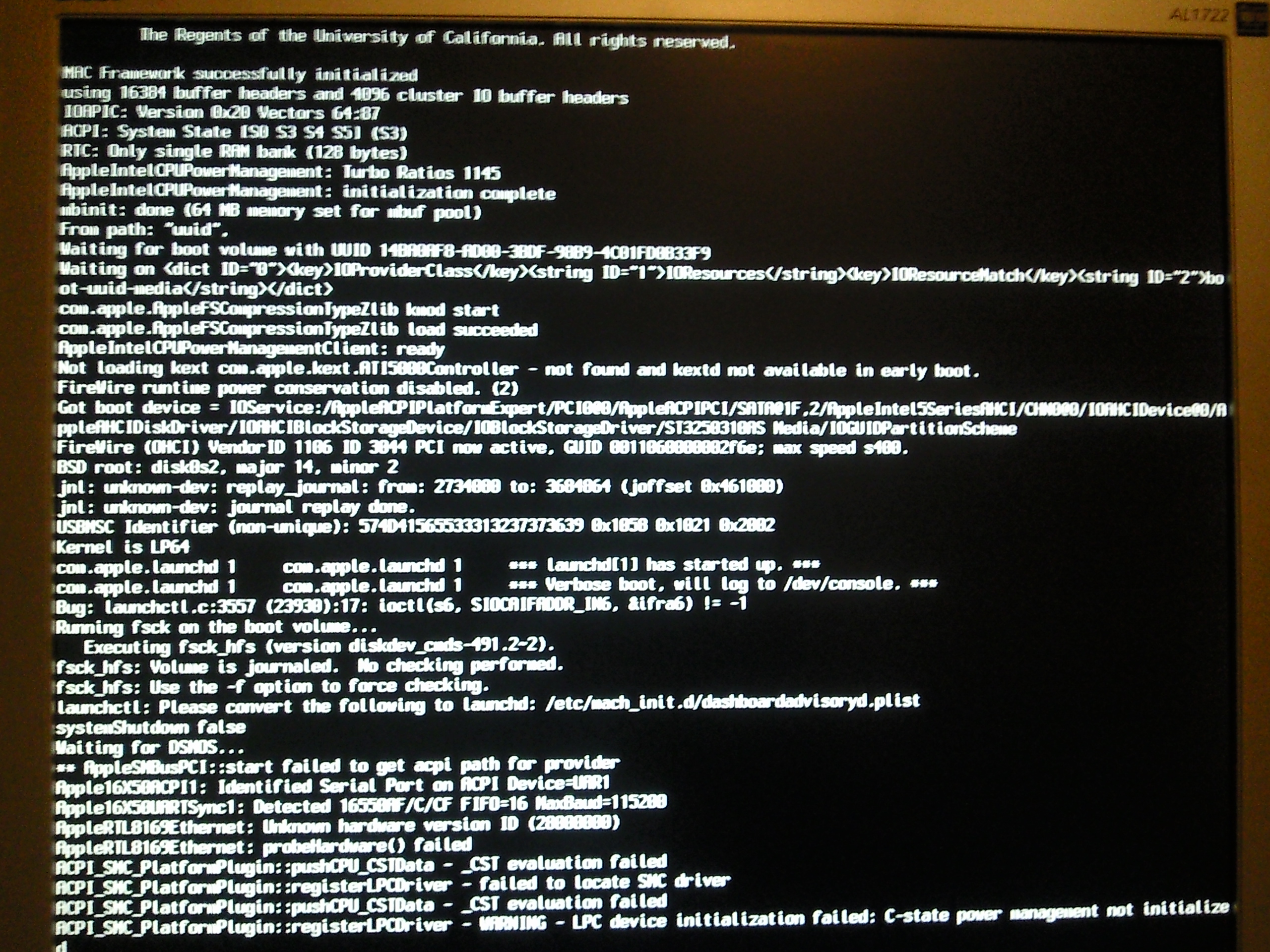

Well when I use just -v it goes too fast and my screen gets filled with all the error codes (console type error).
When I use -v -f it hangs after:
ACPI table not found: DSDT.aml
No DSDT found, using 0 as uid value.
Using PCI-Root-UID value:0
Of course I have heard a lot about DSDT but have not had to do anything with it so far.
Since I can only boot into SingleUser do I need to reinstall to do something in GUI for DSDT or is that not a problem?

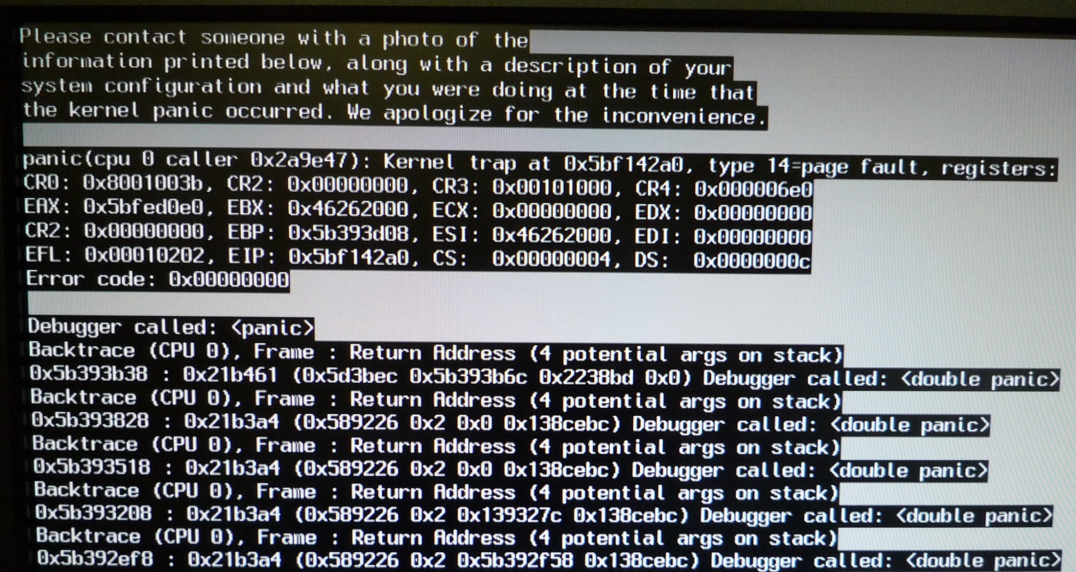

Can anyone make sense of the KP (?) in the image I've attached?
pepole have problem like black screen ,kp etc with defualt frambuffer
try anther frambuffer
here is my topic
there are 30 boot file with 30 frambuffer

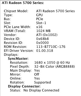

Guys! I did as described in the topic and my Vapor-X workx like a charm. The only problem is just 23fps in Cinebench 11.5 WFT? Also smallluxGPU show that card is only 725Mhz? is it a bug or Apple underclocks my card?
Also when on desktop I have secondary mouse pointer.
