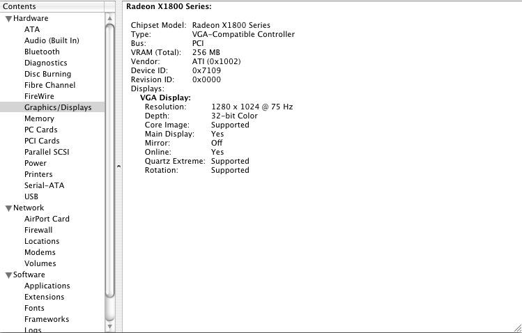

morbidangel Posted August 8, 2006 Share Posted August 8, 2006 Hi! First I have to thank you all for all the infos. I have a HIS X1800GTO (not the ICEQ3 Version) PCIe (0x710a) and everything I get is a black screen or vertical lines. Im using JAS 10.4.6 with my Pentium D 805 on a PT880 Pro/Ultra (ASROCK 775Dual-VSTA). I tried the manual method with 10.4.5, 10.4.6 and 10.4.7 Kexts everytime with every DVI,VGA Connection. Then I tried the newest Neopheus-Installer. After that I read something about BIOS-Problems and I tried some X1800GTO and X1800XL BIOS´s I was able to find. Now I dont know if there is anything left I could try ? Could someone with a working X1800GTO or X1800XL provide me with a BIOS or could there be another problem with my System ? Link to comment https://www.insanelymac.com/forum/topic/19806-howto-x1600x1800-full-support-borisbadenov-method/page/15/#findComment-158607 Share on other sites More sharing options...
BNO Posted August 8, 2006 Share Posted August 8, 2006 Hi, everybody! I'm one of the lucky guys with a Apple Cinema display and a Radeon X1800XT by PowerColor (BBA). With the AIY,Wormy set to display I get my black screen, as known because DVI. Someone claimed that ATY,Wormy is the codename at Apple for the X1600 cards and I read somewhere in this forum that the 10.4.7 kexts support ATI X1900. Concluding to that it would be interesting if the ATINDRV.kext still has only ATI,Wormy in it. Because I only got the 10.4.7 kexts supplied by the neuphase Installer 3.2 I can't check this out. I beleave that setting the IONameMatch in ATINDRV.kext to the correct Value could be the fix for our DVI problem. So I'm going to play around a bit more with ATINRV.kext and if someone cound check the IONameMatch Value of the ATINDRV.kext from 10.4.7, it would be nice. Link to comment https://www.insanelymac.com/forum/topic/19806-howto-x1600x1800-full-support-borisbadenov-method/page/15/#findComment-158635 Share on other sites More sharing options...
Superhai Posted August 8, 2006 Share Posted August 8, 2006 I beleave that setting the IONameMatch in ATINDRV.kext to the correct Value could be the fix for our DVI problem. No, unless you have a kext that creates the ATY,Wormy or other name to match on, the only actual match would be 'display'. I said sometime ago that Wormy was the name for x1600 but it seem that the term is used for the entire x1000 series. And in the 10.4.7 the Info.plist for ATINDRV remains the same. Link to comment https://www.insanelymac.com/forum/topic/19806-howto-x1600x1800-full-support-borisbadenov-method/page/15/#findComment-158668 Share on other sites More sharing options...
Ezhoon Posted August 8, 2006 Share Posted August 8, 2006 Didn't work on my x1900xtx. It kernel panics on boot. Edit: Nevermind...that installer worked. You're using d-sub connection, I presume? Can you check, if possible, if dvi works or not please? Link to comment https://www.insanelymac.com/forum/topic/19806-howto-x1600x1800-full-support-borisbadenov-method/page/15/#findComment-158798 Share on other sites More sharing options...
