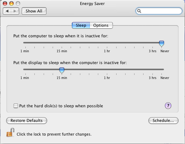

martin1976 Posted July 15, 2006 Share Posted July 15, 2006 I know this is not strictly video drivers realated but I didn't know where else to ask: My monitor will not go to "sleep". Is this the way to do it or am I missing something? : Link to comment https://www.insanelymac.com/forum/topic/19806-howto-x1600x1800-full-support-borisbadenov-method/page/10/#findComment-145067 Share on other sites More sharing options...

cyclonefr Posted July 18, 2006 Share Posted July 18, 2006 I know this is not strictly video drivers realated but I didn't know where else to ask: My monitor will not go to "sleep". Is this the way to do it or am I missing something? : cause u must use DVI2VGA Link to comment https://www.insanelymac.com/forum/topic/19806-howto-x1600x1800-full-support-borisbadenov-method/page/10/#findComment-146608 Share on other sites More sharing options...

munky Posted July 19, 2006 Author Share Posted July 19, 2006 locuras and others lacking monitor sleep: my X1800 will only allow the monitor to sleep on one of the two DVI ports. if you have an additional DVI or VGA port on your card, try booting up with that one connected to your monitor instead of the one you are currently using. Link to comment https://www.insanelymac.com/forum/topic/19806-howto-x1600x1800-full-support-borisbadenov-method/page/10/#findComment-147226 Share on other sites More sharing options...

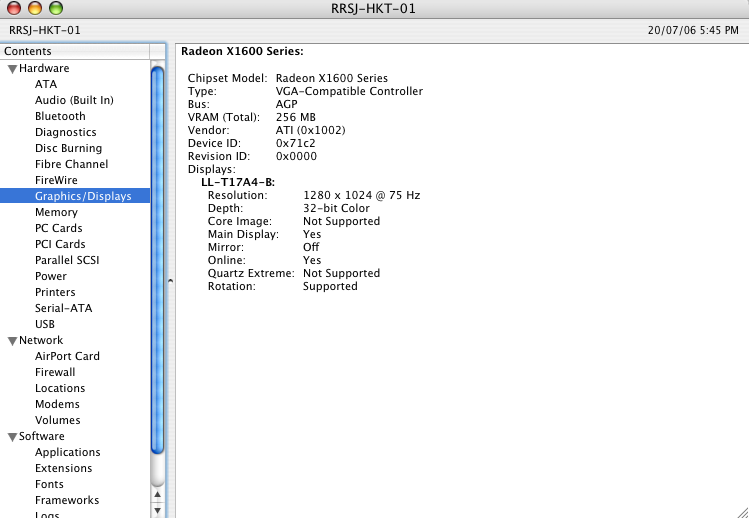

Rockett Posted July 20, 2006 Share Posted July 20, 2006 OK. Got my Sapphire X1600Pro 256mb AGP card. Used the Installer - no more mouse tearing and working great. Only issue now is no CI/QE? Any suggestions? Link to comment https://www.insanelymac.com/forum/topic/19806-howto-x1600x1800-full-support-borisbadenov-method/page/10/#findComment-147981 Share on other sites More sharing options...
Rockett Posted July 20, 2006 Share Posted July 20, 2006 OK so I rebooted and got the blue screen of death (wont get past this). So, ran the uninstaller and now im trying to do it the manual way. However I got half way through only to find: ATIRadeonX1000GA.bundle is missing?! Can someone send me it... can't reboot or anything as im stuck half way through Edit: noticed it was .plugin. Anyway booted fine with the manual install - just still no CI/QE. Again, any suggestion to get them? Link to comment https://www.insanelymac.com/forum/topic/19806-howto-x1600x1800-full-support-borisbadenov-method/page/10/#findComment-147989 Share on other sites More sharing options...
