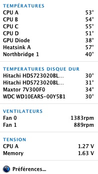

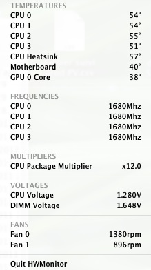

@ROBASEFR Posted February 27, 2012 Share Posted February 27, 2012 Having trouble finding the right fakesmc + plugins to allow istat to see the CPU temps on my UD5. Any suggestions appreciated. Otherwise the script is pure genius. Many thanks. Well You can use either Version 3.1 or 4.0 of FakeSMC I put in Extra/Extensions with the 6.54 script: FakeSMC.kext IntelCPUMonitor.kext ITEIT87x.kext (4.0) or SuperIOFamily.kext (3.1) Here is my iStat info: update: I added RadeonX.kext (rev538) and ACPISensors.kext (v4)in Extra/Extensions and tried HMonitorv1.01 GPU sensor for HD4850 works now ! Link to comment https://www.insanelymac.com/forum/topic/185097-guide-scripted-yosemitemavericks-install-on-gigabyte-mobos/page/157/#findComment-1801200 Share on other sites More sharing options...
