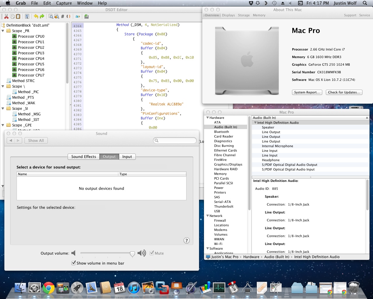

So only remaining issue that I know of right now is the built-in audio; it works just fine in 10.6.8, but in 10.7 (and 10.7.2) the Sound preference just says "No output devices found", same for input. If I plug in my USB headset though, both output and input work with it, just not the audio jacks out the back, to my desktop speakers. Has anyone with this motherboard figured out how to fix that in Lion? Many thanks!

I'm assuming you are installing the included ALC885_889a.kext, HDAEnabler.kext (or DSDT mod), layout885.xml, and Platforms.xml files for the 889a codex audio.
After starting the kext/kernel installer, the install log should produce the following:
#### Installing layout885.xml into System AppleHDA.kext (version: 2.1.3f7)
#### Disk1s2: Contents of AppleHDA.kext/Contents/Resources | grep layout885.xml:
-rw-r--r--@ 1 root  wheel   8.1K Nov  9 18:11 layout885.xml
-rwxr-xr-x@ 1 root  wheel   8.1K Nov  3 18:03 layout885.xml.duplicate*
#### Installing Platforms.xml into System AppleHDA.kext (version: 2.1.3f7)
#### Disk1s2: Contents of AppleHDA.kext/Contents/Resources | grep Platforms.xml:
-rw-r--r--@ 1 root  wheel   312K Nov  9 18:11 Platforms.xml
-rw-r--r--  1 root  wheel   382K Jun 18 15:09 Platforms.xml.original
I'm curious about what shows up in your log.
kind regards,
MAJ
Yeah I always just use your default settings on everything so I assumed the script installed the audio stuff like it always has, but apparently it didn't because I just ran the kext installer again and rebooted, and I have audio again. Weird.
Anyway, thank you so much!

Hey Maj,
It's been a long while since I first started working with the EX58-UD5. It has be my all time favorite build and has held up great for a first gen i7 board! It has been working like a champ until I performed a new 10.7 install on my new SSD hard drive. For some reason, my audio is no longer working. I have a patched dsdt.aml but I don't know if that is the problem. I have attached my extra folder along with the extensions I have in S/L/E. I also attached a screenshot of system profiler and the sound preferences panel.
If anyone else can help me find out what is wrong with my setup, please let me know. I am also on F12 bios and vanilla kernel with no other system modifications other than the added extensions in the attached file.
And Maj, great work on your script. It's much more complex than when we first started! It's helped me out on quite a few occasions!
Thanks in advance,
Wolfie
