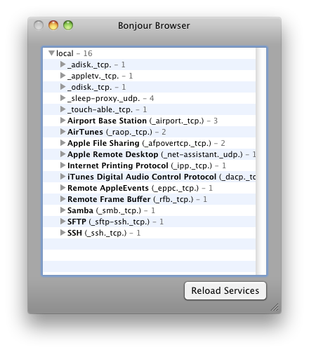

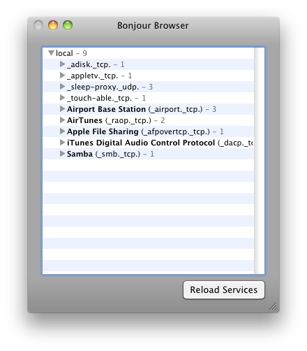

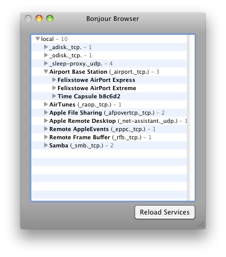

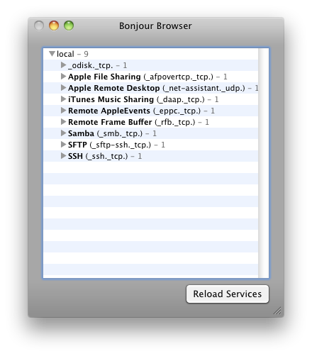

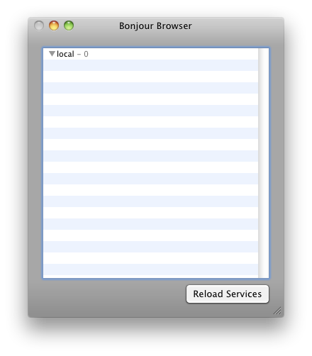

Bonjour observation
My bonjour has always worked out of the box on two installs of SL. I was testing the new EFI (and previously Evoenabler)
on my spare install. Having removed the new EFI and putting everything back re kexts I noticed that no bonjour services
are running so something must have changed my config.
Previously I downloaded a small app called bonjour browser which shows registered services
The first screen shot shows what was registered initially when I first installed. Second is now, third is after
manually turning stuff on in prefs and itunes (haven't found the setting to turn on airport yet or perhaps delete
a plist in some preference folder?)
My main SL install that I use from day to day is fine (last screenshot)
So bonjour does work with realtek kext as before and with out any promiscuous fiddling
You turn these on/off via the sharing menu in system preferences and itunes preferences

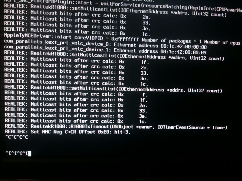

I did something that I thought would work... turns out nope!
I have a VelociRaptor drive that I had Leopard on, so when I installed Snow Leopard I used this guide and installed it to an extra drive I had laying around. The install went well, and I was booted off it and updated to 10.6.1 just fine. I then used Migration Assistant to copy over all my apps/settings from Leopard to the extra drive and it worked.
Then, since the VelociRaptor is much faster, I tried using Carbon Copy Cloner to clone the extra drive to the VelociRaptor. Then I ran the install script and installed Chameleon RC3 and made the partition active.
Tried booting off of it, and it hangs forever after some seemingly random messages. I can boot fine into single user mode, but it never gets past the boot sequence otherwise.
Attached are the last messages I see before it hangs, the ^C^C^C^C etc is me seeing if I can magically make it work :(

then a few lines after that it just hangs, the last two lines been
kext com.apple.Dont_Steal_Mac_OS_X module stop pointer is outside of kext range (stop 0x7ef86053 -kext at 0x7f119000-0x7f11f000)
kext com.apple.Dont_Steal_Mac_OS_X can't load - module stop returned 0xdc008007

Hi
I have an EX58-UD5 with f9 bios...
I started off by recompiling the xcode project from the Psystar site in 64 bit, this compiled with a small edit
and manually loaded without errors but it wasn't getting the mac address and I kept getting static IP addresses in the
169 range. I was just looking at IONetworkingFamily.kext when I noticed Ganxiao had posted a month
ago http://www.insanelymac.com/forum/index.php...05&st=2660#
Essentially he replaced the AppleRTL8169Ethernet.kext (gigabit ethernet) in the plugin sub directory
with a recompiled RealtekR1000.kext (and deleted the other plugins inc the RTL8169 to prevent side effects)
So I deleted RealtekR1000.kext from /S/L/E , renamed the original IONetworkingFamily, copied in the new
version and ran 'Kext Utility' to repair permissions etc. On loading it detected a new ethernet port and
asked me to put in my router details in network preferences. Because of the lazy way I installed things
my ports are now en0 -> en3 but next time if I do things cleanly I'm sure this won't happen, it's not causing
any problems. I then went to advanced ethernet properties and changed manually to full-duplex 1000baseT
Using bonjour browser it shows all my network bonjour services running. I didn't have to do anything
here (unless you want to add extra stuff from sharing preferences)
