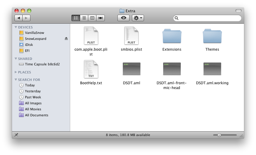

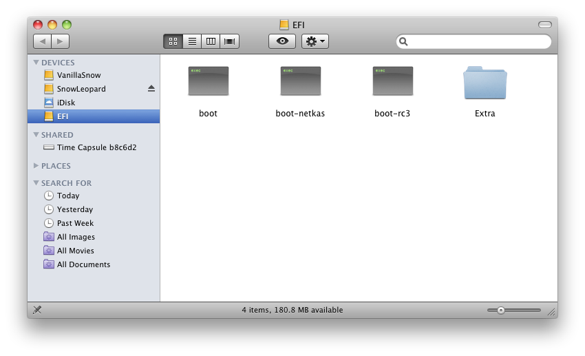

My EFI (disk0s1) is set up as in the following pics. currently running with a copy of netkas boot not rc3
bash-3.2# cksum boot
1879202578 307968 boot

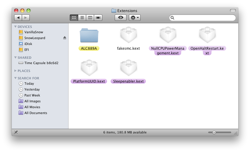

Only non SL kexts are as in the /EFI/Extra/Extensions folder (I didn't bother with the kext to fix the orange disks, I

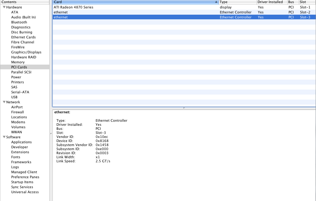

Just a quick note, after running all day without problem I found I couldn't get internet this morning after a
several reboots (network config : the mac address is being set to ff:ff;ff;ff etc and this is being rejected by
my airport).
It seems the lan ports go to sleep and don't get read at boot. In the end I just deleted them from network
preferences. I reset cmos and booted into my other 32 bit instance and checked that the lan was working.
Just for good measure I did a full export of my network settings for possible re-import into the 64 bit system prefs.
By good luck the ethernet ports woke up and were detected at boot (only 1 but I think that is a symptom of the
hacked IONetworkingFamiliy.kext which was for a UD4).
So now my ethernet is working again and as a test I set the ethernet to be built-in at boot.plist and is recognised as
such in system profiler as stated by netkas
So if your test doesn't work it may be because your ports are still sleeping, try deleting them, rebooting
and resetting them, they should be discovered on next reboot.
