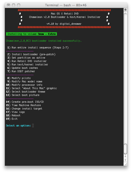

digital_dreamer Posted October 3, 2009 Author Share Posted October 3, 2009 I have followed Digital dreamer's guide from start to finish and am running into the boot0:error error.<SNIP> That's disappointing, I know. Is AHCI enabled? Version of my script? Only the latest bootloaders (Cham RC3 and PC-EFI v10.3) support the large drives (1TB+ disk addressing support). There were issues of large drives not being recognized by the RC2 bootloader. RC3 fixes that issue. My immediate suggestion would be to partition drive in half and try again. Can you install the bootloader, again, and view or post the script's install.log for us? Need to verify that the bootloader is actually getting installed. If it is, then I would have to suspect the BIOS or drive itself. best of wishes, MAJ Link to comment https://www.insanelymac.com/forum/topic/185097-guide-scripted-yosemitemavericks-install-on-gigabyte-mobos/page/18/#findComment-1288164 Share on other sites More sharing options...

rumz Posted October 3, 2009 Share Posted October 3, 2009 Quick question: I followed DD's guide / script for Leopard in July and got my Hackintosh up and running without a hitch. I'm prepping to install Snow Leopard using this script, and currently I have 2 HDDs in the machine: One that's been prepped for Snow Leopard, and one that has the Leopard install I'm using right now (Chameleon RC2). If I use Chameleon RC3 for Snow Leopard on a separate drive, will I run into any issues on bootup having 2 drives installed with Chameleon present? Or do I simply need to, after doing the first part of the script from Leopard, shut down, enter the BIOS and switch the first boot drive to the Snow Leopard drive? Is the Chameleon RC3 boot screen different such that I'll know I'm booting from the right drive, or does it look identical to RC2? Sorry for the newb questions, love the work that has gone into this and appreciate it so much. Link to comment https://www.insanelymac.com/forum/topic/185097-guide-scripted-yosemitemavericks-install-on-gigabyte-mobos/page/18/#findComment-1288955 Share on other sites More sharing options...
digital_dreamer Posted October 4, 2009 Author Share Posted October 4, 2009 Quick question: I followed DD's guide / script for Leopard in July and got my Hackintosh up and running without a hitch. I'm prepping to install Snow Leopard using this script, and currently I have 2 HDDs in the machine: One that's been prepped for Snow Leopard, and one that has the Leopard install I'm using right now (Chameleon RC2). If I use Chameleon RC3 for Snow Leopard on a separate drive, will I run into any issues on bootup having 2 drives installed with Chameleon present? Or do I simply need to, after doing the first part of the script from Leopard, shut down, enter the BIOS and switch the first boot drive to the Snow Leopard drive? Is the Chameleon RC3 boot screen different such that I'll know I'm booting from the right drive, or does it look identical to RC2? Sorry for the newb questions, love the work that has gone into this and appreciate it so much. There may be issues having two different versions of the same bootloader installed, but I wouldn't know for sure. I certainly don't think it would be critical, but I would suggest updating the older one to RC3 at some point. If you have a custom boot.plist and smbios.plist in your Leopard install, save them to another location, then run the D_D bootloader install script. Afterward, you can replace the newly installed boot.plist and smbios.plist with your saved versions. regards, MAJ Link to comment https://www.insanelymac.com/forum/topic/185097-guide-scripted-yosemitemavericks-install-on-gigabyte-mobos/page/18/#findComment-1289002 Share on other sites More sharing options...

rumz Posted October 4, 2009 Share Posted October 4, 2009 There may be issues having two different versions of the same bootloader installed, but I wouldn't know for sure. I certainly don't think it would be critical, but I would suggest updating the older one to RC3 at some point. If you have a custom boot.plist and smbios.plist in your Leopard install, save them to another location, then run the D_D bootloader install script. Afterward, you can replace the newly installed boot.plist and smbios.plist with your saved versions. regards, MAJ You mean in order to update Chameleon to backup those 2 files and then replace them after running the bootloader script to update to RC3? Good deal-- I'll just update it before I install Snow Leopard to avoid any issues there. Thanks! Another question: can I use the same boot.plist for the Snow Leopard install? (all it has is a hex string for my graphics card and a section to tell the bootloader what resolution to display at) Link to comment https://www.insanelymac.com/forum/topic/185097-guide-scripted-yosemitemavericks-install-on-gigabyte-mobos/page/18/#findComment-1289077 Share on other sites More sharing options...
jojocommi Posted October 4, 2009 Share Posted October 4, 2009 Hi, Sorry if this is in the wrong area but I have trouble moving around this forum. I have finally installed SL with digital dreamer script 4.10. The installation was successful but I am having issues post installation. I have no internet and no ethernet is discovered. I do not know how to install kexts but I figured the network kexts and audio kexts would be installed automatically with the script. I get no sound through SPDIF output, and just no sound at all. Not sure how to activate bluetooth with a usb dongle. I would like to have wireless networking available and found a topic that has the exact pci card I am using (linksys dualband wmp600n) but the link to ralink2860 driver is dead. Is there another way to get wireless working? I have included my boot cache log just incase it provides more information that I am unaware of. Thanks for any help. boot cache log: bootcachelog.txt Link to comment https://www.insanelymac.com/forum/topic/185097-guide-scripted-yosemitemavericks-install-on-gigabyte-mobos/page/18/#findComment-1289163 Share on other sites More sharing options...
