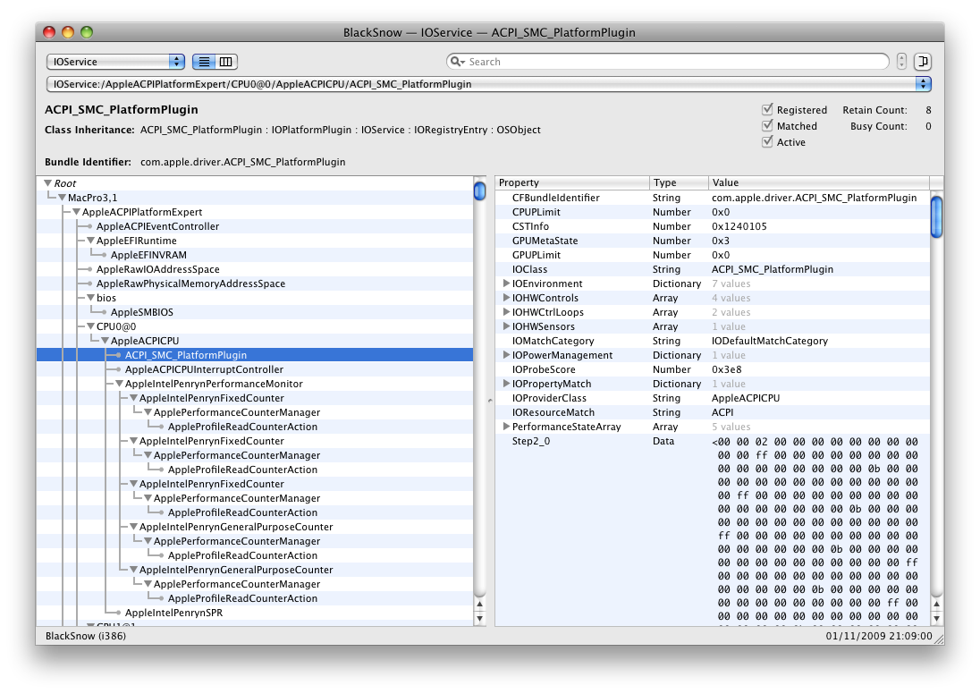

FKA Posted November 1, 2009 Author Share Posted November 1, 2009 Okay great. I just wanted to make absolutely sure I was using the correct data as I don't know if my system actually leaves C0? What's the best way to know if C-States are working? You should have 'cstinfo' listed under ACPI_SMC in ioreg. the best 'tell' is your cpu temp at idle. I think I only enter C1 and get temps around 38-40.C - others report lower temps. I'd expect voodoomonitor or similar to show a vCore drop beyond your lowest p-state but this doesn't seem to be the case. D. Link to comment https://www.insanelymac.com/forum/topic/181631-dsdt-vanilla-speedstep-generic-scope-_pr/page/25/#findComment-1317000 Share on other sites More sharing options...
blackosx Posted November 1, 2009 Share Posted November 1, 2009 You should have 'cstinfo' listed under ACPI_SMC in ioreg. the best 'tell' is your cpu temp at idle. I think I only enter C1 and get temps around 38-40.C - others report lower temps. I'd expect voodoomonitor or similar to show a vCore drop beyond your lowest p-state but this doesn't seem to be the case. D. Thanks. Yes, I have CSTInfo in ioreg (I have attached a screengrab). And, I have just seen VoodooMonitor flash a voltage reading of 1.116V which is lower than lowest P-State (1.132V). So it must be working! My temp is reading 42C at the moment (with stock intel cooler), and it can range from 40-48C. I will keep my eye on it. Cheers FormerlyKnownAs Link to comment https://www.insanelymac.com/forum/topic/181631-dsdt-vanilla-speedstep-generic-scope-_pr/page/25/#findComment-1317013 Share on other sites More sharing options...

mitch_de Posted November 2, 2009 Share Posted November 2, 2009 Thanks. Yes, I have CSTInfo in ioreg (I have attached a screengrab). Cheers FormerlyKnownAs has anyone of the heros her found out how that Step2_0 - key shown in pic attatched - works ? I believe thats the SP1, SP2,SP3.. keys in that .plist of ACPI_SMCplugin and are different for each Macmodell group by Model name (iMacx,y MacProx,y). Maybe thats the thresould of the stepping, means at which CPU load % steps up / down ? An try if SP1,SP2 is Step1_0, Step2_0.... would be to change MacModell (by chameleon smbios .plist), reboot, and look after that key again. Pic "stolen" from FormerlyKnownAs Link to comment https://www.insanelymac.com/forum/topic/181631-dsdt-vanilla-speedstep-generic-scope-_pr/page/25/#findComment-1317291 Share on other sites More sharing options...
