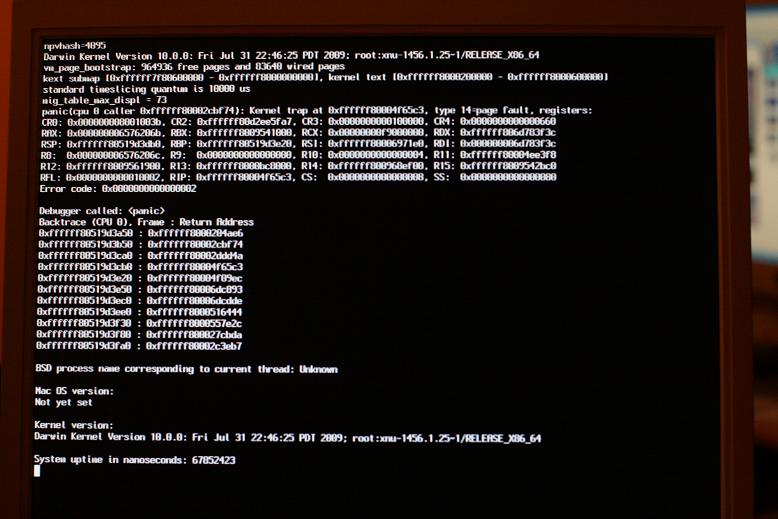

mitch_de Posted November 4, 2009 Share Posted November 4, 2009 If you use P-states and get KPs at cpu load try to higher the VID (hex) to get more mV for that PState0 and 1 (highest MHZ states). Simple add 1 up to 3(4?) (1= 25mV) to the VID(hex) and try if you then get no KP anymore. I would try step by step and not rise up 3 at once ! For example using blackosx PStates: Package (0x06) { 2660, 0, 10, 10, 0x0A1D, 0 }, // 0x0A = Multi 10dez* , 1D= VID , rise up 1 to 3 = 1E,1F,20hex Package (0x06) { 2660, 0, 10, 10, 0x0A1F, 0 } // 50mV more Package (0x06) { 2394, 0, 10, 10, 0x091C, 1 }, // 0x09 = Multi 09dez* , 1C= VID, rise up 1 to 3 = 1D,1E,1F Package (0x06) { 2394, 0, 10, 10, 0x091D // 25 mV more WARNING: TYPO in blackosx last Pstate ! Package (0x06) { 1596, 0, 10, 10, 0x61B8, 4 } //WRONG, malformted Multi, VID B8 = extreme high mVolts! Package (0x06) { 1596, 0, 10, 10, 0x061B, 4 } // OK !!!, 06 Multi and 1B VID Link to comment https://www.insanelymac.com/forum/topic/181631-dsdt-vanilla-speedstep-generic-scope-_pr/page/27/#findComment-1319796 Share on other sites More sharing options...
blackosx Posted November 4, 2009 Share Posted November 4, 2009 WARNING: TYPO in blackosx last Pstate !Package (0x06) { 1596, 0, 10, 10, 0x61B8, 4 } //WRONG, malformted Multi, VID B8 = extreme high mVolts! Package (0x06) { 1596, 0, 10, 10, 0x061B, 4 } // OK !!!, 06 Multi and 1B VID Thanks mitch-de. You might have saved my CPU from death.. I owe you one I wondered why the voltage never dropped properly for this P-state. I will make sure I change it. Link to comment https://www.insanelymac.com/forum/topic/181631-dsdt-vanilla-speedstep-generic-scope-_pr/page/27/#findComment-1319814 Share on other sites More sharing options...
