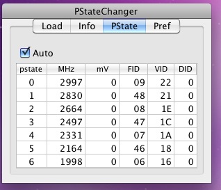

mcsmart Posted November 5, 2009 Share Posted November 5, 2009 Hey there, it's me again. I still cannot get it to work. Even though my P-states show up correctly in IOReg I get the following in sysctrl: hw.cpufrequency_max: 3000000000 hw.cpufrequency_min: 3000000000 hw.cpufrequency: 3000000000 hw.busfrequency_max: 1332000000 hw.busfrequency_min: 1332000000 hw.busfrequency: 1332000000 I am using the original BIOS and did not overclock my system. The only kexts I am using are: OpenHaltRestart.kext, fakesmc.kext and LegacyHDA.kext. Is there anything I am doing wrong? I have attached my boot.plist, smbios.plist and DSDT. I also played with DropSSDT=y/n, but it did not make any difference... As I mentioned earlier my motherboard supports C-states (included in stock SSDT and therefore not included in my custom DSDT). Regards, mcsmart stuff.zip Link to comment https://www.insanelymac.com/forum/topic/181631-dsdt-vanilla-speedstep-generic-scope-_pr/page/28/#findComment-1321194 Share on other sites More sharing options...
tinush Posted November 5, 2009 Share Posted November 5, 2009 Hi there, with allot of help from MM67 i got speed-step working great on my e6750 cpu Cpu-i gives the following p-states Package (0x06) { 2664, 0, 10, 10, 0x81D, 0x81D }, Package (0x06) { 2331, 0, 10, 10, 0x71A, 0x71A }, Package (0x06) { 1998, 0, 10, 10, 0x616, 0x616 } After i changed it to a E8500 for testing (would't run higher then 2.83ghz according to cpu-i) cpu-i gave me different p-states Package (0x06) { 2664, 0, 10, 10, 0x082A, 0x082A }, Package (0x06) { 2331, 0, 10, 10, 0x0726, 0x0726 }, Package (0x06) { 1998, 0, 10, 10, 0x061E, 0x061E } what happened? T. Link to comment https://www.insanelymac.com/forum/topic/181631-dsdt-vanilla-speedstep-generic-scope-_pr/page/28/#findComment-1321218 Share on other sites More sharing options...
FKA Posted November 5, 2009 Author Share Posted November 5, 2009 Hey there, it's me again. I still cannot get it to work. Even though my P-states show up correctly in IOReg I get the following in sysctrl: hw.cpufrequency_max: 3000000000 hw.cpufrequency_min: 3000000000 hw.cpufrequency: 3000000000 hw.busfrequency_max: 1332000000 hw.busfrequency_min: 1332000000 hw.busfrequency: 1332000000 I am using the original BIOS and did not overclock my system. The only kexts I am using are: OpenHaltRestart.kext, fakesmc.kext and LegacyHDA.kext. Is there anything I am doing wrong? I have attached my boot.plist, smbios.plist and DSDT. I also played with DropSSDT=y/n, but it did not make any difference... As I mentioned earlier my motherboard supports C-states (included in stock SSDT and therefore not included in my custom DSDT). Regards, mcsmart Try this .. sorry I cant complie for you I'm at work on XP machine and don't have a decent complier.. dsdtsmart.zip ##EDIT## you don't need dropSSDT with this! D. Link to comment https://www.insanelymac.com/forum/topic/181631-dsdt-vanilla-speedstep-generic-scope-_pr/page/28/#findComment-1321225 Share on other sites More sharing options...
mcsmart Posted November 5, 2009 Share Posted November 5, 2009 what happened? P-states are CPU-specific. If you are changing your CPU you'll also need to change your P-states. If you use VodooPower.kext or Cpu-i.kext this does not matter because these kernel extensions detect the P-states of your CPU automatically. However, if you have your P-states hardcoded to your DSDT, they are most likely not going to work with a different CPU. @FormerlyKnownAs: Thanks a lot for taking the time. I really appreciate your work. I am going to look over it tomorrow. Rehards, mcsmart Link to comment https://www.insanelymac.com/forum/topic/181631-dsdt-vanilla-speedstep-generic-scope-_pr/page/28/#findComment-1321228 Share on other sites More sharing options...
tinush Posted November 5, 2009 Share Posted November 5, 2009 P-states are CPU-specific. If you are changing your CPU you'll also need to change your P-states. If you use VodooPower.kext or Cpu-i.kext this does not matter because these kernel extensions detect the P-states of your CPU automatically. However, if you have your P-states hardcoded to your DSDT, they are most likely not going to work with a different CPU. @FormerlyKnownAs: Thanks a lot for taking the time. I really appreciate your work. I am going to look over it tomorrow. Rehards, mcsmart Thnx for the fast reply, but this happened with the same E6750 (when i put it back, after the test with the 8500) T. Link to comment https://www.insanelymac.com/forum/topic/181631-dsdt-vanilla-speedstep-generic-scope-_pr/page/28/#findComment-1321237 Share on other sites More sharing options...
