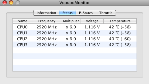

OK - I have ran various tests last night.
Setting all voltages to AUTO in BIOS with CPU clocked/ unclocked. And with varying formats of Scope (PR) in DSDT - being:
- With my origional cst and ist additions to DSDT,
- With my copy of M Chief's Scope (_PR ) section of DSDT from his v2.8 (with and without Legacy SMC and AGPM kexts.)
- With my adaptation of mm67's Scope (PR) with and without Legacy AGPM and SMC
- Copying the format MC has created for Matthew L ( I did not expect this to work. No offence Mathew but we have differant MB's which will have different memory addresses for CPUPM and I still don't know where MC got this value from > OperationRegion (PMBL, SystemMemory, 0x7FEE85A0, 0x03AB) )
CPU Clocked with voltages in AUTO i get some hidious temperature (around 68+ .C @ idle)
this happens with all the above DSDT variants.
Unclocked with voltages in AUTO i get 42.C @ idle with all DSDT variants
Clocked (420 x 8 ) with voltages set (vCore 1.25v) - i get 43.C @ idle with all DSDT variants
There is no evidence with any scenario that my CPU enters a state more idle than my lowest p-state multi (C1 or C2).
Conclusion - there is clearly more than one way to skin a cat! :)

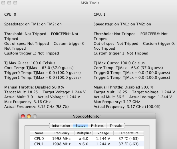

Many thanks Master Chief your new method is better :)
Finally I can see my cpu voltages are up and down by msr tool :)
And for voltages value can work, I used cpuz.exe for see voltage and cpu speed when idle or when full task. And calculated by P-stated Calculator for Pss code

Native speedstepping (8 p-states and 37 degrees idle temp) with Core 2 Duo E8500 using Master Chief's method from the P5K Pro thread.

Unlike my previous method, this is not working right.. VoodooMonitor shows all 8 p-states, shows the CPU running at the lowest and jumping to the highest on load - voltage never changes though! And in MSRTools it just keeps jumping back and forth between 3.09 and 3.17GHz.
And what's with the Multipliers in MSRTools...??
On the flipside, enabling manual throttle in VoodooMonitor registers in MSRTools and when throttling a 1084p video I had running started breaking up, so at least throttle is 100% working.
/EDIT....*cries*
Went back to my previous method and it's doing exactly the same, it was never working!
Then I tried ripping out everything - Manual throttling still worked, VoodooMonitor still showed 8 P-states and CPU ran at full speed.
I also tried completely removing the P-States, and only adding the four P-States from my ACPI dump. Same result, VoodooMonitor shows the same 8 P-states regardless.
/EDIT 01/11 - fixed using Master Chief's latest CPU scope (edited for 2 cores) and PNOT. DSDT attached here:
