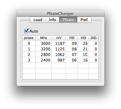

liujianwei Posted September 10, 2015 Share Posted September 10, 2015 There is no voodoo state for 10.9.5,so there is no vid fid for my core 2 quad q9650,too bad.I'm sorry,it works,thank you so much. Q9650 Vanilla speed step 0x0926 0x0821 0x071C 0x0616 4 states, CPU0-3.txt to avoid clover generate P & C states I got ACPI THRM sensor panic(cpu 0 caller 0x001A8CD4): Kernel trap at 0x223ab275, type 14=page fault, registers: problems when I use this patch,so I stop use it. memory problem # Insert methods _PSS (4 P-states), _PSD and _CST into CPUs 0-3 # into method label _PSS parent_label CPU0 remove_entry; into processor label CPU0 insert begin Method (_PSS, 0, NotSerialized)\n {\n Return (Package (0x04)\n {\n Package (0x06)\n {\n Zero, \n Zero, \n 0x10, \n 0x10, \n 0x0926, // FF = FID, VV = VID\n Zero // P-state 0\n }, \n Package (0x06)\n {\n Zero, \n Zero, \n 0x10, \n 0x10, \n 0x0821, // FF = FID, VV = VID\n One // P-state 1\n }, \n Package (0x06)\n {\n Zero, \n Zero, \n 0x10, \n 0x10, \n 0x071C, // FF = FID, VV = VID\n 0x02 // P-state 2\n }, \n Package (0x06)\n {\n Zero, \n Zero, \n 0x10, \n 0x10, \n 0x0616, // FF = FID, VV = VID\n 0x03 // P-state 3\n }\n })\n } end; into method label _PSD parent_label CPU0 remove_entry; into processor label CPU0 insert begin Method (_PSD, 0, NotSerialized)\n {\n Return (Package (0x05)\n {\n 0x05, \n Zero, \n Zero, \n 0xFC, \n 0x04\n })\n } end; into method label _CST parent_label CPU0 remove_entry; into processor label CPU0 insert begin Method (_CST, 0, NotSerialized)\n {\n Return (Package (0x02)\n {\n One, \n Package (0x04)\n {\n ResourceTemplate ()\n {\n Register (FFixedHW, \n 0x01, // Bit Width\n 0x02, // Bit Offset\n 0x0000000000000000, // Address\n 0x01, // Access Size\n )\n }, \n One, \n 0x9D, \n 0x03E8\n }\n })\n } end; into method label _PSS parent_label CPU1 remove_entry; into processor label CPU1 insert begin Method (_PSS, 0, NotSerialized)\n {\n Return (^^CPU0._PSS ())\n } end; into method label _PSD parent_label CPU1 remove_entry; into processor label CPU1 insert begin Method (_PSD, 0, NotSerialized)\n {\n Return (^^CPU0._PSD ())\n } end; into method label _CST parent_label CPU1 remove_entry; into processor label CPU1 insert begin Method (_CST, 0, NotSerialized)\n {\n Return (Package (0x04)\n {\n 0x03, \n Package (0x04)\n {\n ResourceTemplate ()\n {\n Register (FFixedHW, \n 0x01, // Bit Width\n 0x02, // Bit Offset\n 0x0000000000000000, // Address\n ,)\n }, \n One, \n Zero, \n 0x03E8\n }, \n Package (0x04)\n {\n ResourceTemplate ()\n {\n Register (FFixedHW, \n 0x08, // Bit Width\n 0x00, // Bit Offset\n 0x0000000000000414, // Address\n ,)\n }, \n 0x02, \n One, \n 0x01F4\n }, \n Package (0x04)\n {\n ResourceTemplate ()\n {\n Register (FFixedHW, \n 0x08, // Bit Width\n 0x00, // Bit Offset\n 0x0000000000000415, // Address\n ,)\n }, \n 0x03, \n 0x55, \n 0xFA\n }\n })\n } end; into method label _PSS parent_label CPU2 remove_entry; into processor label CPU2 insert begin Method (_PSS, 0, NotSerialized)\n {\n Return (^^CPU0._PSS ())\n } end; into method label _PSD parent_label CPU2 remove_entry; into processor label CPU2 insert begin Method (_PSD, 0, NotSerialized)\n {\n Return (^^CPU0._PSD ())\n } end; into method label _CST parent_label CPU2 remove_entry; into processor label CPU2 insert begin Method (_CST, 0, NotSerialized)\n {\n Return (^^CPU1._CST ())\n } end; into method label _PSS parent_label CPU3 remove_entry; into processor label CPU3 insert begin Method (_PSS, 0, NotSerialized)\n {\n Return (^^CPU0._PSS ())\n } end; into method label _PSD parent_label CPU3 remove_entry; into processor label CPU3 insert begin Method (_PSD, 0, NotSerialized)\n {\n Return (^^CPU0._PSD ())\n } end; into method label _CST parent_label CPU3 remove_entry; into processor label CPU3 insert begin Method (_CST, 0, NotSerialized)\n {\n Return (^^CPU1._CST ())\n } end Link to comment https://www.insanelymac.com/forum/topic/181631-dsdt-vanilla-speedstep-generic-scope-_pr/page/78/#findComment-2166717 Share on other sites More sharing options...
