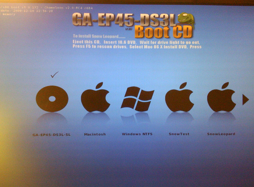

Mammoth Posted April 24, 2010 Share Posted April 24, 2010 Yes, remember I asked the same question, somewhere in the last 10 pages (fairly recent.) You posted a link with instructions from someone else, I just never got it to work for me. Well, the second drive was bootable, not the first. But then the transfer speeds were slow compared to SCSI so I gave up. Here is the link to landmark's directions. Thanks BlackOSX and BigPoppa206, I recommend the High-Point Tech RocketRAID cards highly for anyone looking for a RAID card that you can actually boot from because High-point provides OS X drivers! Drivers aren't provided for ALL of their cards, so make sure to get one that does. Using these cards, no tricky commands or setup is required at all. You install the card, configure your arrays, then follow BlackOSX's guides to a "T" to get setup. Mac OS X actually comes with some default RR drivers, so you don't even need them for the install (but I update to the newest drivers after the install). For Windows 7, the drivers are required in order to install. @BlackOSX: I solved my strange MBR / booting issue with Chameleon, but unfortunately am not sure exactly what the issue was. : ( I tried for days and more installs attempts than I can count, but it's working now so... I have some other issues I need help with now, but I will list them later in a separate post. THANKS YOU GUYS AGAIN! This is the best place for people serious about getting OS X up and running and the help here is the BEST! Hi Mammoth. Your description of your issue has been first class, I am just sorry I couldn't identify an answer for you. As for the BootCD, can you show me a picture of what you mean by the text is ''all messed up"?. I have just booted from the v1.07 BootCD and this is what I see. Welcome aboard Stealth Dave. Thanks for the report Hi BlackOSX, Next time I see it do it, I will snap a pic to send to you. Thanks. Link to comment https://www.insanelymac.com/forum/topic/180954-guide-vanilla-retail-106x-with-chameleon-v2-for-gigabyte-ga-ep45-ds3l/page/113/#findComment-1455195 Share on other sites More sharing options...

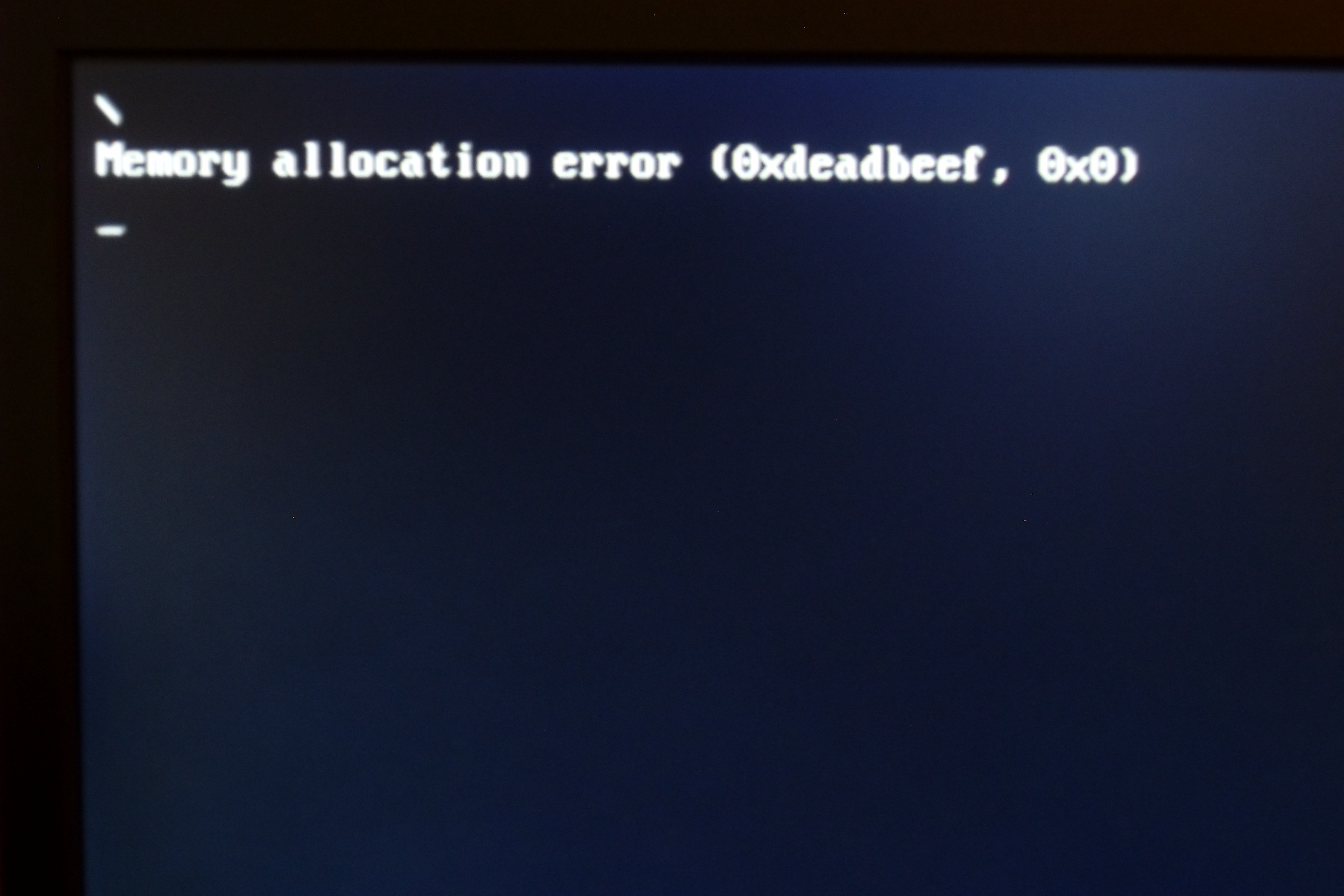

sjpapa Posted April 25, 2010 Share Posted April 25, 2010 try Quick boot=disabled Please explain! Where is this command? Is this Chameleon boot option? com.apple.Boot.plist? many thanks try Quick boot=disabled The board is ok. RAM passes test. I need to find a way around kext caches, repairpermission, or run kext utility. The last thing I ded was repair the CMOS bug in the dsdt. But the system does not boot not even with the old dsdt, playes with all combinations of known kexts [even the presound fix]... Link to comment https://www.insanelymac.com/forum/topic/180954-guide-vanilla-retail-106x-with-chameleon-v2-for-gigabyte-ga-ep45-ds3l/page/113/#findComment-1455344 Share on other sites More sharing options...
rednous Posted April 25, 2010 Share Posted April 25, 2010 Please explain! Where is this command? Is this Chameleon boot option? com.apple.Boot.plist? many thanks The board is ok. RAM passes test. I need to find a way around kext caches, repairpermission, or run kext utility. The last thing I ded was repair the CMOS bug in the dsdt. But the system does not boot not even with the old dsdt, playes with all combinations of known kexts [even the presound fix]... sjpapa, forgot to tell you this option is in the MB boot menu. Link to comment https://www.insanelymac.com/forum/topic/180954-guide-vanilla-retail-106x-with-chameleon-v2-for-gigabyte-ga-ep45-ds3l/page/113/#findComment-1455381 Share on other sites More sharing options...

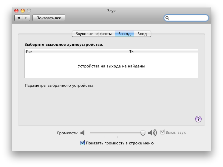

Tanya bl Posted April 26, 2010 Share Posted April 26, 2010 Hello everyone! First of all, I want to thank blackosx for this wonderful guide, it was very useful and it was the first time when I make my HackOS working But I have one little problem... My HDA 888 doesnt work. Absolutely. I did everything that was written in the guide, but sound doesnt turn on I have EP45T-DS3 & running Mac OS X 10.6 without comboupdates. But now I'm going to update my system and will try to make HDA888 work like this written in the guide. So, if I will not be able to turn on my sound, I'll return here and tell you more about it. Ask me please about additional info, 'cause I really dont know what information you need to solve this problem. PS Sorry for my poor English Link to comment https://www.insanelymac.com/forum/topic/180954-guide-vanilla-retail-106x-with-chameleon-v2-for-gigabyte-ga-ep45-ds3l/page/113/#findComment-1455877 Share on other sites More sharing options...

bigpoppa206 Posted April 26, 2010 Share Posted April 26, 2010 But I have one little problem...My HDA 888 doesnt work. Absolutely. I did everything that was written in the guide, but sound doesnt turn on I have EP45T-DS3 & running Mac OS X 10.6 without comboupdates. But now I'm going to update my system and will try to make HDA888 work like this written in the guide. Are you sure? I looked up for specifications for that board and it came back as 889a. Link to comment https://www.insanelymac.com/forum/topic/180954-guide-vanilla-retail-106x-with-chameleon-v2-for-gigabyte-ga-ep45-ds3l/page/113/#findComment-1455913 Share on other sites More sharing options...

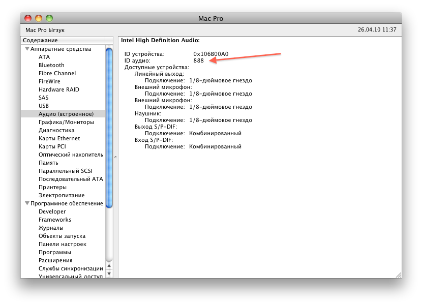

Tanya bl Posted April 26, 2010 Share Posted April 26, 2010 Are you sure? I looked up for specifications for that board and it came back as 889a. I'm not really sure. But System info tells me that i have HDA888 (see attach): PS So now I'm rebooting with 10.6.3 combo. Crossing fingers! Link to comment https://www.insanelymac.com/forum/topic/180954-guide-vanilla-retail-106x-with-chameleon-v2-for-gigabyte-ga-ep45-ds3l/page/113/#findComment-1455916 Share on other sites More sharing options...

Tanya bl Posted April 26, 2010 Share Posted April 26, 2010 But if that kext is loading then it might just be the system saying that's what it thinks you have. TRY THIS LINK and see if the specs match up for you. Yep, this is my motherboard. If so, you have the same motherboard sound as me and it only takes a certain legacyhda.kext to get it running, nothing else. My EP45C-UD3R uses the same audio AND works flawlessly with 10.6.3. If you want to test this theory, GO TO THIS POST and download the guy's SL_Pack and use his LegacyHDA.kext instead and see what happens. Don't forget to run Kext Utility after you install it, reboot and then go to System Preferences, Sound, Output and select Internal Speakers. Then your green port in the back should have stereo sound coming out. Also, make sure your BIOS is set properly. I downloaded this pack and replaced LegasyHDA.kext in /E/E/, runned kext utility, but i received no result Maybe I use Kext Utility wrong way? I also replaced my dsdt.aml with DSDT.aml from SL_Pack but nothing was changed. There's my System Prefs (Sound) panel: (translation of inscription in window: "Output devices not found") So, about BIOS' settings... Have you the most important settings that can make a point of work of sound system? I check my BIOS and there's Azaila codec = "Auto" Link to comment https://www.insanelymac.com/forum/topic/180954-guide-vanilla-retail-106x-with-chameleon-v2-for-gigabyte-ga-ep45-ds3l/page/113/#findComment-1456102 Share on other sites More sharing options...

bigpoppa206 Posted April 27, 2010 Share Posted April 27, 2010 Yep, this is my motherboard. I downloaded this pack and replaced LegasyHDA.kext in /E/E/, runned kext utility, but i received no result Maybe I use Kext Utility wrong way? I also replaced my dsdt.aml with DSDT.aml from SL_Pack but nothing was changed. There's my System Prefs (Sound) panel: (translation of inscription in window: "Output devices not found") So, about BIOS' settings... Have you the most important settings that can make a point of work of sound system? I check my BIOS and there's Azaila codec = "Auto" Wait until BlackOSX gets back on, maybe he has a way to ID your sound from your motherboard. Sounds like something is wonkie. PS, you should build your own DSDT file, not use someone else's. Remember the DSDT file is based on the BIOS for YOUR motherboard and using one made for another board can have weird effects. Link to comment https://www.insanelymac.com/forum/topic/180954-guide-vanilla-retail-106x-with-chameleon-v2-for-gigabyte-ga-ep45-ds3l/page/113/#findComment-1456627 Share on other sites More sharing options...

Johnny V Posted April 28, 2010 Share Posted April 28, 2010 Yep, this is my motherboard. I downloaded this pack and replaced LegasyHDA.kext in /E/E/, runned kext utility, but i received no result Maybe I use Kext Utility wrong way? I also replaced my dsdt.aml with DSDT.aml from SL_Pack but nothing was changed. There's my System Prefs (Sound) panel: (translation of inscription in window: "Output devices not found") So, about BIOS' settings... Have you the most important settings that can make a point of work of sound system? I check my BIOS and there's Azaila codec = "Auto" As Blackosx mentioned "@Tanya bl - EP45T-DS3 uses ALC889a - You need to read another thread." You'll need to modify your DSDT as the SL_Pack DSDT is for ALC888. Here's my ALC889a DSDT code: } Device (HDEF) { Name (_ADR, 0x001B0000) Method (_PRW, 0, NotSerialized) { Return (Package (0x02) { 0x0D, 0x05 }) } Method (_DSM, 4, NotSerialized) { Store (Package (0x08) { "codec-id", Buffer (0x04) { 0x89, 0x08, 0xEC, 0x10 }, "layout-id", /**** Is ResourceTemplate, but EndTag not at buffer end ****/ Buffer (0x04) { 0x79, 0x03, 0x00, 0x00 }, "device-type", Buffer (0x10) { "Realtek ALC889a" }, "PinConfigurations", Buffer (0x18) { /* 0000 */ 0x10, 0x44, 0x11, 0x01, 0x20, 0x14, 0x01, 0x01, /* 0008 */ 0x40, 0x4C, 0x21, 0x02, 0x50, 0x34, 0x81, 0x01, /* 0010 */ 0x60, 0x9C, 0xA1, 0x02, 0xF0, 0x61, 0x4B, 0x01 } }, Local0) DTGP (Arg0, Arg1, Arg2, Arg3, RefOf (Local0)) Return (Local0) } } } Device (SBUS) Your board might need a little different code... but it could be a good start. Also attached is my DSDT. Might want to install it and give it a shot. Also attached are the LegecyHDA889a. Pick one and see if it works. dsdt.aml_3.zip LegacyHDA_889__ALC889a__chamel_extra_extensions.zip Link to comment https://www.insanelymac.com/forum/topic/180954-guide-vanilla-retail-106x-with-chameleon-v2-for-gigabyte-ga-ep45-ds3l/page/113/#findComment-1457718 Share on other sites More sharing options...
