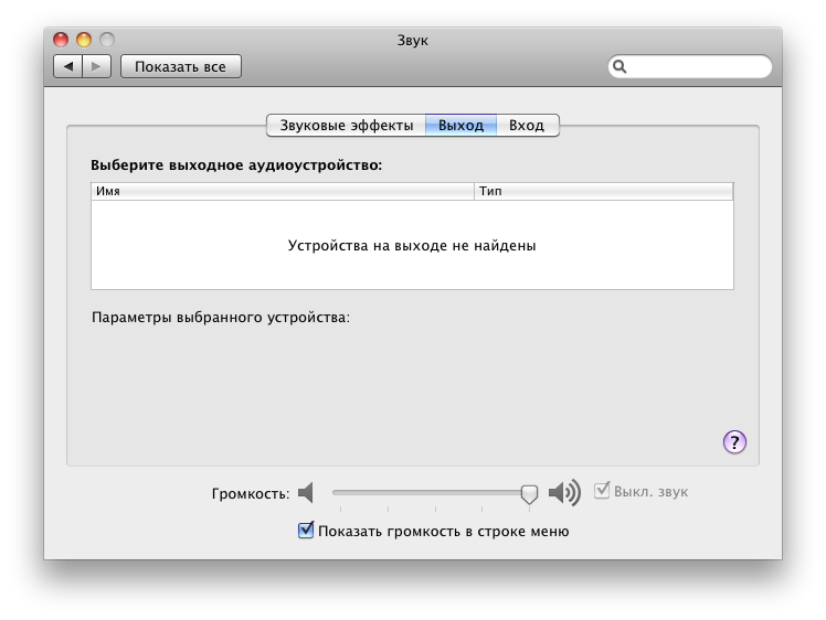

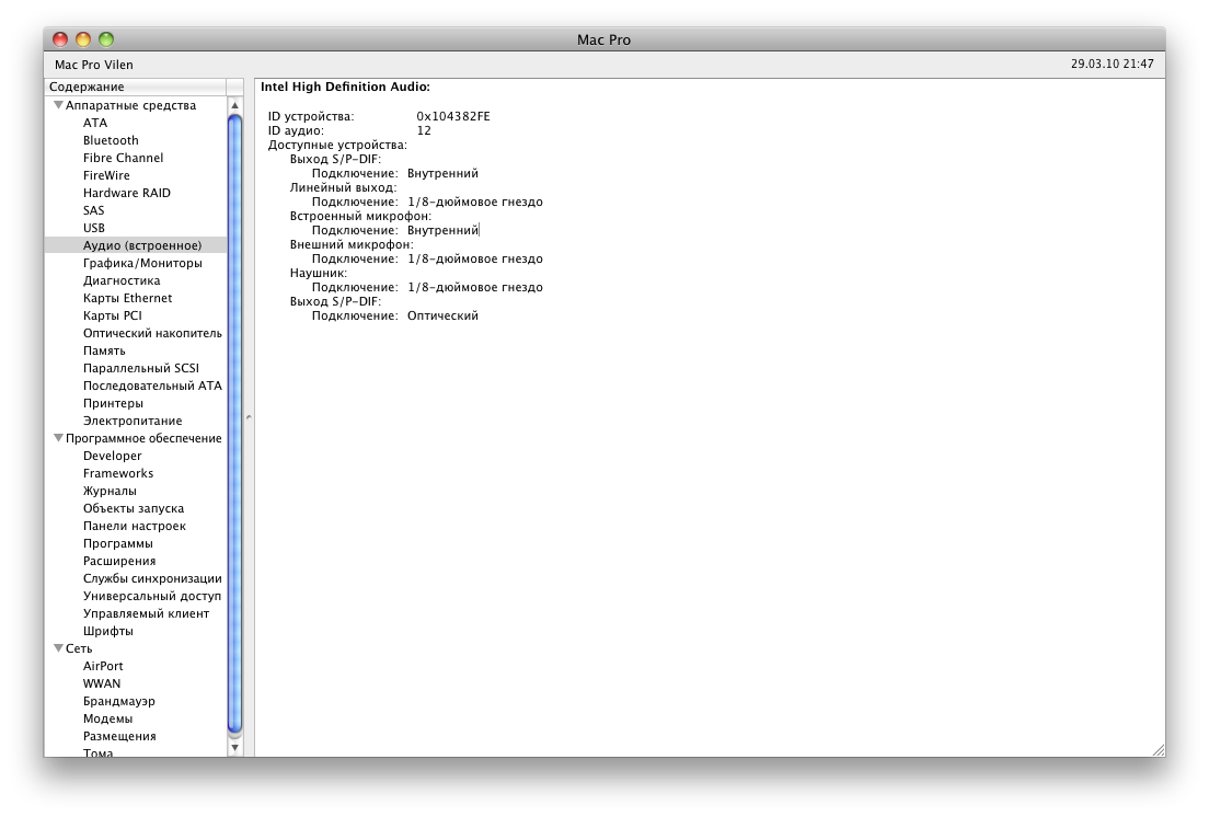

xumix Posted March 29, 2010 Share Posted March 29, 2010 just installed 10.6.3, used your legacy kexts in /Extra, and now i have: 29.03.10 21:57:45 kernel HDAEnabler: Copyright (c) 2008 by Kabyl 29.03.10 21:57:45 kernel HDAEnabler: 05/05/2008 Added SP-Audio support by Taruga 29.03.10 21:57:45 kernel HDAEnabler: 03/07/2009 Compiled for 32/64-bit by Taruga 29.03.10 21:57:45 kernel Sound assertion "0 == pciVendorProductID" failed in "/SourceCache/AppleHDA/AppleHDA-184.4.3/AppleHDAController/AppleHDAController.cpp" at line 3226 goto Exit 29.03.10 21:57:53 kernel Sound assertion "0 != result" failed in "/SourceCache/AppleHDA/AppleHDA-184.4.3/AppleHDA/AppleHDAWidget.cpp" at line 3794 goto handler 29.03.10 21:57:53 kernel Sound assertion "0 != widget->setUnsolicited ( true )" failed in "/SourceCache/AppleHDA/AppleHDA-184.4.3/AppleHDA/AppleHDACodecGeneric.cpp" at line 1099 goto handler 29.03.10 21:57:53 kernel Sound assertion "!hasInitialSettings" failed in "/SourceCache/AppleHDA/AppleHDA-184.4.3/AppleHDA/AppleHDAEngine.cpp" at line 7356 goto Exit 29.03.10 21:57:53 kernel Sound assertion "0 != activateAudioEngine ( engine )" failed in "/SourceCache/AppleHDA/AppleHDA-184.4.3/AppleHDA/AppleHDADriver.cpp" at line 1955 goto Exit 29.03.10 21:57:53 kernel Sound assertion "!activateAudioEngines ()" failed in "/SourceCache/AppleHDA/AppleHDA-184.4.3/AppleHDA/AppleHDADriver.cpp" at line 205 goto Exit 29.03.10 21:57:55 kernel Sound assertion "0 != result" failed in "/SourceCache/AppleHDA/AppleHDA-184.4.3/AppleHDA/AppleHDAWidget.cpp" at line 3794 goto handler 29.03.10 21:57:55 kernel Sound assertion "0 != widget->setUnsolicited ( true )" failed in "/SourceCache/AppleHDA/AppleHDA-184.4.3/AppleHDA/AppleHDACodecGeneric.cpp" at line 1099 goto handler 29.03.10 21:57:55 kernel Sound assertion "!hasInitialSettings" failed in "/SourceCache/AppleHDA/AppleHDA-184.4.3/AppleHDA/AppleHDAEngine.cpp" at line 7356 goto Exit 29.03.10 21:57:56 kernel Sound assertion "0 != activateAudioEngine ( engine )" failed in "/SourceCache/AppleHDA/AppleHDA-184.4.3/AppleHDA/AppleHDADriver.cpp" at line 1955 goto Exit 29.03.10 21:57:56 kernel Sound assertion "!activateAudioEngines ()" failed in "/SourceCache/AppleHDA/AppleHDA-184.4.3/AppleHDA/AppleHDADriver.cpp" at line 205 goto Exit Link to comment https://www.insanelymac.com/forum/topic/161430-realtek-alc1200-ich10-working-kext-on-yosemite-1010-from-106/page/15/#findComment-1436524 Share on other sites More sharing options...

acehigh Posted March 30, 2010 Share Posted March 30, 2010 Hi all, with upgrade to 10.6.3 I got the same mistake than xumix and audio has stopped working. But I think that solution proposed by fleebailey is not so good because (if I understand well) it is a patched applehda with version number greater than ever. We should prefer a proper enabler, like the one made by c.craigen for 10.6.2 to be put in /Extra, isn't it? Still waiting without sound... Link to comment https://www.insanelymac.com/forum/topic/161430-realtek-alc1200-ich10-working-kext-on-yosemite-1010-from-106/page/15/#findComment-1437910 Share on other sites More sharing options...

marionez Posted March 31, 2010 Author Share Posted March 31, 2010 Modded AppleHDA kext from vanilla 10.6.3 on first post: Direct download: http://www.insanelymac.com/forum/index.php...st&id=69073 Install in /S/L/E Run kextutility reboot Legacy is quite useless if this would not work through updates... so I dismiss it. Link to comment https://www.insanelymac.com/forum/topic/161430-realtek-alc1200-ich10-working-kext-on-yosemite-1010-from-106/page/15/#findComment-1438612 Share on other sites More sharing options...
