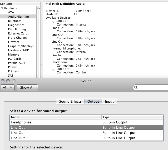

marionez Posted November 14, 2009 Author Share Posted November 14, 2009 Guys here sleep is working *without* sleepenabler... and this is not a joke /extra kext: ioahciblockstoragein“jector ahciportinjector fakesmc platformuuid smbios.plist set as (tmongkol): <key>SMproductname</key> <string>MacPro3,1</string> latest 10.6.2 applehda I've got no dsdt.aml patched (actually) No nullcpupowermanagement. Link to comment https://www.insanelymac.com/forum/topic/161430-realtek-alc1200-ich10-working-kext-on-yosemite-1010-from-106/page/12/#findComment-1330538 Share on other sites More sharing options...

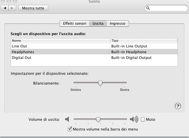

caxio Posted November 14, 2009 Share Posted November 14, 2009 big issue every time i reboot are selected headphone line and not line out, every time start the system i need select in audio preference panel line out i am only whit this issue whit latest 10.6.2 applehda? Link to comment https://www.insanelymac.com/forum/topic/161430-realtek-alc1200-ich10-working-kext-on-yosemite-1010-from-106/page/12/#findComment-1330565 Share on other sites More sharing options...
marionez Posted November 14, 2009 Author Share Posted November 14, 2009 known problem, remove audio preference file, read back this thread. never had any issue like this. Link to comment https://www.insanelymac.com/forum/topic/161430-realtek-alc1200-ich10-working-kext-on-yosemite-1010-from-106/page/12/#findComment-1330576 Share on other sites More sharing options...
caxio Posted November 14, 2009 Share Posted November 14, 2009 known problem, remove audio preference file, read back this thread.never had any issue like this. thanks but where is this file ? i need help to find exact name file to delete. thanks caxio Link to comment https://www.insanelymac.com/forum/topic/161430-realtek-alc1200-ich10-working-kext-on-yosemite-1010-from-106/page/12/#findComment-1330617 Share on other sites More sharing options...

caxio Posted November 15, 2009 Share Posted November 15, 2009 big issue every time i reboot are selected headphone line and not line out, every time start the system i need select in audio preference panel line out i am only whit this issue whit latest 10.6.2 applehda? known problem, remove audio preference file, read back this thread.never had any issue like this. fixed mistery solved ,the problem is sleepenabler for 10.6.2, i have changed sleepnabler for 10.6.2 by stellarola whit sleepebabler by netkas and now all work propely. Link to comment https://www.insanelymac.com/forum/topic/161430-realtek-alc1200-ich10-working-kext-on-yosemite-1010-from-106/page/12/#findComment-1331503 Share on other sites More sharing options...

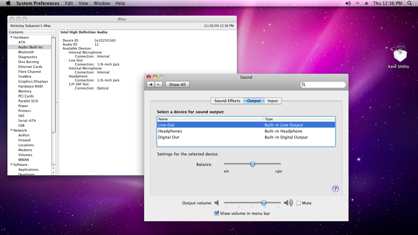

mr_Dellay Posted November 26, 2009 Share Posted November 26, 2009 Hi marionez. First of all I want to say thank you for your awesome job! You rock I have laptop acer aspire 5737z. That is what I have inside it: Multimedia: Audio Adapter nVIDIA HDMI @ nVIDIA MCP79/7A - High Definition Audio Controller Audio Adapter Realtek ALC888/1200 @ nVIDIA MCP79/7A - High Definition Audio Controller When I install your kext ALC1200_1062, all is going fine, accept during booting a got some errors. There is log of dmesg: bash-3.2# dmesg 315A10-ABB1-3E5A-9B99-C39B9DAFC3E8 Waiting on <dict ID="0"><key>IOProviderClass</key><string ID="1">IOResources</string><key>IOResourceMatch</key><string ID="2">boot-uuid-media</string></dict>netkas presents fakesmc, a kext which emulates smc device com.apple.AppleFSCompressionTypeZlib load succeeded USBF: 1.537 AppleUSBOHCI[0xffffff80093f9000]::InitializeOperationalRegisters Non-NULL hcDoneHead: 0xafef1790 Got boot device = IOService:/AppleACPIPlatformExpert/PCI0@0/AppleACPIPCI/SAT0@B/AppleMCP79AHCI/PRI0@0/IOAHCIDevice@0/AppleAHCIDiskDriver/IOAHCIBlockStorageDevice/IOBlockStorageDriver/WDC WD3200BEVT-22ZCT0 Media/IOFDiskPartitionScheme/Untitled 1@1 BSD root: disk0s1, major 14, minor 1 ApplePS2Trackpad: Synaptics TouchPad v7.2 Kernel is LP64 USBMSC Identifier (non-unique): 000000000003A6 0x3538 0x54 0x100 systemShutdown false Previous Shutdown Cause: 3 NVDANV50HAL loaded and registered. AppleBCM5701Ethernet: 0 67020a02 InitNVRam - found non-5701 with serial eeprom or unbuffered flash AppleBCM5701Ethernet: 0 0 getAdapterInfo - init/sanity check of nvram failed AppleBCM5701Ethernet: 0 0 start - getAdapterInfo failed, giving up AppleBCM5701Ethernet: 0 67020a02 InitNVRam - found non-5701 with serial eeprom or unbuffered flash AppleBCM5701Ethernet: 0 0 getAdapterInfo - init/sanity check of nvram failed AppleBCM5701Ethernet: 0 0 start - getAdapterInfo failed, giving up AppleBCM5701Ethernet: 0 0 start - Allocate Interrupt event source failed HDAEnabler: Copyright © 2008 by Kabyl HDAEnabler: 05/05/2008 Added SP-Audio support by Taruga HDAEnabler: 03/07/2009 Compiled for 32/64-bit by Taruga Waiting for DSMOS... Natit: Starting. NVinject: Setting @0,device_type=display NVinject: Setting @1,compatible=NVDA,NVMac NVinject: Setting @0,name=NVDA,Display-A NVinject: Setting NVCAP=<data not shown> NVinject: Setting device_type=NVDA,Parent NVinject: Setting rom-revision=NVinject 0.2.2 irbis NVinject: Setting NVPM=<data not shown> NVinject: Setting @1,name=NVDA,Display-B NVinject: Setting @0,compatible=NVDA,NVMac NVinject: Setting @1,device_type=display NVinject: Setting model=Graphics by NVIDIA NVinject: Setting name=display disk2: ioctl(_IOWR,'d',101,24) is unsupported. Sound assertion ""ERROR: EFI ROM did not publish 'hda-gfx' associative property!\\n"" failed in "/SourceCache/AppleHDA/AppleHDA-179.1.4/AppleHDA/AppleHDACodecGeneric.cpp" at line 331 goto ExitError Sound assertion ""ERROR: EFI ROM did not publish 'hda-gfx' associative property!\\n"" failed in "/SourceCache/AppleHDA/AppleHDA-179.1.4/AppleHDA/AppleHDACodecGeneric.cpp" at line 331 goto ExitError Sound assertion ""ERROR: EFI ROM did not publish 'hda-gfx' associative property!\\n"" failed in "/SourceCache/AppleHDA/AppleHDA-179.1.4/AppleHDA/AppleHDACodecGeneric.cpp" at line 331 goto ExitError DSMOS has arrived Natit: Starting. NVinject: Setting @0,device_type=display NVinject: Setting @1,compatible=NVDA,NVMac NVinject: Setting @0,name=NVDA,Display-A NVinject: Setting NVCAP=<data not shown> NVinject: Setting device_type=NVDA,Parent NVinject: Setting rom-revision=NVinject 0.2.2 irbis NVinject: Setting NVPM=<data not shown> NVinject: Setting @1,name=NVDA,Display-B NVinject: Setting @0,compatible=NVDA,NVMac NVinject: Setting @1,device_type=display NVinject: Setting model=Graphics by NVIDIA NVinject: Setting name=display ACPI_SMC_PlatformPlugin::start - waitForService(resourceMatching(AppleIntelCPUPowerManagement) timed out FakeSMC: key not found BEMB, length - 1 SAM Multimedia: READ or WRITE failed, SENSE_KEY = 0x03, ASC = 0x11, ASCQ = 0x05 NTFS driver 3.1 [Flags: R/W]. NTFS volume name Data, version 3.1. Sound assertion "0 != result" failed in "/SourceCache/AppleHDA/AppleHDA-179.1.4/AppleHDA/AppleHDAWidget.cpp" at line 3641 goto handler Sound assertion "0 != widget->setUnsolicited ( true )" failed in "/SourceCache/AppleHDA/AppleHDA-179.1.4/AppleHDA/AppleHDACodecGeneric.cpp" at line 989 goto handler SAM Multimedia: READ or WRITE failed, SENSE_KEY = 0x03, ASC = 0x11, ASCQ = 0x05 disk2s0: I/O error. bash-3.2 So after that in system profile I can see that my sound card found and working well (see attach) , but I do not have sound. Can you please tell me, what should i do to get sound. ps I was testing older versions of your kexkt, and some kext for alc888, but no luck. Hardware is founded by system, but sound don't work. Link to comment https://www.insanelymac.com/forum/topic/161430-realtek-alc1200-ich10-working-kext-on-yosemite-1010-from-106/page/12/#findComment-1342882 Share on other sites More sharing options...
