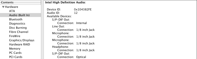

This is how looks like About this mac:
You're lucky,
enjoy it!!

Oh sorry there is an issue
from my P5Q-Pro mobo, it comes with the coaxial SPDIF output so, it is not a optical digital output. So I can;t get the digital out functioning as the kext I guess was being modified to with optical output, is that any chance to create a version that suit for ALC2000 with coaxial digital output interface?
thanks
