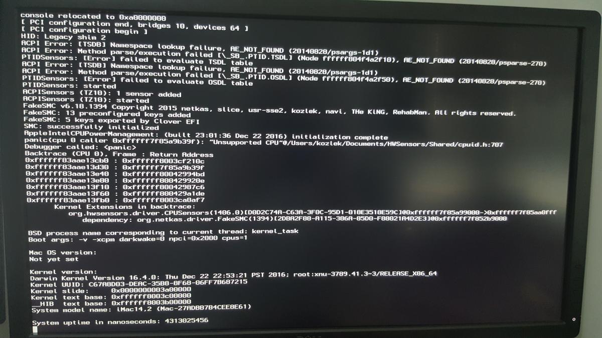

To get my X299 rig to work I had to delete the plugins from fakesmc.
I'd love them back! I feel the need to keep tabs on this cpu as it can pull 300 watts at full load.
Is there any way I can help you guys with data to get it going?
This might be the first clue - a pic from a kernel panic before I deleted the plugins.
Thanks :)
Thanks :)
I think you are seeing this because CPUSensors.kext has no definition for you CPU yet. It is so new that hasn't been added. Try including the other kexts but not CPUSensors. This is the price of getting latest hardware haha. Just wait a little for the community to develop new kexts.

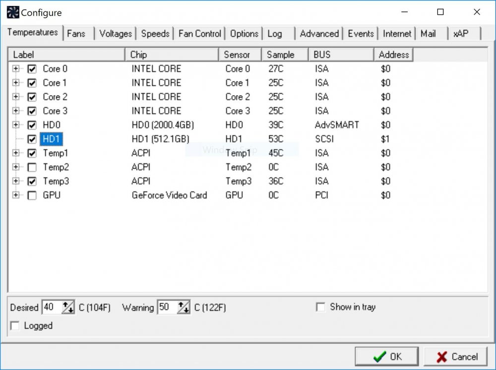

My SSD drive has a temperature sensor that is not being recognized in macOS but it is recognized in Windows 10 with the app Speedfan.  Any idea how to pick up the temperature sensor for the SSD in HWMonitor?  The SSD runs much cooler in Windows than macOS and I think it is due to the fact that its temperature is not being detected.  Thanks.

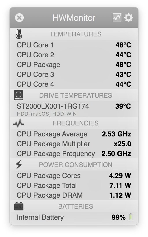

I'm using HWmonitor and FakeSMC from the above dmg, FakeSMC is in S/L/E. I'm seeing GPU temperature but not frequency. Any idea what might be the problem?
RX560 and Gigabyte GA-Z270N-WIFI
According to this commit, RX560 is one of supported cards. Just not sure what monitoring features are supported though. You may consider using Slice's FakeSMC instead?
Edited by Badruzeus
Thanks for that, didn't know Slice had forked this. :)
Same problem though, only GPU temperature but no frequency. Anyone know if I should see the frequency on RX 560 ITX?
Add this to the Terminal window, but note that it's static, if you want to see the frequencies at full load, run it again.
ioreg -l |grep \"PerformanceStatistics\" | tr ',' '\n'|grep 'Clock'
That doesn't do anything :/
It does not work if you just copy and paste it, here it's as code.
