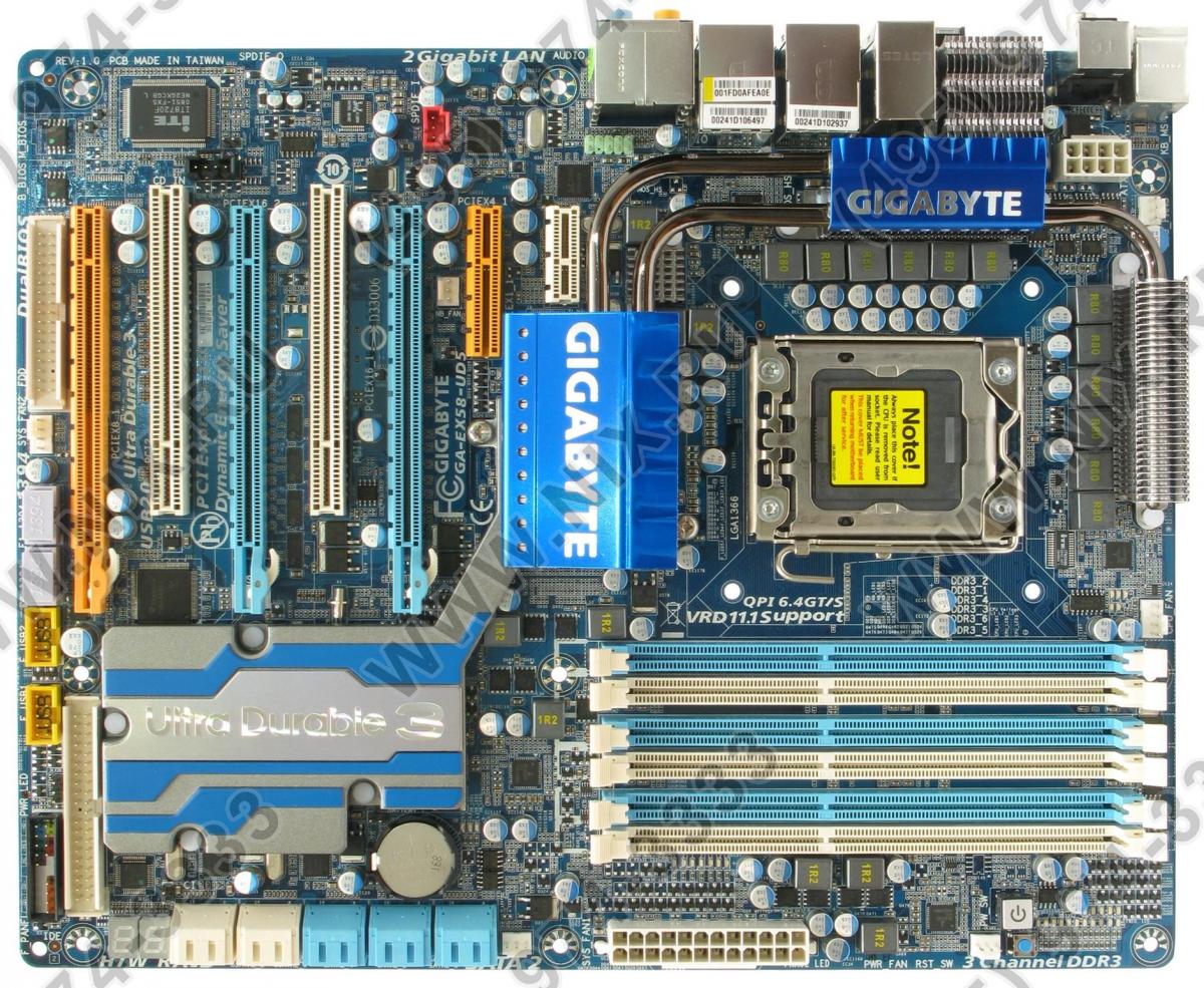

Hi, I'm after a bit of help getting fans and voltages reading correctly.
I'm using a Gigabyte EX58-UD5 which has an ITE it8720f SMC IC, shown top left in this photo:

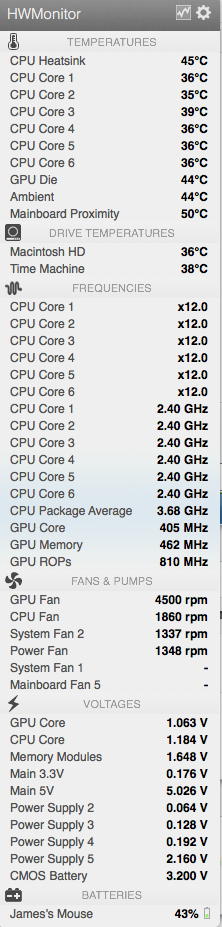

This is what I'm starting with:
I'm using FakeSMC v6.23.1417 with CPUSensors, GPUSensors and LPCSensors
Fans:
What I would like is to move and rename the labels shown:
GPU Fan @ ~ 4500rpm should be 'Water Pump', this is on the CPU FAN header
CPU Fan @ ~ 1750rpm is my 'Rear Case Fans' connected to SYS FAN 2 (2 fans on a Y cable to PWM header)
System Power Fan 2 @ ~ 1337rpm is my 'Upper Case Fan' connected to SYS FAN 1
Power Fan @ ~ 1348 rpm is my 'Lower Case Fan' connected to PWR FAN (correct)
I don't have a GPU fan as I'm water cooled
Voltages:
GPU Core (correct)
CPU Core (correct)
Memory Modules (correct)
Main 3.3V - Completely wrong
Main 5V (correct)
Power Supply 2-5 - no idea what these should be
CMOS Battery (correct)

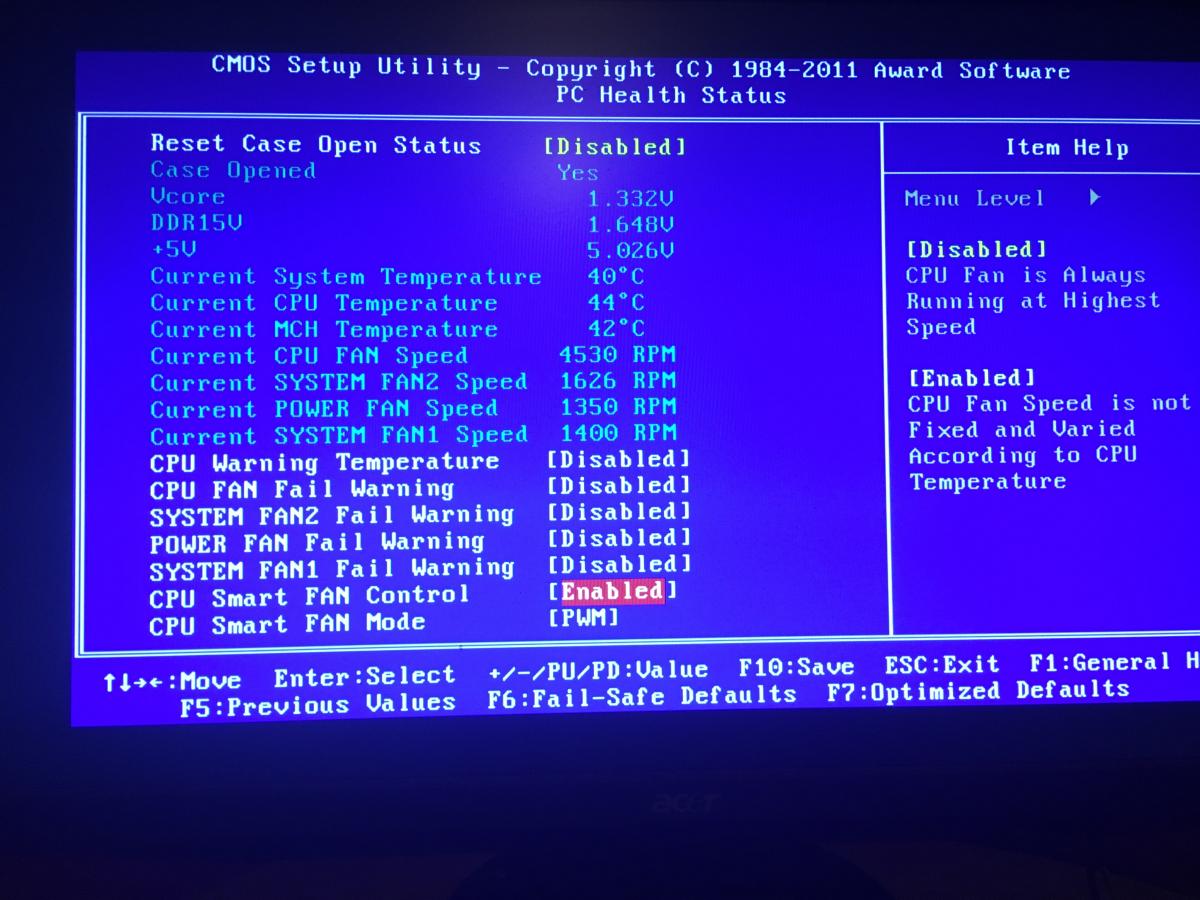

Here are my voltages and fan speeds shown in BIOS:
Any help would be appreciated
