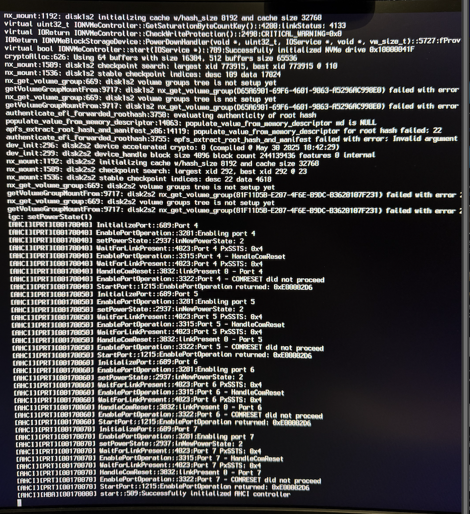

@eSaF This is what my drive looks like but I just can't get it to complete
image.png.8003fc912c392e22aa327d4f4eab6e71.pngimage.png.d8068fc53db0517fa5f8f63b0ce8fe3c.png

Tried a fresh install via usb and get stuck here. I give up now and going to sleep. over 9 hours straight and getting nowhere slowly. In the Z790 EFI, all usb kexts are disabled and SSDT.UIAC is in ACPI so not sure what that is.

Not sure if you read my previous message from last page or so. I'm having the exact same issue. The error is above that point. By that point, the computer is already preparing to reboot.
There are a couple of lines that drew my attention from my log. But I didn't have time to investigate too much, and since I can boot Sequoia perfectly fine with the same config and EFI files, I'm thinking the issue is probably specific to Tahoe. So far, I have no solution to that.
entering _ramrod_device_has_usbcretimer
Failed to create DT nodes for IODeviceTree...
And then:
No port micro restart (we don't support SMC on this platform).
You could try to boot with your iGPU, if it's configured, and see if that makes a difference. But so far, I had no success and my iGPU is currently set in "headless" mode. So I don't wanna spend time trying to get that to work, since I will never use it this way.

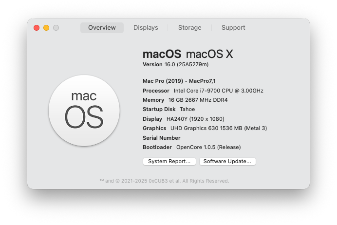

I tried to boot mine with that EFI  (  macPro7.1 😆  )  and it works, I just removed "agdpmod=pikera" ... I didn't touch anything else
