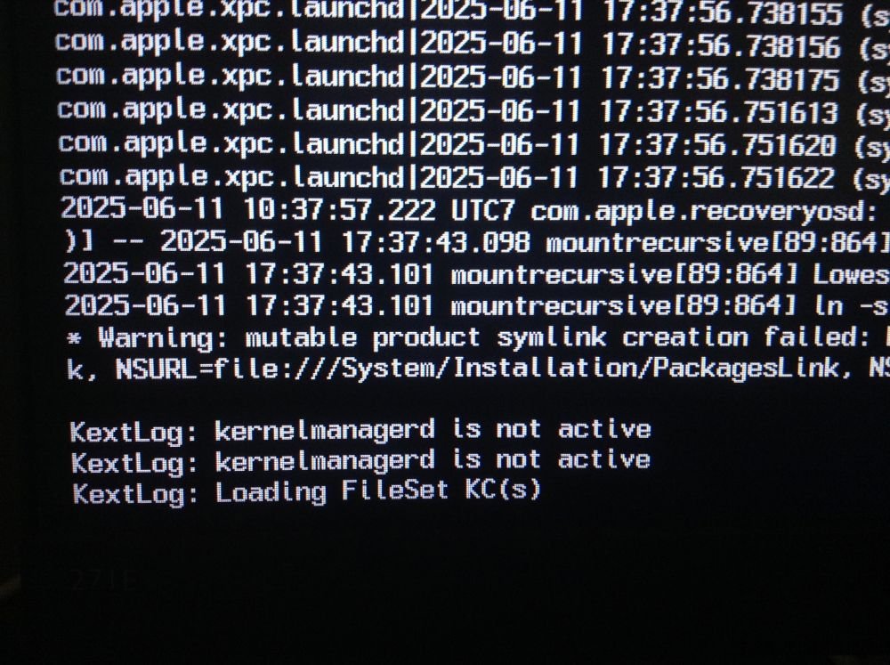

bluenote56 Posted June 11, 2025 Share Posted June 11, 2025 12 minutes ago, eSaF said: That is it, hate to admit defeat but I think I have exhausted every avenue I could think of to install Tahoe and get a result. I just cannot get past 'KextLog: Loading FileSet KC (s)', no matter what I change or alter in the config.plist. Yes I am cleaning the NvRAM after each change but to no avail. I am destined to either stop at Sequoia, wait for the next Update which I feel will bring no relief to my pain or just open my purse strings and throw some money at the Apple Store. I have done more boot ups and re-boots than a Windows Vista machine, at least there was a valid excuse for that debacle. This Tahoe specimen I am not too sure about on my machine. I don't know if anyone here goes fishing in the sea. I do or at least I did. Well it happens that fishes sometimes make fun of you (I'm sure they laugh) . It seems you have caught them and you get any kind of garbage instead. You get exited pulling the fishing line but ending with people around you hiding their giggling. But you don't give up till it's too late and you must go home. Now after countless attempts it's time to go home .. for now.. and start again to avoid destroying your hackintosh giggling. At least we must not see wife's face when she says " Oh my God how many fishes you got! I must invite our neighbours for dinner." Link to comment https://www.insanelymac.com/forum/topic/361162-pre-release-macos-tahoe/page/11/#findComment-2833199 Share on other sites More sharing options...

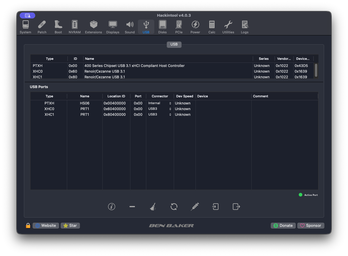

mashuk12 Posted June 11, 2025 Share Posted June 11, 2025 6 minutes ago, surenmunoo said: Create it from Hackintool. In the USB section, the last icon at the bottom right is export, it will export the SSDT.UIAC.aml here showing only 3 ports Link to comment https://www.insanelymac.com/forum/topic/361162-pre-release-macos-tahoe/page/11/#findComment-2833200 Share on other sites More sharing options...

surenmunoo Posted June 11, 2025 Share Posted June 11, 2025 9 minutes ago, mashuk12 said: here showing only 3 ports Then you don't have your USB's mapped properly. Do that first then extract the SSDT 36 minutes ago, eSaF said: That is it, hate to admit defeat but I think I have exhausted every avenue I could think of to install Tahoe and get a result. I just cannot get past 'KextLog: Loading FileSet KC (s)', no matter what I change or alter in the config.plist. Yes I am cleaning the NvRAM after each change but to no avail. I am destined to either stop at Sequoia, wait for the next Update which I feel will bring no relief to my pain or just open my purse strings and throw some money at the Apple Store. I have done more boot ups and re-boots than a Windows Vista machine, at least there was a valid excuse for that debacle. This Tahoe specimen I am not too sure about on my machine. I am in the same boat as you buddy. No matter what I have tried, not working. I am going to try on the Z790 machine this weekend and install it there and transplant the SSD. This is the only way I can remain SANE 🤪 Link to comment https://www.insanelymac.com/forum/topic/361162-pre-release-macos-tahoe/page/11/#findComment-2833204 Share on other sites More sharing options...

jm26200 Posted June 11, 2025 Share Posted June 11, 2025 1 hour ago, eSaF said: That is it, hate to admit defeat but I think I have exhausted every avenue I could think of to install Tahoe and get a result. I just cannot get past 'KextLog: Loading FileSet KC (s)', no matter what I change or alter in the config.plist. Yes I am cleaning the NvRAM after each change but to no avail. I am destined to either stop at Sequoia, wait for the next Update which I feel will bring no relief to my pain or just open my purse strings and throw some money at the Apple Store. I have done more boot ups and re-boots than a Windows Vista machine, at least there was a valid excuse for that debacle. This Tahoe specimen I am not too sure about on my machine. Yes, I'm like you, I'll stop there because I also think I've exhausted all my resources. Regards eyes also tired cut all and go shower before sleep Link to comment https://www.insanelymac.com/forum/topic/361162-pre-release-macos-tahoe/page/11/#findComment-2833208 Share on other sites More sharing options...
mnfesq Posted June 11, 2025 Share Posted June 11, 2025 10 hours ago, eSaF said: Ok newly built USB Installer and this is the result!!!! What more can this frustrated man do to overcome this.? EFI.zip 5.04 MB · 27 downloads IMG_1396.HEIC 3.1 MB · 35 downloads Everyone is reporting that USB needs to be redone with an SSDT-UIAC.aml file. I also needed to use an SSDT-XHC.aml file. Why you would try to use a USB installer given that information perplexes me. What I did was add a separate OC-Tahoe folder to my EFI and use my UEFI interface to select the OpenCore.efi in the OC-Tahoe folder. I also use the boot file selector that is packaged with Clover -- it is a BOOT.efi file that is placed in the BOOT folder in EFI. I can't guarantee that this will solve your problem but it seems like you are adding an unnecessary additional level of complexity by introducing USB functionality in the installation process. This suggestion is offered with the deepest compassion for your frustration. Link to comment https://www.insanelymac.com/forum/topic/361162-pre-release-macos-tahoe/page/11/#findComment-2833209 Share on other sites More sharing options...

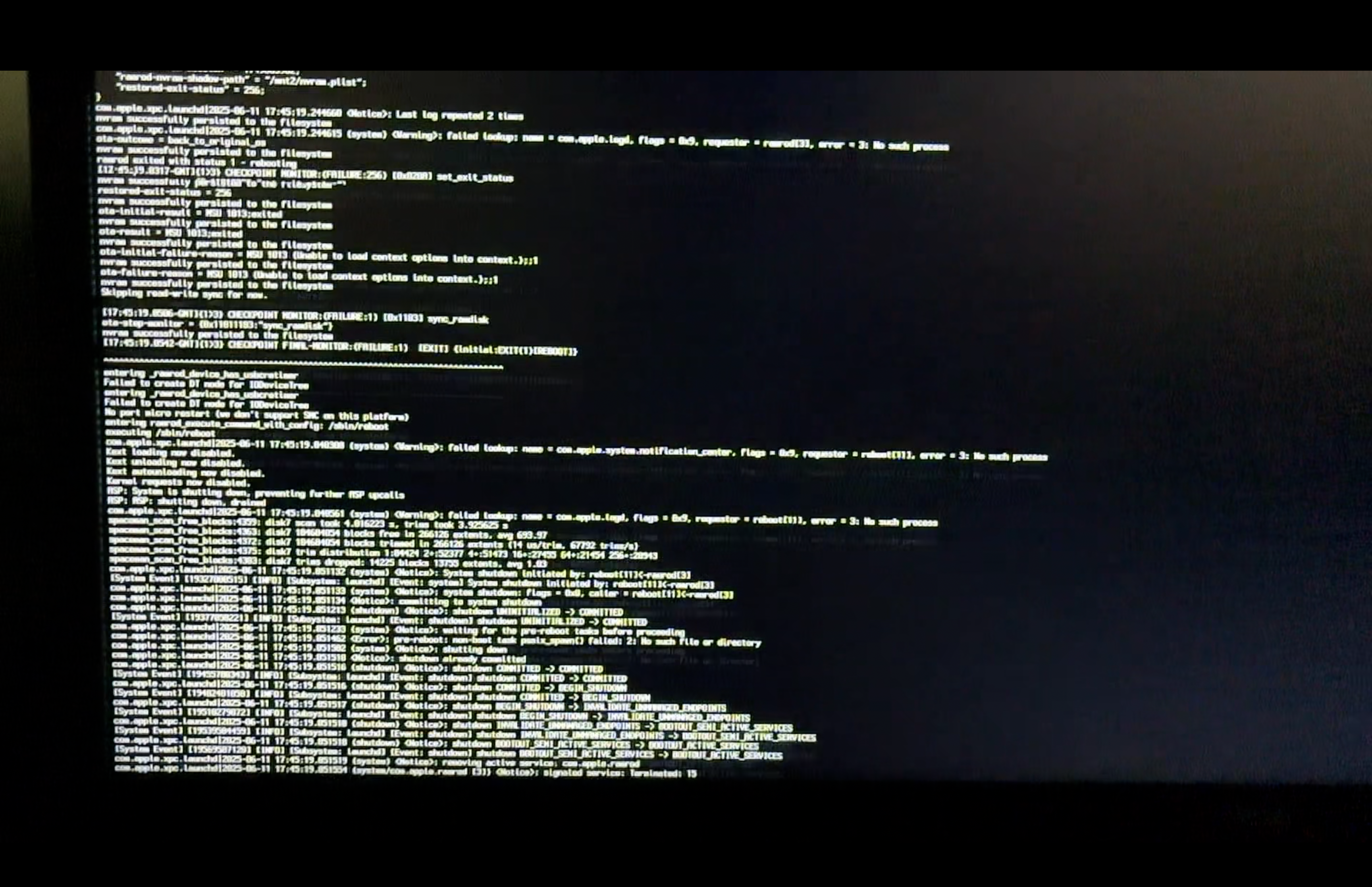

arsradu Posted June 11, 2025 Share Posted June 11, 2025 (edited) Yeah, after digging a little more, looks like it's going through some checkpoints, and after that, it says something like: entering _ramrod_device_has_usbcretimer Failed to create DT nodes for IODeviceTree... And then: No port micro restart (we don't support SMC on this platform). After that it goes into restart, and it's back to square one. I've checked SecureBootModel and it's set to Default, in case that makes a difference. The fact that I can boot Sequoia perfectly with this config makes me think whatever the issue is, it's probably specific to Tahoe. So...for now, I'm stuck as well. Edited June 11, 2025 by arsradu Link to comment https://www.insanelymac.com/forum/topic/361162-pre-release-macos-tahoe/page/11/#findComment-2833214 Share on other sites More sharing options...
