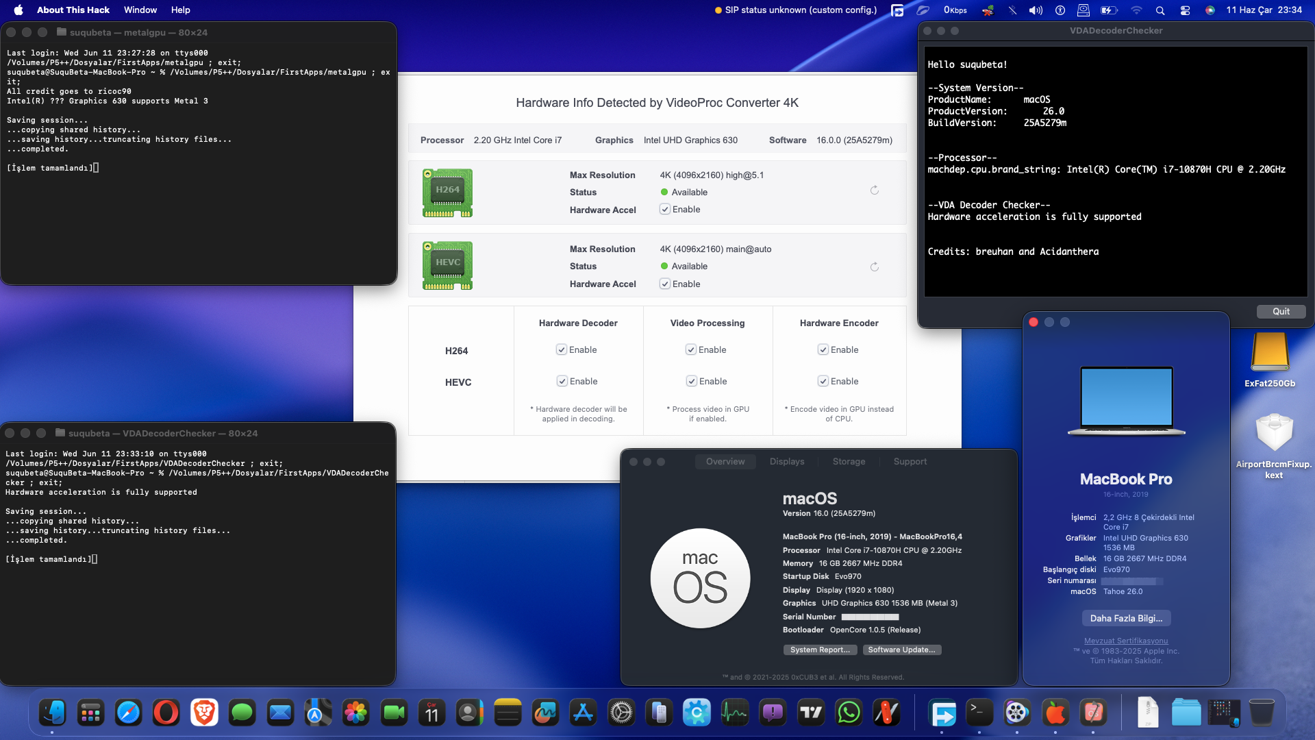

SMBIOS: The MacBook Pro (16-inch, 2019)
macOS Tahoe incremental update has been completed successfully.
The process progressed as follows;
1. EFI working with macOS 15.5 has been updated with the appropriate Opencore files. https://github.com/acidanthera/OpenCorePkg/actions/runs/15582120450
2. OCLP Revert Patch. Config file has been edited.
    a. The SSDT-UIAC.aml file was compiled and processed into the config file.
    b. Bluetoolfixup kext disabled
    c. VoodooI2C kexts have been disabled. (Because the system is locked)
4. The system has been restarted.
5. System updated with Asus USB-AC53 Nano Wireless Network Adapter.
6. Bluetoolfixup kext has been enabled in the config file.
System problems;
1. Wifi could not be activated because OCLP operation could not be performed. Bluetooth is working.
2. Asus USB-AC53 Nano Wireless Network Adapter could not be run. RtWlanU1827 and RtWlanU kexts cannot be uploaded to the system. I used lilubetaall. @chris1111
Edited by HyperX7
  • Like 5

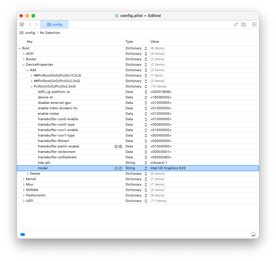

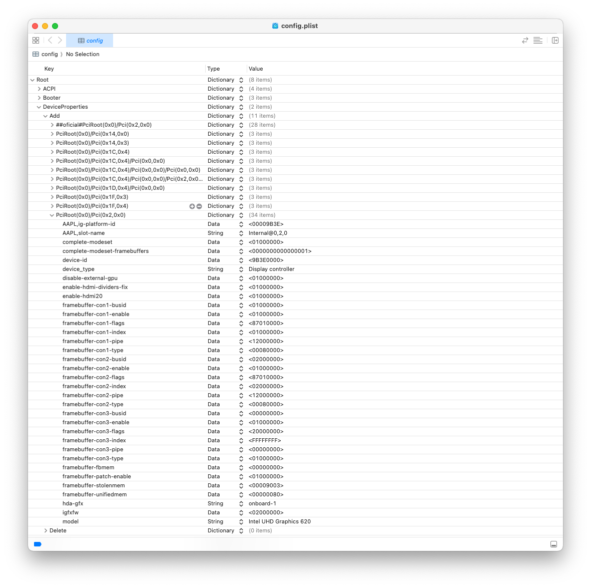

@chris1111 I believe that could be, because that base is HD 620 (Kaby Lake), and works fine on Comet Lake-U UHD 620.
Basic Framebuffer ID <00001B59> Works on Kaby-Lake and for base install on Comet-Lake-U 10ª Gen
Advanced Frambuffer ID <00009B3E>
Basic Frambuffer for Comet-Lake-U (only) created by @MaLd0n :)

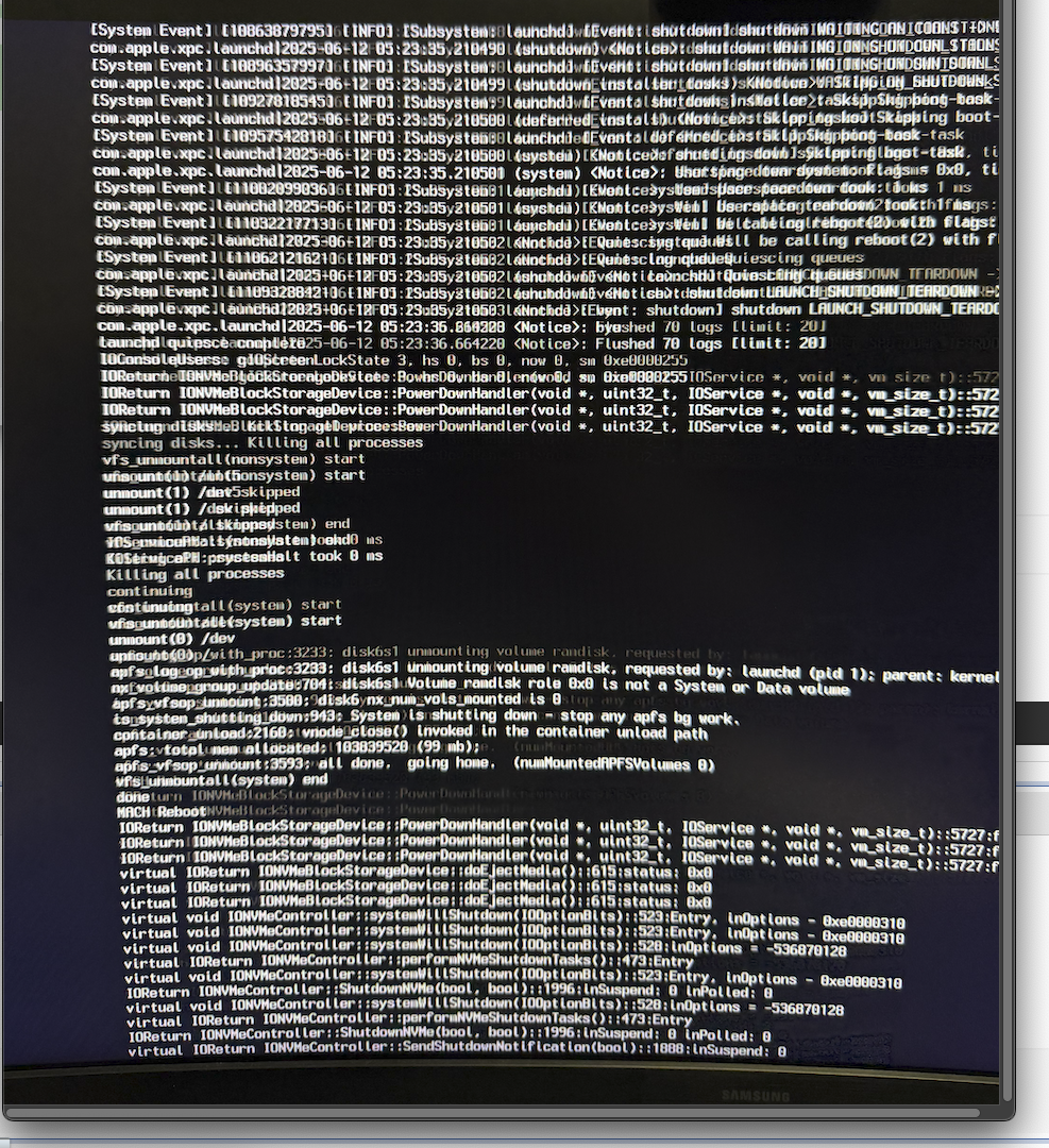

34 minutes ago, surenmunoo said:
Arrrrrggggg I moved my RX6800Xt and SSD to the Asus Z790 machine, created a new EFI and still cannot get this thing going.  It comes to this stage and reboots constantly, no further progress. Who knows what it means on this image?
Spoiler
You using SSD or NVME?, because:
IONVMeBlockStorageDevice::PowerDownHandler suggest problems with NVMe SSD communication.
APFS Volume Errors: Messages about APFS volumes not unmounting properly indicate filesystem issues.
I guess you using NVMeFix.kext?
The weirdest thing is that the logs show macOS attempting to shut down during installation, which shouldn't normally happen.
I'm far from someone who can read the logs but some parts I can understand :)
Yes, I am using NVME and the nvme.kext. This is what was happening when I was trying an upgrade method. Busy creating a bootable usb now to try. Fingers crossed.
