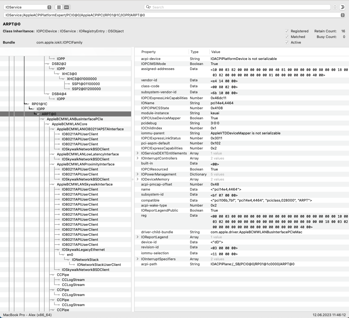

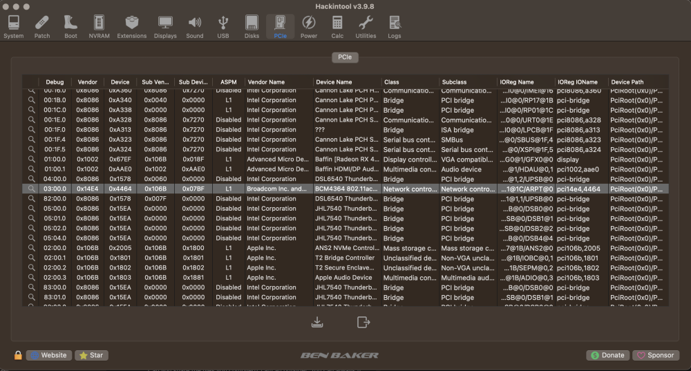

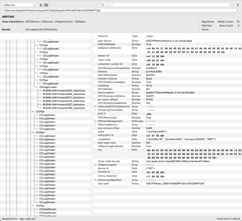

Sonoma is supposed to support 2019 iMac which should be 19,1 and according to AppleLife.ru dumps uses a Broadcom BCM4360 which is 14e4:07bf not 14e4:4464 which uses 80211FamilyV2. I can’t check until tomorrow but if spoofing 07bf doesn’t work that just means the kext is being reworked and wasn’t ready not that they forgot it or removed it. Unless 19,1 isn’t going to be supported. I can’t check 20,1 either right now, can someone else?
  • Thanks 1
