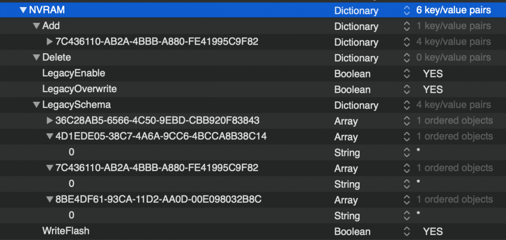

3 hours ago, Rodion2010 said:
Thanks for the config.plist.
I tried your NVRAM section (with blank 36C28AB5-6566-4C50-9EBD-CBB920F83843):
1304677680_Screenshot2020-06-18at15_13_50.thumb.png.8820c8a05913bacd84d46d22a188dbab.png
But same problem. No 8BE4DF61-93CA-11D2-AA0D-00E098032B8C variable in the NVRAM.
what is responsible for writing that Var into the NVRAM ?
BTW, if I write nvram Test=Hello command and reboot, then it is visible after reboot. Which implies that basic emulation is working but just not OC boot selection.
Edited by MacNB

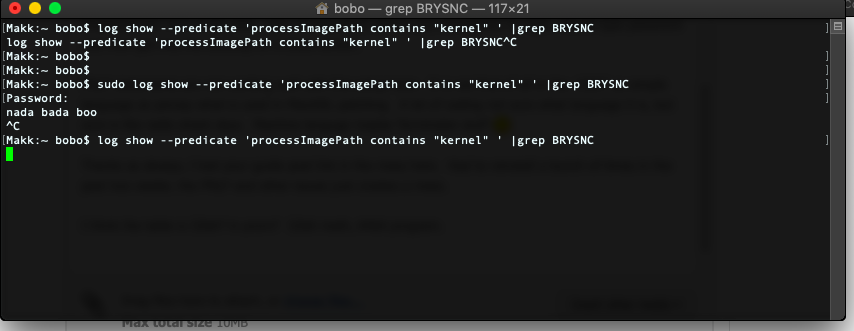

perhaps try this simplified PNLF definitiion (attached) - works on my SNB system - which is using the same OS and kexts as you. (dosdude1 gfx from highsierra) and WhatEvergreen.kext
DualLink is needed with higher res LCD screens such as 1600x900 (DualLink=1) vs 1366.x768 (DualLink=0)
what does this mean "after some time locks up"?
does the gfx freeze and mouse still move?
in your system log are you seeing BRSYNC warnings
 - if so, this is a common issue with HD 3000 and not having a compatible EDID.
run this to check:
log show --predicate 'processImagePath contains "kernel" ' |grep BRYSNC
SSDT-PNLF-SNB.zip

Greetings tluck,
Yes mouse keyboard> caps lock an num lock flip on and off.  screen no go.
I used the log show and nill.  nothing came up.
I used Rehabman patch Generic EDID into DSDT seems to work better in there rather than from DisplayVendor and config.plist.  was causing black screen and sometimes no login. Would type password  and then got into the desktop on a black screen.
PNLF statements are not working well with this setup here.  It is not first of all in the  DSDT as simple language as persay what is used in MaciASL patching.  A lot of coding not sure what language it is, but sure is like radio shack days.  Machine languge maybe Terminator stuff ;)
Thanks as always, I lost your guide post link in the mess here.  Had to reinstall a bunch of times in the past two weeks. the PNLF and other issues just creates a mess.
