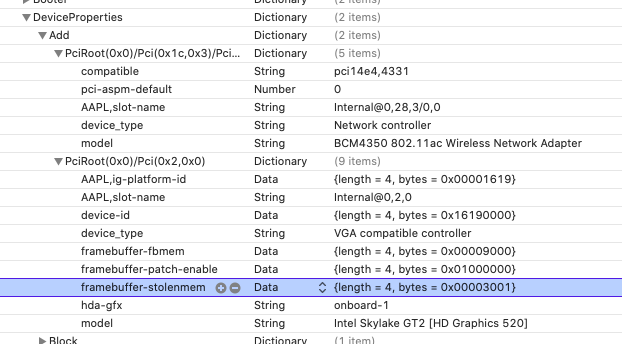

I checked some config.plist examples for Open Core and I see people are specifying in the config.plist file what EFI drivers and KEXTs they are using, is this mandatory or can I just copy the EFI files and KEXTs to their respective directory and skip specifying them manually i config.plist?
For OpenCore Kexts, drivers and tools need to be in config.plist and in the correct order.

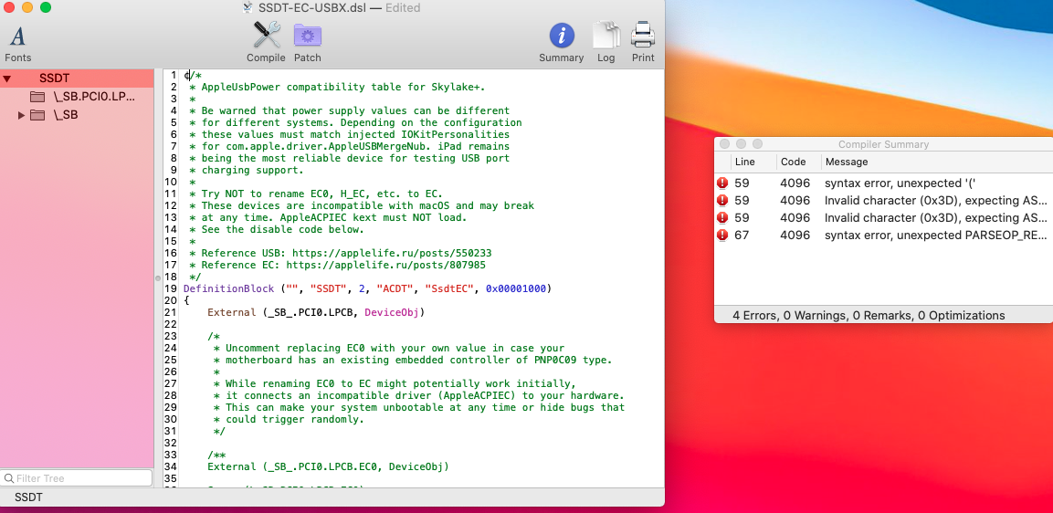

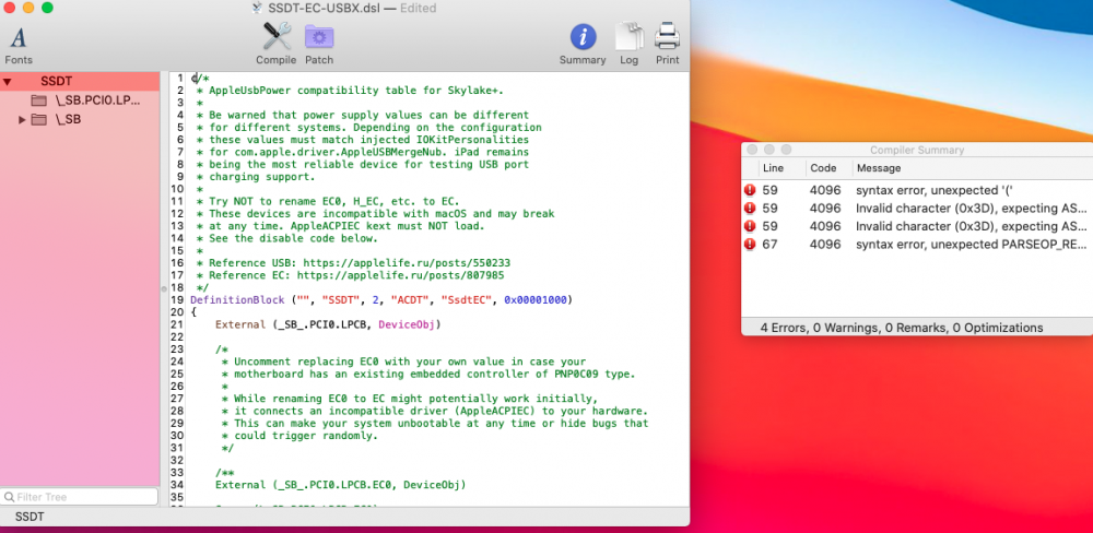

Hi all, today I tried to build new SSDTS from the OpenCore 0.6.0 that I downloaded and it gives me this errors, anyone knows why ?
Solved it was the MacIASL that was bad...

Hello OpenCore experts,
 I really need help on this crazy problem.
1. I bought a cheap $20 dw1820a for my Elitebook 820 G3 to try out since dw1560 is too high, although I could afford it but I want something different. The Clover won't see the Wifi but the OpenCore would with both BT hand off and wifi full speed.
2. The problem is I can't boot with patched DSDT for my battery to show up, it will go to a black screen after everything is done and hang. I could boot and everything works perfectly with sleep/wake without DSDT at all (with those acpi errors displays) but NO battery showing since I couldn't patch it. It looks like the PNLF wasn't working with the backlight, at night I could see the apple logo extremely dim and the bar, but stuck there.
Fixed it: The problem was using the DSDT & SSDTs extracted from rweverything (10 SSDTs), use Clover to extract DSDT and SSDTs (8), disassembled and patched - use all SSDTs (8), SSDT power from SSDT pike Alpha generation.
https://www.youtube.com/watch?v=46hanWDwZLA
3. My question is why it works with native DSDT and not patched one? Attached is my config file.
4. If I can't solve this, I would be ok with the current config but is there anyway for the SMCBattery to display native battery with some kind of on the fly patching?
Thanks,
Louis
configdw1820anosn.plist.zip
Edited by ltooz_audis
fixed the problem

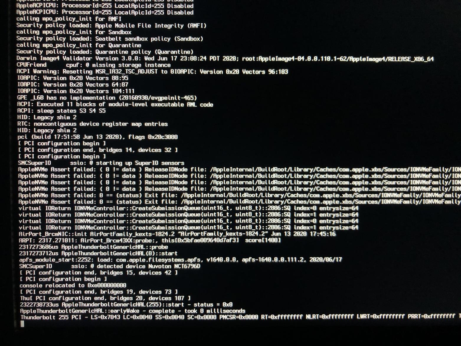

- recently OC 0.6.0 was stuck at here and my Logitech G512 and G1 LED won't initialized. (turn off that LED, this meant not initialized)
- same stuck point when i inject USBports.kext or USBInjectAll.kext.
- also USBports.kext was sort out under 15ports.
- but this Big Sur OC bootloader is possible to boot for Catalina 10.15.5 perfectly.
also i tried ncpi=0x2000, npci=0x3000 option but still looks that.
ASUS X299 TUF mark 1
RX5700XT
+ i will gonna test a ubuntu kvm or proxmox system with this big sur pre-installed disk and this oc setting on.
including a Debug log and APIC files. (there's no Panic log because of it doesn't Panic spot)
opencore-2020-06-26-003255.txt
ASUS X299 TUF mark 1 - APIC.dsl
Edited by zisqo

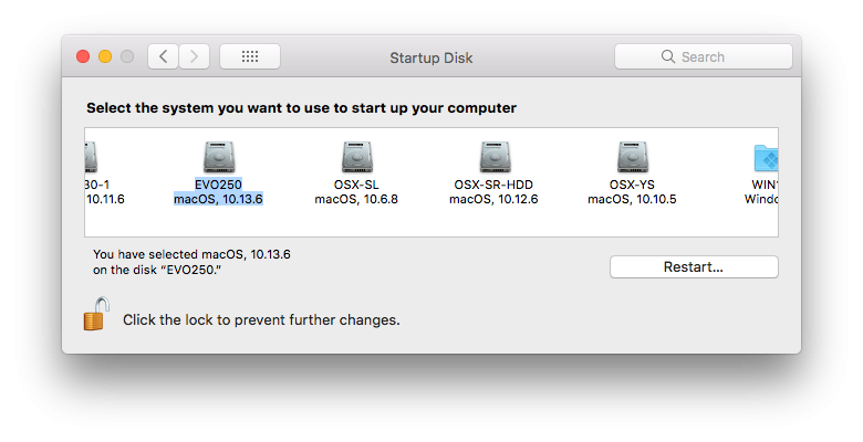

13 hours ago, MacNB said:
That's a shame. That means we will need to enable the bootpicker just before we do a macOS update and lookout for the Installer in the menu list so that it can be selected (as that's a guaranteed way of being able to make a selection). Ah well if there's no solution, so be it. In which case, it would be good to mention the limitation in the Configuration.pdf
I had already tested the original logouthook command and Startup Disk from system preferences as I reported before. It does not work. I tried it again with the original command and I can confirm does not work. Neither does CTRL+ENTER (as you said). So there's still a problem.
With the modified logouthook command, CTRL+ENTER works but selection via Startup Disk from system preferences does not work (I just tried it again).
Thanks for the attention to fix this problem.
Could you provide the dumps with Startup Disk and the original script?
Hi @vit9696 Please see attached Log, Config & screenshots.
I put the original logouthook script back.
This is what I selected from Sys Pref:
On Reboot, OC boot picker shows (Entry 1 as Default instead of 3):
(Yes, I do have two Windows partitions).
I selected Entry 3 and pressed ENTER to boot the OS.
Log shows the same issue:
01:560 00:003 OCB: MacNB: InternalGetBootOptionData: FilePathListSize (154) > LoadOptionSize (92) so Returning NULL
01:562 00:002 OCB: 0 -> Boot0080 - failed to read
Thanks.
MacNB-opencore-2020-06-26-100826.txt
MacNB-config-3.plist
Edited by MacNB
On 6/24/2020 at 11:18 AM, MacNB said:
@vit9696 I assume Duet is the latest as I assumed it is now included with OC. I just did a git pull and ran the build_oc.tool on the 19th June.
I noticed the 0 -> Boot0080 - failed to read so I added the extra DEBUG_INFO to see why and it shows FilePathListSize (154) > LoadOptionSize (92) so Returning NULL
LogoutHook.command 2.zip
try this version
try this version
Thanks @Rodion2010
I tried your script. Same result as @vit9696's modified version.
That is, when using Startup Disk from System Pref to set the default, it does not work. Boot picker shows entry 1.
When in boot picker, if I select the OS and hit CTRL+ENTER, then it remembers this as default.
See two logs attached - one for Startup Disk selection and the other for CTRL+ENTER selection.
After using CTRL+ENTER, OC always boots the selected Default Entry but there's an interesting line in the log which still shows DEF:0
12:370 10:002 OCB: Should boot from 3. EVO250 (T:2|F:0|G:0|E:0|DEF:0)
 Thanks for your help.
MacNB-STARTUP-DISK-opencore-2020-06-26-152917.txt
MacNB-CRTL-ENTER2-opencore-2020-06-26-153608.txt
