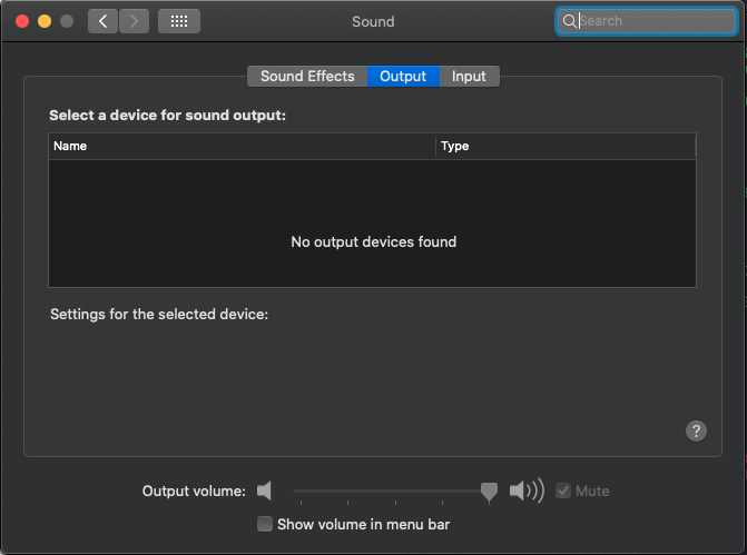

Greetings Vit,
I use the SSDT-PNLF.aml that comes wth Whatevergreen and place it in  ACPI folder.
on boot up, the message flashes across the screen:
ACPI Warning: 64 bit constant found in 32 bit table -> ( bunch information then the number associated with the problem)  dsobject - 832
Rehabman has a post at tonymac site about these types of issues.
https://www.tonymacx86.com/threads/solved-boot-problems-with-high-sierra.248266/page-2
He suggested that ACPI table is out of sync with the compiled and hacked ones and to repatch and recomplie.  I did this for all my ACPI .aml files. and inserted them one at a time to see which one is causing the problem.
DSDT.aml + SSDT-PNLF. aml creates this problem.
When I read the header portion the DSDT it says, 32bit ; no 64 bit math
I assume that the SSDT-PNFL.aml is 64bit and because this laptop's table is probably where the DSDT is, is 32bit table?  not sure.
So I have tried without DSDT and leaving the SSDT-PNLF, all the other SSDTs and booting up.
I got no audio doing this way.  Previously I did have audio without DSDT. But now cannot get audio at all.  AppleALC.kext.  I've tried several thing.

@makk, SSDT-PNLF is unrelated here. And "64-bit" here has nothing to do to 64-bit, it is just that some address calculation overflowed and changed sign. What it likely means is that your DSDT that apparently needs reextraction and/or region fixup (there is a quirk for it). However you approach this, make sure that you extract DSDT via SysReport functionality.

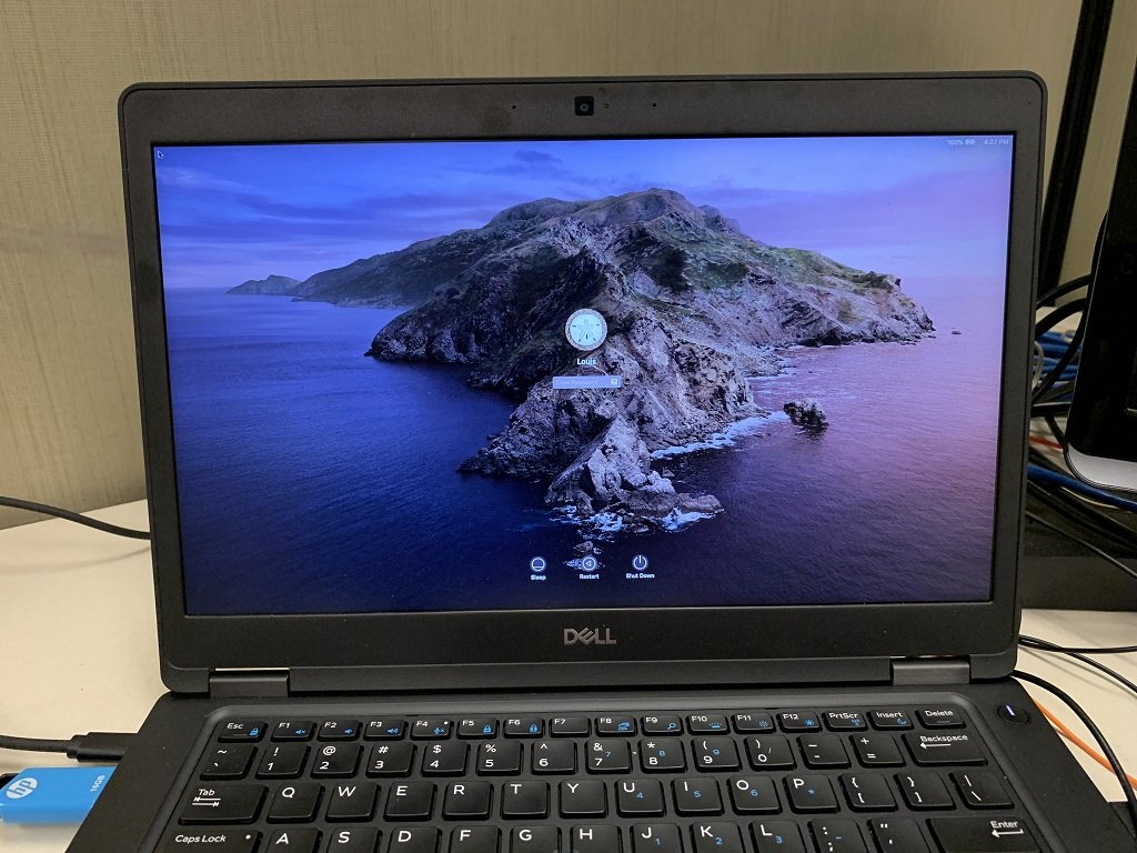

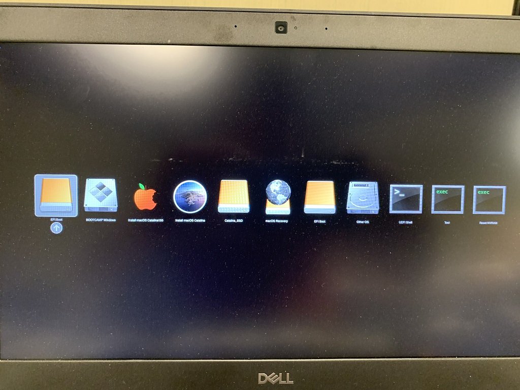

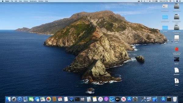

OK, I just hacked Dell Latitude i7-8650u with 0.5.9, works perfectly, one problem I've seen so far with NVME internal hard drive, OpenCore can see it, but can't install. On this laptop, I can't even see the Windows partition. The NVME USB external hard drive I can boot catalina 15.5+. Is there a problem with laptop internal hard drive NVME?z_dell_no_nvme_internal.jpg.6b4102dbdf867409ae31e03ea7499a34.jpgz_dell_hd620.jpg.ce1eb2900a4187e22f6d676384255aab.jpgz_dell_alc256.jpg.951ca4e5c9adaad5fac5b15f6c464bd6.jpgz_dell_alc256.jpg.951ca4e5c9adaad5fac5b15f6c464bd6.jpgz_dell_hd620.jpg.ce1eb2900a4187e22f6d676384255aab.jpgz_dell_no_nvme_internal.jpg.6b4102dbdf867409ae31e03ea7499a34.jpg

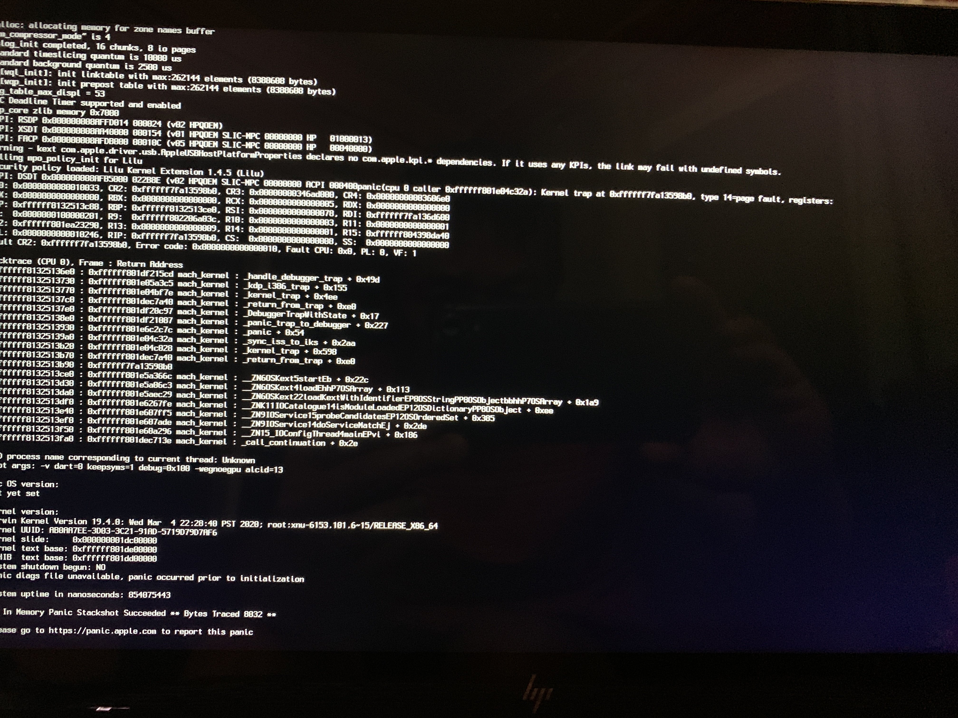

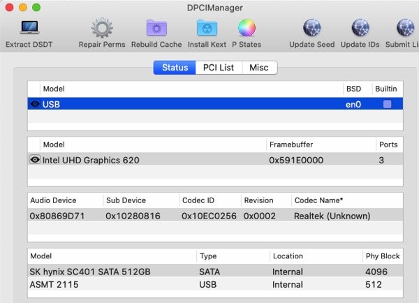

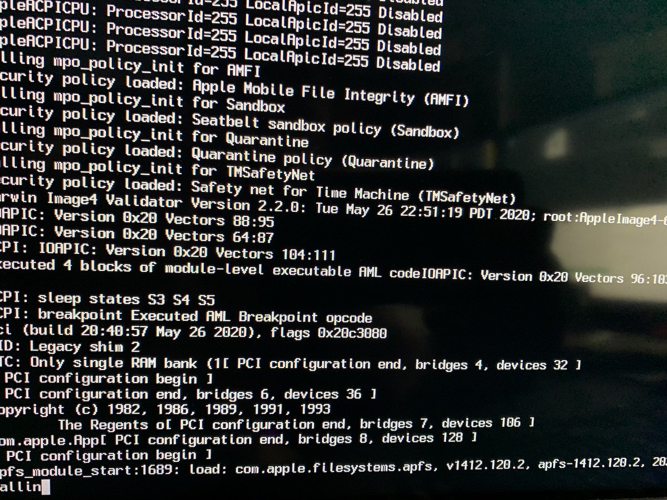

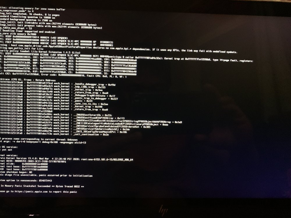

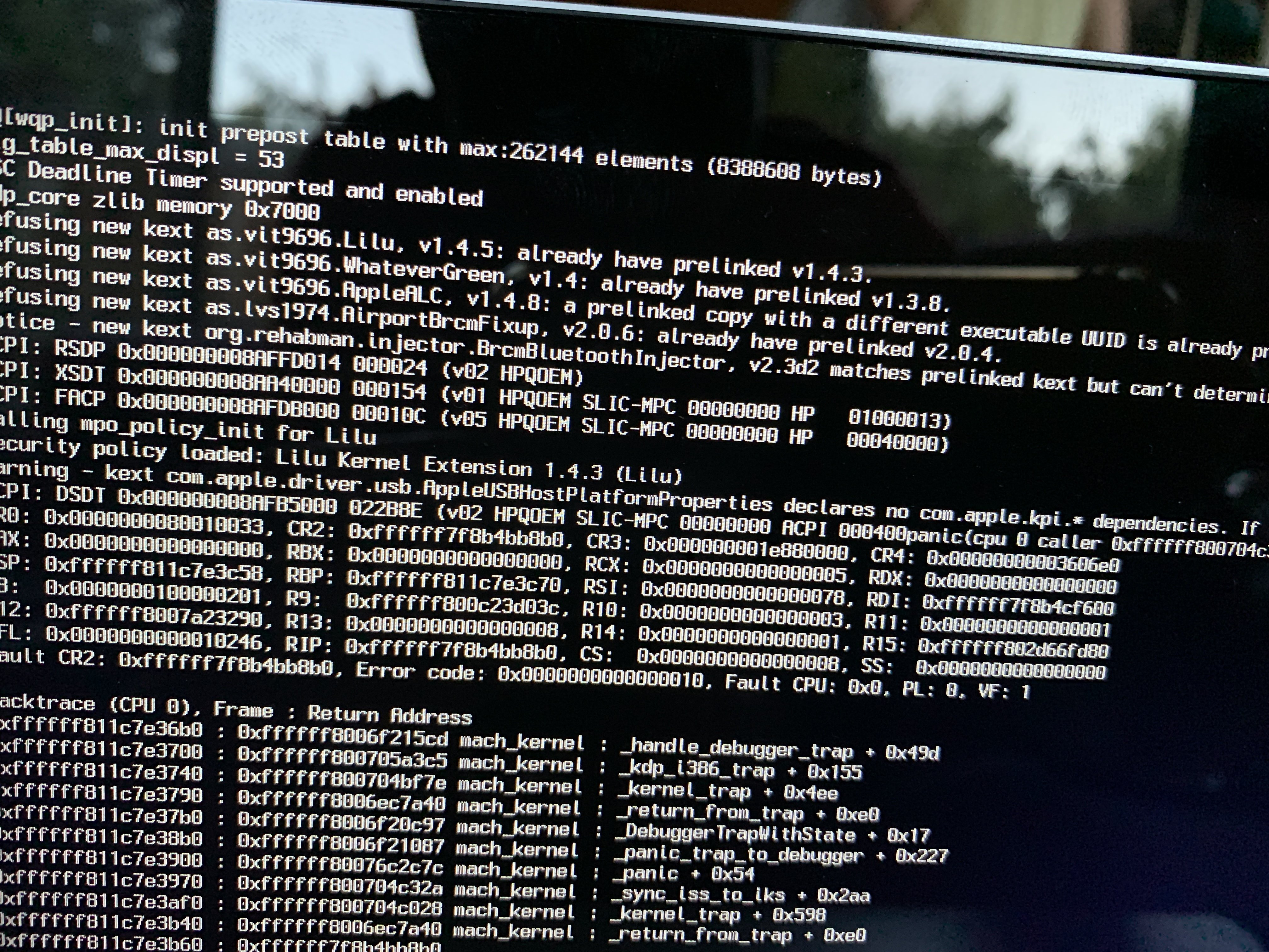

I used 0.5.9 to boot to my MacBook Pro 14,2 i7-7500u, HD620. I got kernel panic when boot to internal hard drive NVME but not my external USB NVME, they're both Catalina 15.5. What's the difference between internal and usb?
The hard drive was installed with Clover and older Lilu and whatever green, update the latest and still kp. Can someone help me on this one?
kp1.thumb.JPG.e853d4a5c8a4dde95b264c7f9818ac38.JPGkp.thumb.JPG.ebe43c45f4a88195f704f16fcad38ed4.JPG
  • Confused 1
Alright, I fixed the kernel panic, the hard drive was installed with Clover, the lilu.kext, whatevergreen, applealc, airportfix were installed in the LE folder with older version. Needed to boot with clover, removed all the kexts and updated caches, then it work.
The 0.5.9 definitely not autoboot after timeout. I used the 0.5.8 then it works.
I can't use OpenCore bootloader since it freezes like crazy and I can't boot into Windows without being broken and fixed by HP.
What's the differences? It just a bootloader. I like it because I don't need to use preloader.efi to boot into my HP laptop without kp, but these are really deal breaker.
If I use entries to create the short cut, it worked on one laptop and doesn't work on this new Kaby Lake i7-7500u Envy 13. The Clover bootloader works flawlessly.
If I use the entries to create the shortcut to Clover then from clover boot Windows then it's perfect.
If every time you update the software, try to make it backward compatible with the previous version and not breaking things. This is the reason why people can't boot with OpenCore with laptops.
I found the guide on laptops are hit and missed, I need to figure out for the Kaby Lake, Sky Lake, Coffee Lake and if I followed the guide to the T, it won't boot.
Now, all my laptops IvyBridge, Haswell HD4400 and HD4600, Broadwell HD5500, Sky Lake HD520, Kaby Lake HD620 and Coffee Lake UHD620 can be booted with OpenCore solidly, unless I make the EFI folder big enough for both Clover and OC, I can't dual boot OC and Windows.
Most people use bootloader to hack, dual boot windows and mac, don't try to make it for real macs, it defeat the purpose.
Show me how to boot to windows without breaking it every time so I can test.
Cheers,

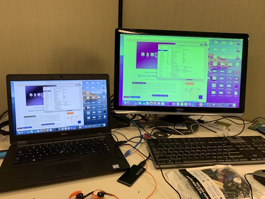

Louis IMG_0581.thumb.JPG.8af289e08e3b201bb5128ce844afc48c.JPGIMG_0579.thumb.JPG.a4a3904e6f6f78d40bbe9bce3f33a965.JPGIMG_0582.thumb.JPG.6afd1fb0f1e8c7b711b66e16a10eaedd.JPG

Sorry o/t
Dude clean your desk!
Sent from my iPhone using Tapatalk

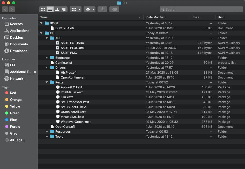

Can anyone check my conf file? What am I doing wrong? I can freeze on the boot.
Xeon W-32xx and Asus C621 motherboard.

Hi Daniel, I think I am having a problem very similar to what you had before on audio output. I'm building a Hackintosh on Optiplex 5060 micro, i5 8500T, Q370, UHD 630, ALC3234(255). I'm using Opencore 0.5.9 and trying to install Catalina 10.15.5. I can boot into the system fine, but there is no audio. If I go to "System Preference->Sound->Output" it tells me "No output devices found". After some research I found these posts. It seems that I need to make some change DSDT. Would you mind giving me more details on how to change DSDT and what exactly to change in DSDT? Thank you very much. And please do shout out if you need any more information. I know it has been a long time but perhaps you can shed some light on me :)
System DSDT.aml
Config.plist
