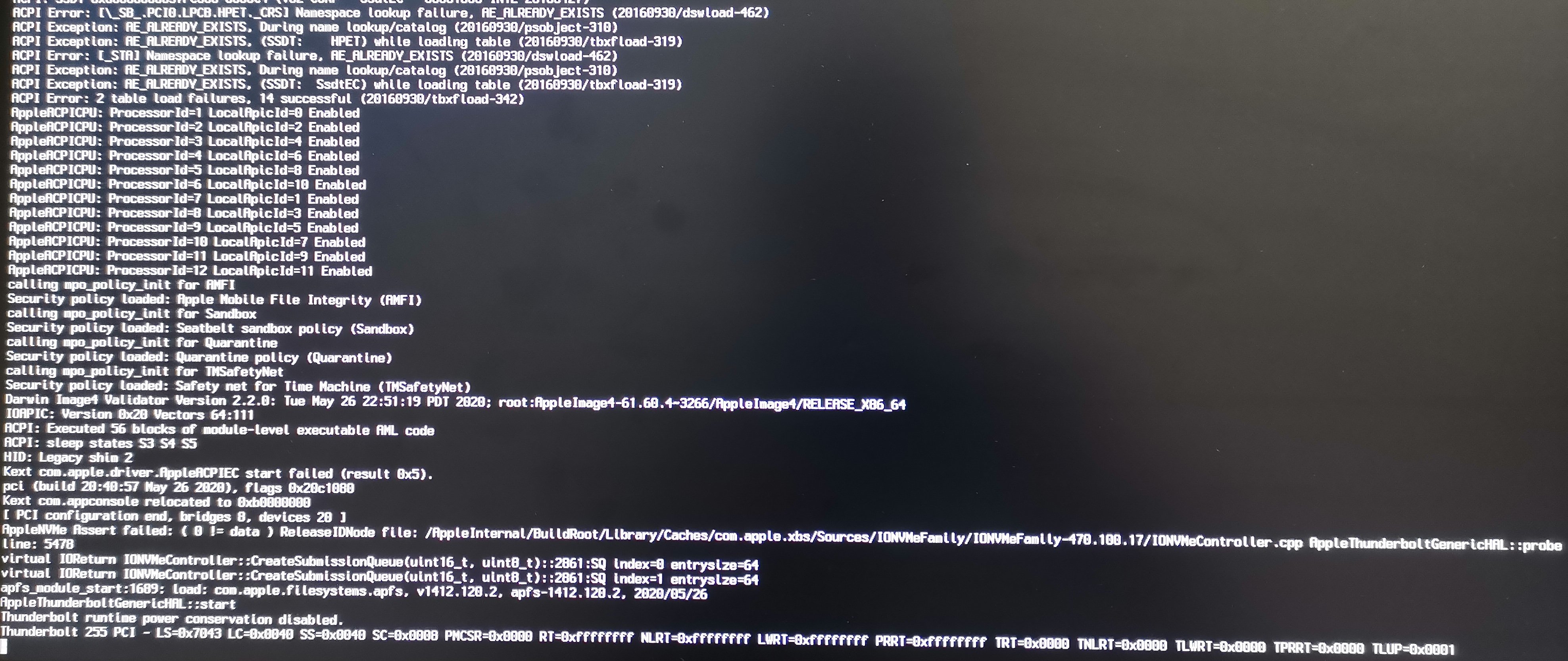

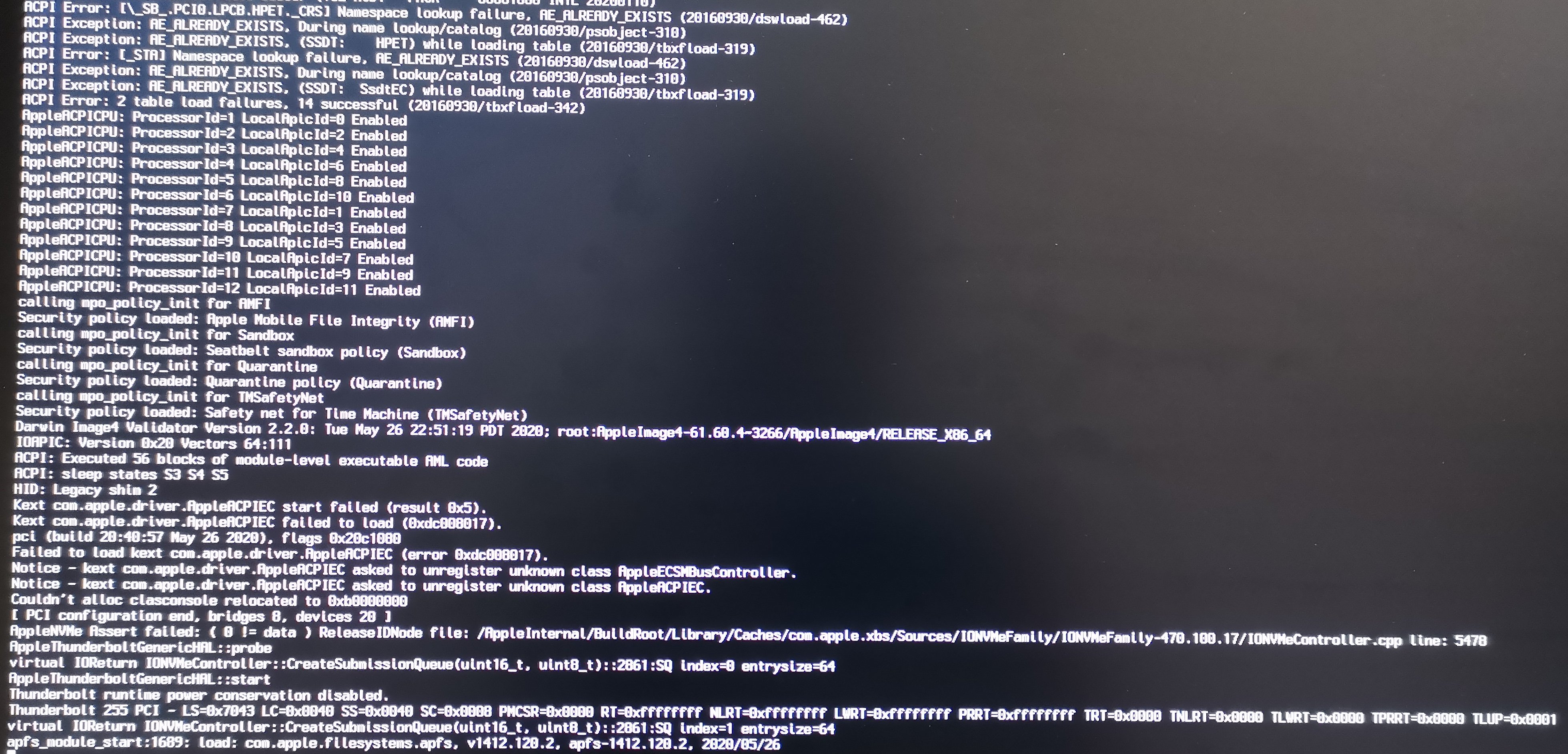

dolgarrenan Posted June 15, 2020 Share Posted June 15, 2020 Hello @vit9696 I have been recently setting up the new NUC10i7FHN with latest OC 0.5.9 (which works) everything is working but there is no way to disable device AppleACPIEC via SSDT, the original BIOS contains PNP0C09 under device H_EC, everytime I try to disable it with the following code DefinitionBlock ("", "SSDT", 2, "ACDT", "SsdtEC", 0x00001000) { External (_SB_.PCI0.LPCB.H_EC, DeviceObj) Scope (\_SB.PCI0.LPCB.H_EC) { Method (_STA, 0, NotSerialized) // _STA: Status { If (_OSI ("Darwin")) { Return (0) } Else { Return (0x0F) } } } } It throws a KP at boot, I still haven't had this issue with any other build, so I'm a bit lost... To me it seems that H_EC on original DSDT is not loading, see code: Scope (_SB.PCI0.LPCB) { Name (ONEW, Zero) Device (H_EC) { Name (_HID, EisaId ("PNP0C09") /* Embedded Controller Device */) // _HID: Hardware ID Name (_UID, One) // _UID: Unique ID Method (_CRS, 0, Serialized) // _CRS: Current Resource Settings { Name (BFFR, ResourceTemplate () { IO (Decode16, 0x0062, // Range Minimum 0x0062, // Range Maximum 0x00, // Alignment 0x01, // Length ) IO (Decode16, 0x0066, // Range Minimum 0x0066, // Range Maximum 0x00, // Alignment 0x01, // Length ) }) Return (BFFR) /* \_SB_.PCI0.LPCB.H_EC._CRS.BFFR */ } Method (_STA, 0, NotSerialized) // _STA: Status { Return (0x0B) ^^^GFX0.CLID = 0x03 Return (Zero) } Here is where I'm a little confused, there is a Return (0x0B) and then a Return (Zero) under STA, system boots as is without trying to disable H_EC but loads Kernel Extension ACPIEC.. Here is a pic of the KP, which seems to me like the one I had on my X299X designare till RTC0 SSDT was made, I have tried with it and AWAC too, but nothing happens.. Could you shed some light here? Many thanks in advanced! 1 Link to comment https://www.insanelymac.com/forum/topic/350754-opencore-general-discussion/page/213/#findComment-2725763 Share on other sites More sharing options...

markl18 Posted June 15, 2020 Share Posted June 15, 2020 6 minutes ago, dolgarrenan said: Hello @vit9696 I have been recently setting up the new NUC10i7FHN with latest OC 0.5.9 (which works) everything is working but there is no way to disable device AppleACPIEC via SSDT, the original BIOS contains PNP0C09 under device H_EC, everytime I try to disable it with the following code DefinitionBlock ("", "SSDT", 2, "ACDT", "SsdtEC", 0x00001000) { External (_SB_.PCI0.LPCB.H_EC, DeviceObj) Scope (\_SB.PCI0.LPCB.H_EC) { Method (_STA, 0, NotSerialized) // _STA: Status { If (_OSI ("Darwin")) { Return (0) } Else { Return (0x0F) } } } } It throws a KP at boot, I still haven't had this issue with any other build, so I'm a bit lost... To me it seems that H_EC on original DSDT is not loading, see code: Scope (_SB.PCI0.LPCB) { Name (ONEW, Zero) Device (H_EC) { Name (_HID, EisaId ("PNP0C09") /* Embedded Controller Device */) // _HID: Hardware ID Name (_UID, One) // _UID: Unique ID Method (_CRS, 0, Serialized) // _CRS: Current Resource Settings { Name (BFFR, ResourceTemplate () { IO (Decode16, 0x0062, // Range Minimum 0x0062, // Range Maximum 0x00, // Alignment 0x01, // Length ) IO (Decode16, 0x0066, // Range Minimum 0x0066, // Range Maximum 0x00, // Alignment 0x01, // Length ) }) Return (BFFR) /* \_SB_.PCI0.LPCB.H_EC._CRS.BFFR */ } Method (_STA, 0, NotSerialized) // _STA: Status { Return (0x0B) ^^^GFX0.CLID = 0x03 Return (Zero) } Here is where I'm a little confused, there is a Return (0x0B) and then a Return (Zero) under STA, system boots as is without trying to disable H_EC but loads Kernel Extension ACPIEC.. Here is a pic of the KP, which seems to me like the one I had on my X299X designare till RTC0 SSDT was made, I have tried with it and AWAC too, but nothing happens.. Could you shed some light here? Many thanks in advanced! hi weg I think should have renamed your H_EC to EC or you have to doit but once oc did it you can't have ssd looking for H_EC because it is already renamed so you have rename ssd by hand by replacing H_EC to EC so that that SSDT should do it what ever it supposed to do now I am sure there are more knowledgeable people who will tell you what to do this is just my 2 cents worth by the way AAPPLE doesn't understand H_EC but only EC hence all of the renaming goes on 1 Link to comment https://www.insanelymac.com/forum/topic/350754-opencore-general-discussion/page/213/#findComment-2725765 Share on other sites More sharing options...

dolgarrenan Posted June 16, 2020 Share Posted June 16, 2020 (edited) 15 hours ago, markl18 said: hi weg I think should have renamed your H_EC to EC or you have to doit but once oc did it you can't have ssd looking for H_EC because it is already renamed so you have rename ssd by hand by replacing H_EC to EC so that that SSDT should do it what ever it supposed to do now I am sure there are more knowledgeable people who will tell you what to do this is just my 2 cents worth by the way AAPPLE doesn't understand H_EC but only EC hence all of the renaming goes on Hi there, unfortunately there are no renames here, It would be easier just to undo what has been done. Renaming devices (in this case) is not an option, macOS doesn't understand what H_EC is, or at least it can't read from it because it does not belong to its code, while renaming might work we are only telling macOS to read a device we have migrated H_EC to EC, thus causing little boot failures and possible issues along the line. Apple needs a clean plate to eat, if you rename H_EC (rubbish) to EC (clean plate) you are basically moving your s**t to the plate, creating a dummy EC defeats the purpose while renaming, we need to correctly dispose of that rubbish. (easy explanation) Since macOS Mojave there is a need to use an Embedded Controller (EC) to correctly boot, so that's why we create a dummy for the OS to be complacent. If not done properly the kernelExtension AppleACPIEC loads at boot and that's what we are trying to avoid. I'm just summing up whats already in the documentation. Key point, renaming is not the solution. Edited June 16, 2020 by dolgarrenan Note added for more information Link to comment https://www.insanelymac.com/forum/topic/350754-opencore-general-discussion/page/213/#findComment-2725809 Share on other sites More sharing options...

hardcorehenry Posted June 16, 2020 Share Posted June 16, 2020 (edited) 2 hours ago, dolgarrenan said: Hi there, unfortunately there are no renames here, It would be easier just to undo what has been done. Renaming devices (in this case) is not an option, macOS doesn't understand what H_EC is, or at least it can't read from it because it does not belong to its code, while renaming might work we are only telling macOS to read a device we have migrated H_EC to EC, thus causing little boot failures and possible issues along the line. Apple needs a clean plate to eat, if you rename H_EC (rubbish) to EC (clean plate) you are basically moving your s**t to the plate, creating a dummy EC defeats the purpose while renaming, we need to correctly dispose of that rubbish. (easy explanation) Since macOS Mojave there is a need to use an Embedded Controller (EC) to correctly boot, so that's why we create a dummy for the OS to be complacent. If not done properly the kernelExtension AppleACPIEC loads at boot and that's what we are trying to avoid. I'm just summing up whats already in the documentation. Key point, renaming is not the solution. It's possible you need to disable original _STA in Device (H_EC) via rename _STA to XSTA and add this modified SSDT-EC-USBX.aml SSDT-EC-USBX.aml Edited June 16, 2020 by hardcorehenry 1 Link to comment https://www.insanelymac.com/forum/topic/350754-opencore-general-discussion/page/213/#findComment-2725817 Share on other sites More sharing options...
dolgarrenan Posted June 16, 2020 Share Posted June 16, 2020 1 hour ago, hardcorehenry said: It's possible you need to disable original _STA in Device (H_EC) via rename _STA to XSTA and add this modified SSDT-EC-USBX.aml SSDT-EC-USBX.aml Unfortunately it didn't work, but strange because log now shows a kind of different message, why isn-t the damned embedded controller disabling¿?¿? And why the KP... Link to comment https://www.insanelymac.com/forum/topic/350754-opencore-general-discussion/page/213/#findComment-2725822 Share on other sites More sharing options...
hardcorehenry Posted June 16, 2020 Share Posted June 16, 2020 13 minutes ago, dolgarrenan said: Unfortunately it didn't work, but strange because log now shows a kind of different message, why isn-t the damned embedded controller disabling¿?¿? And why the KP... Renaming _STA to XSTA is tricky, you have to rename it only in H_EC device by adding in patch count 1 and skip value(you have to count yourself). Post your untouched DSDT.aml(dumped via OC debug or acpidump.efi or clover(F4)) up to you. 1 Link to comment https://www.insanelymac.com/forum/topic/350754-opencore-general-discussion/page/213/#findComment-2725824 Share on other sites More sharing options...
