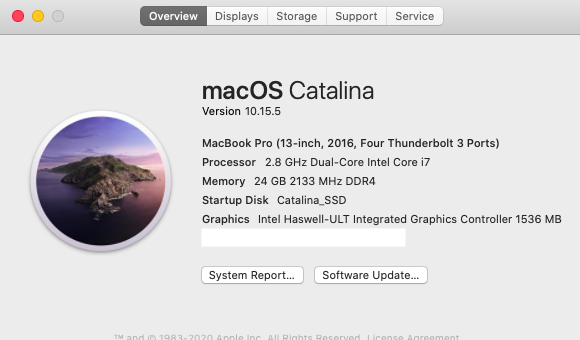

el_charlie Posted June 6, 2020 Share Posted June 6, 2020 23 hours ago, makk said: Greetings Charlie Did the MacBook Air Display Profile solve your screen Display problems? I switched to MacBook Pro profile using Hackintool. I did get one glitch on a PNG or JPG on Facebook sight. So it is still not perfect. When Profiles for Display do not line up with the Monitor, Scan lines and all this, it starts to corrupt the output. Scan lines in Display Sys Prefanes. > .icc there are lots in Overrides Directory. Can remove all the ones that don't work it's there for modeling. Just put in there all the ones your machine can use and stock up. Get different color profiles. Also, Charilie make sure EC0 and EC are not in the same place on IOREG Each one has to have it's own identifier ----EC. < EC00000000 as reference Fake ID Using Fake SSDT-EC.aml profrom OC ACPI example or see below ^--------ApplePower----- ----EC0 ---^^ your DSDT You can download USBMAP which checks to see if you have SSDT-UIAC.aml, EC SSDT, UsbInjectall.kext to create a mapping for your USB which solves a lot of issues. Previously I did not have these problems until Sierra (didn't know Sierra changed from El Capitan in ACPI) I read rehab man's instructs and well it worked. But not all of his works because it is machine specific. He use different machines. Asus is not industry standard and mixes and matches Intel and AMD in their ACPI. For instance for LPC it is SBRG. Screws everything up. Cannot change names or else issues arise. Cannot change names to the ones Rehabman suggests such as change EC0 to EC. doing this will mess up your PC. So it has to be done by OC or Clover in Patches to Fake the Apple. It has to be "Faked" or no boot and or all kinds of problems arise if it boots. Luckily this is Intel MB. Sandybridge so certain things pass. The one's that don't pass no boot. With OC don't have to inject DSDT into ACPI, but if you don't have SSDT's to take care of your lets FNkeys, > tluck, does a great job making an SSDT for his FNkeys. Have to learn how to do this. My PC doesn't like Voodoo Controller and Voodoo anything spits it out. Keys left in mismatch, delays system does not compute correctly Will Robinson. Let me know how MacBook Air profile works out I did inject my own patched DSDT and don't use SSDT. I made all the modifications there. Like I said, I had to apply the EC0 > EC rename to get to the Catalina installer. Everything works fine. I still have some glitches and only one freeze. It's like the RAM overlaps the allocated VRAM and are conflicts or so. It's weird and annoying. I used the Macbook Air EDID because the MacBook Pro's appear as retina display on System Profiler. The MBA EDID appears just fine. I also edited that generated EDID to modify the display size (it appeared as 11.6 inches, mine is 14). Other than that, I left the timings and profiles as is, just the display size. I used AW EDID Editor. I'm injecting the EDID via the generated kext from hackintool in OC/Kexts. Link to comment https://www.insanelymac.com/forum/topic/350754-opencore-general-discussion/page/210/#findComment-2725123 Share on other sites More sharing options...

makk Posted June 6, 2020 Share Posted June 6, 2020 3 hours ago, el_charlie said: I did inject my own patched DSDT and don't use SSDT. I made all the modifications there. Like I said, I had to apply the EC0 > EC rename to get to the Catalina installer. Everything works fine. I still have some glitches and only one freeze. It's like the RAM overlaps the allocated VRAM and are conflicts or so. It's weird and annoying. I used the Macbook Air EDID because the MacBook Pro's appear as retina display on System Profiler. The MBA EDID appears just fine. I also edited that generated EDID to modify the display size (it appeared as 11.6 inches, mine is 14). Other than that, I left the timings and profiles as is, just the display size. I used AW EDID Editor. I'm injecting the EDID via the generated kext from hackintool in OC/Kexts. Right, I'm using Retina 13.3 MacBook Pro for 15.5" monitor I just downloaded AW EDID Editor to see if this can fix the size. Using the MacBook Pro is much better, but leaving the laptop on overnight tends to get hot causing lines to appear randomly so my guess is that this EDID is not quite there yet. After you changed the size to match, any problems? Link to comment https://www.insanelymac.com/forum/topic/350754-opencore-general-discussion/page/210/#findComment-2725134 Share on other sites More sharing options...
el_charlie Posted June 6, 2020 Share Posted June 6, 2020 59 minutes ago, makk said: Right, I'm using Retina 13.3 MacBook Pro for 15.5" monitor I just downloaded AW EDID Editor to see if this can fix the size. Using the MacBook Pro is much better, but leaving the laptop on overnight tends to get hot causing lines to appear randomly so my guess is that this EDID is not quite there yet. After you changed the size to match, any problems? Still some lines here and there. Sometimes on an app. Just closing it and restarting it fixes it. I don't have much hope. Can you explain me the display overrides, maybe on a PM to avoid messing the topic? Link to comment https://www.insanelymac.com/forum/topic/350754-opencore-general-discussion/page/210/#findComment-2725137 Share on other sites More sharing options...

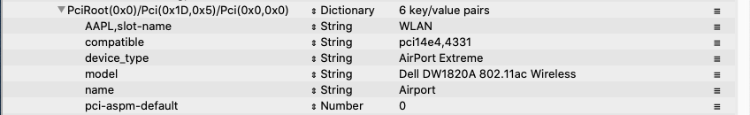

SavageAUS Posted June 9, 2020 Share Posted June 9, 2020 (edited) Success! DW1820A Kexts AirportBrcmFixup.kext BrcmBluetoothInjector.kext BrcmFirmwareData.kext BrcmPatchRAM3.kext For handoff i needed BT4LEContinuityFixup.kext 2.4Ghz seems to be working flawlessly, unable to rest 5Ghz until i get home later today. 5ghz works fine too. Edited June 10, 2020 by SavageAUS 3 Link to comment https://www.insanelymac.com/forum/topic/350754-opencore-general-discussion/page/210/#findComment-2725298 Share on other sites More sharing options...

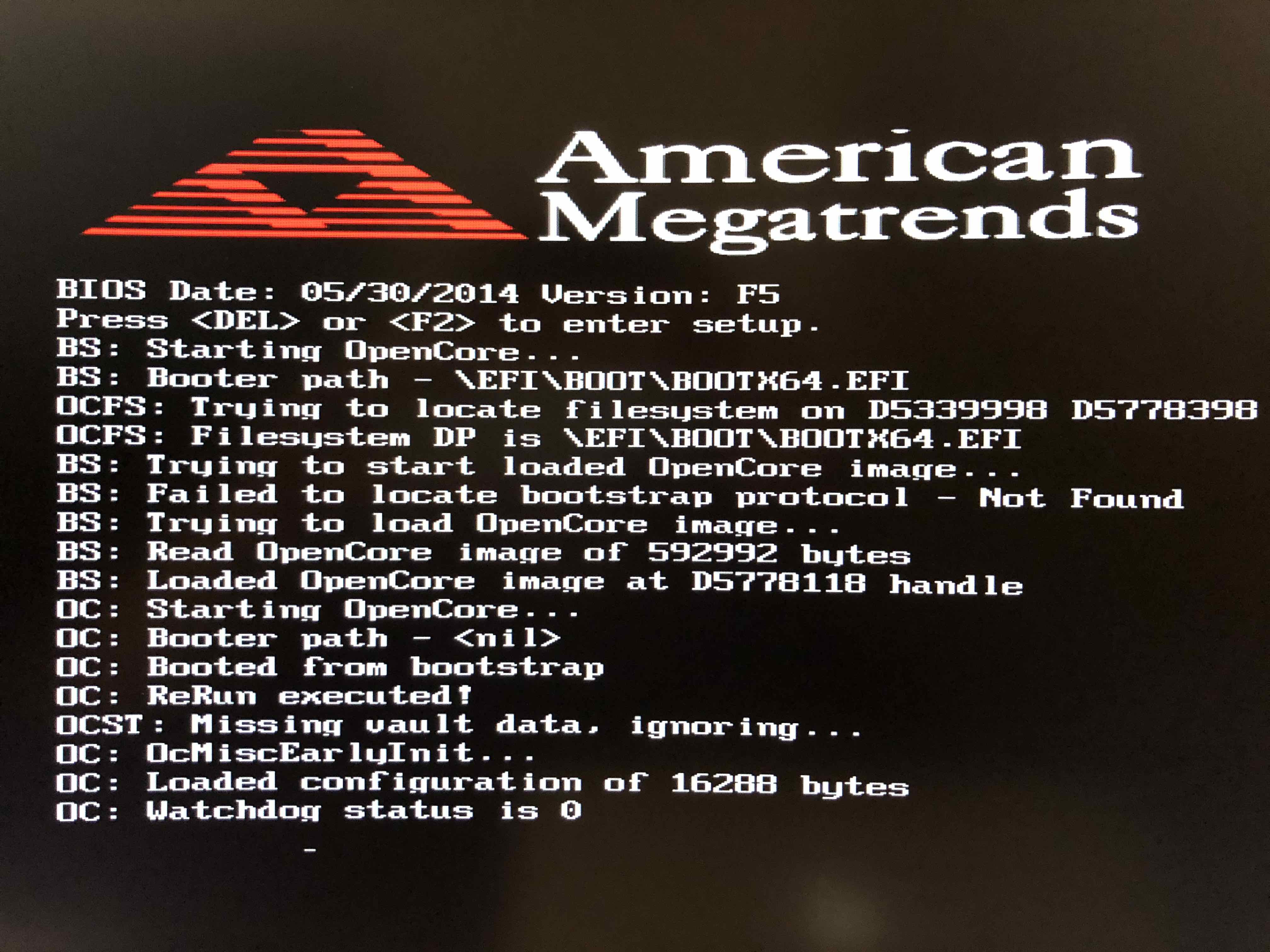

yetties Posted June 9, 2020 Share Posted June 9, 2020 On 6/7/2020 at 3:39 PM, yetties said: I've been using OC 0.5.8 with Catalina 10.15.5 working fine. I thought I should try 0.5.9, but got stuck before picker menu. All efi, kexts and config.plist are updated accordingly, and I even tried the latest dev beta build. Didn't see anyone has this issue. It looks like 0.5.9 is incompatible with ga-z97x-gaming 5 (bios ver F5). Could anyone help me on this? After going through OC log, it's loading AudioDxe.efi and stuck at "HdaControllerInitPciHw(): controller version 0.0". With some try and error, the issue is version 0.5.9 of driver AudioDxe.efi and it's incompatible with my ga-z97x-gaming 5 audio (Haswell, 9 series, HD4600). The solution is to replace it with AudioDxe.efi in the 0.5.8, and it works well! Link to comment https://www.insanelymac.com/forum/topic/350754-opencore-general-discussion/page/210/#findComment-2725309 Share on other sites More sharing options...
vit9696 Posted June 9, 2020 Share Posted June 9, 2020 All who have issues with AudioDxe, please check 0.6.0 master and provide logs in verbose mode if they are still present. Here is how: https://github.com/acidanthera/bugtracker/issues/963#issuecomment-640363465 1 Link to comment https://www.insanelymac.com/forum/topic/350754-opencore-general-discussion/page/210/#findComment-2725319 Share on other sites More sharing options...
