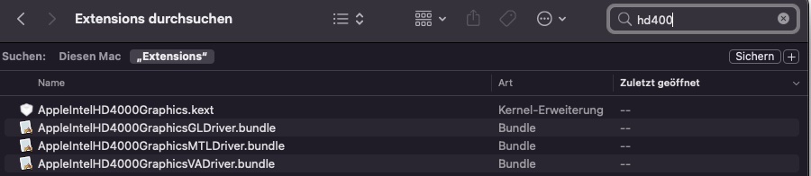

PoMpIs Posted June 13, 2021 Share Posted June 13, 2021 I have been testing, and I have been able to load the kext of the HD4000 in my lenovo t430 ... but I still do not accelerate graphics ... what else is there to do? ¿? 😅 Greetings 🙂 1 1 Link to comment https://www.insanelymac.com/forum/topic/348725-pre-release-macos-monterey/page/11/#findComment-2760733 Share on other sites More sharing options...
Guest 5T33Z0 Posted June 13, 2021 Share Posted June 13, 2021 (edited) @pompis12 Nice. Did you take the IntelHD4000.kext from Big Sur and inject it through the bootloader or how did you get it to work? I had a look in System > Library > Extensions and it seems that there are more files associated with it than just the kext: Maybe you have to manually install these on the system to get it fully working? Edited June 13, 2021 by 5T33Z0 Link to comment https://www.insanelymac.com/forum/topic/348725-pre-release-macos-monterey/page/11/#findComment-2760734 Share on other sites More sharing options...

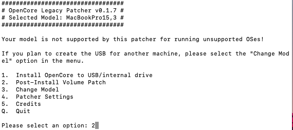

Avery B Posted June 13, 2021 Share Posted June 13, 2021 https://github.com/dortania/OpenCore-Legacy-Patcher HD4000 was figured out a little while ago today. Could use it for hackintoshes (need the latest commit, not release), though it's not officially supported. They just ask that you don't go to them with issues on hackintoshes - they won't try to break support though. @pompis12 3 Link to comment https://www.insanelymac.com/forum/topic/348725-pre-release-macos-monterey/page/11/#findComment-2760737 Share on other sites More sharing options...

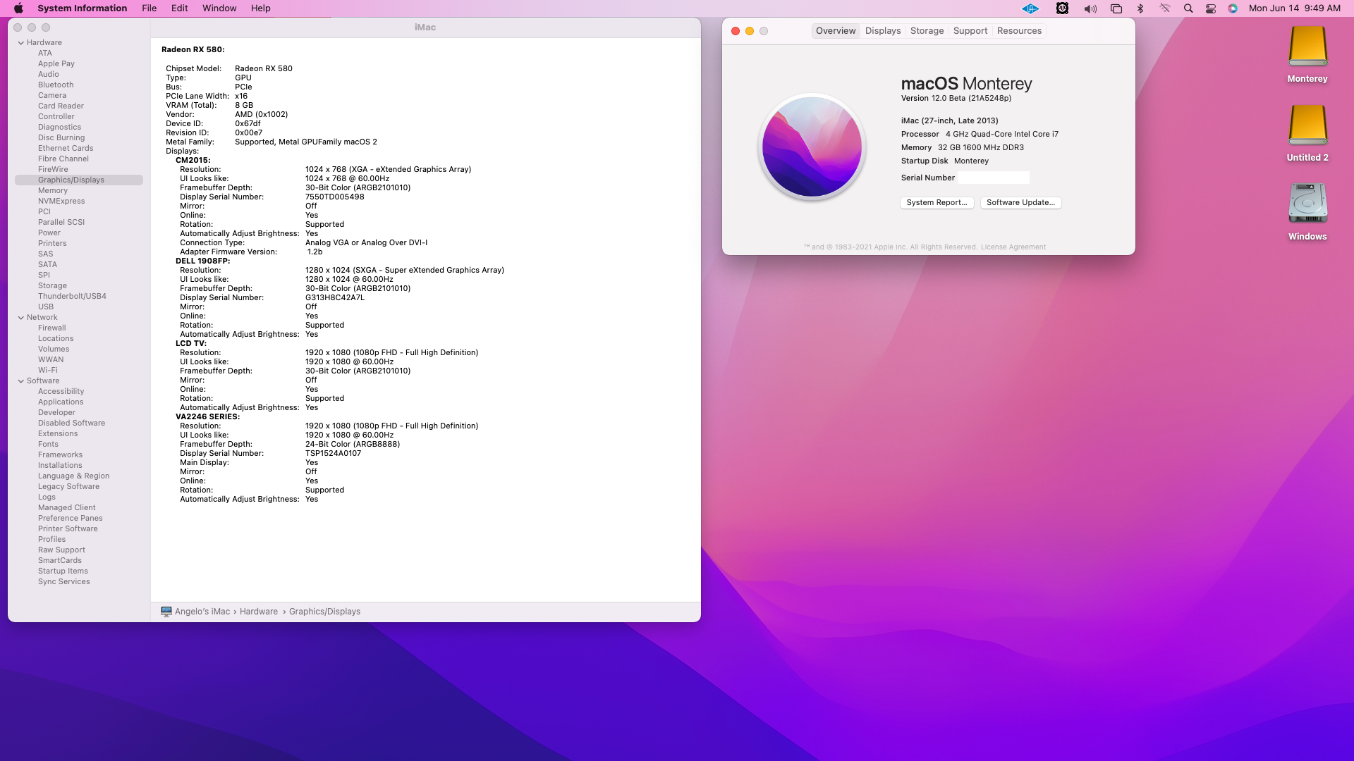

polkaholga Posted June 13, 2021 Share Posted June 13, 2021 (edited) Updated yesterday my Z390 Designare , only things I've noticed so far: - The RX580 fans spin up like hell for about 2-3 seconds during boot then go back to normal - SmallTreeIntel82576.kext loads but ethernet not working - WLAN and BT ( BRCM94360CD ) works without problems - New item called Passwords at "System Preferences" , looks like it picked up bookmarks from Safari. Not all of them but most... Edited June 13, 2021 by polkaholga Typo 1 Link to comment https://www.insanelymac.com/forum/topic/348725-pre-release-macos-monterey/page/11/#findComment-2760740 Share on other sites More sharing options...
asdesoso Posted June 13, 2021 Share Posted June 13, 2021 2 hours ago, 5T33Z0 said: Just installed the latest Nightly Build of 0.7.1 and the timeout/stall during boot is gone, yay! Did you choose the option 2? Post-Install Volume Patch? I assume that this option maybe running from Monterey boot up, but I don´t know how to disable HD4000 to apply the patch over Monterey. I tried several things such as: try to use the -wegnoigpu and also to boot into safe mode, but always the same boot loop, crashing WindowServer I think. So I need to boot up Monterey disabling HD4000 and after that apply the patch to enable QE/CI with Metal. Cheers. Link to comment https://www.insanelymac.com/forum/topic/348725-pre-release-macos-monterey/page/11/#findComment-2760742 Share on other sites More sharing options...
bisdak4920 Posted June 13, 2021 Share Posted June 13, 2021 34 minutes ago, asdesoso said: Did you choose the option 2? Post-Install Volume Patch? I assume that this option maybe running from Monterey boot up, but I don´t know how to disable HD4000 to apply the patch over Monterey. I tried several things such as: try to use the -wegnoigpu and also to boot into safe mode, but always the same boot loop, crashing WindowServer I think. So I need to boot up Monterey disabling HD4000 and after that apply the patch to enable QE/CI with Metal. Cheers. I think you are talking on 2 different issues. 1 Link to comment https://www.insanelymac.com/forum/topic/348725-pre-release-macos-monterey/page/11/#findComment-2760745 Share on other sites More sharing options...
PoMpIs Posted June 13, 2021 Share Posted June 13, 2021 (edited) 5 hours ago, 5T33Z0 said: @pompis12 Nice. Did you take the IntelHD4000.kext from Big Sur and inject it through the bootloader or how did you get it to work? I had a look in System > Library > Extensions and it seems that there are more files associated with it than just the kext: Maybe you have to manually install these on the system to get it fully working? Of course... I have put them all in / S / L / E Edited June 13, 2021 by pompis12 1 Link to comment https://www.insanelymac.com/forum/topic/348725-pre-release-macos-monterey/page/11/#findComment-2760747 Share on other sites More sharing options...
asdesoso Posted June 13, 2021 Share Posted June 13, 2021 1 hour ago, pompis12 said: Of course... I have put them all in / S / L / E I can see in your screenshot, that there are 6 files related to HD 4000, last week I tried to put all files except AppleIntelGraphicsShared.bundle, but still the same as currently, I can´t reach to login screen, because loginwindow crash repeatedly. Did you get QE/CI with Metal acceleration in Monterey? Cheers. Link to comment https://www.insanelymac.com/forum/topic/348725-pre-release-macos-monterey/page/11/#findComment-2760750 Share on other sites More sharing options...
PoMpIs Posted June 13, 2021 Share Posted June 13, 2021 (edited) 16 minutes ago, asdesoso said: I can see in your screenshot, that there are 6 files related to HD 4000, last week I tried to put all files except AppleIntelGraphicsShared.bundle, but still the same as currently, I can´t reach to login screen, because loginwindow crash repeatedly. Did you get QE/CI with Metal acceleration in Monterey? Cheers. You must put the automatic start of session in the first boot, but when you change any stop entering the desktop.. that's what happened to me once on my T430, and I had to reinstall .. I don't have graphic acceleration 😕 Regards Veo que somos españoles los dos jajaja.... lo que dices me ha pasado a mi, si no pones el inicio de sesiòn automatico para que entre sin pedir contraseña, hay veces que cuando va cargar el escritorio, se va a modo verbose, y no sale de ahi.... y en cuanto cambies algùn kext o configuraciòn, deja de entrar al sistema para siempre.... yo no he sido capaz de solucionarlo y he tenido que volver a reinstalar Monterey.... Està verdisima la cosa, por lo menos en el tema de mi portatil y la aceleracion gràfica... no hay manera joer Un Saludooteee compañero 🤗 Edited June 13, 2021 by pompis12 Link to comment https://www.insanelymac.com/forum/topic/348725-pre-release-macos-monterey/page/11/#findComment-2760751 Share on other sites More sharing options...

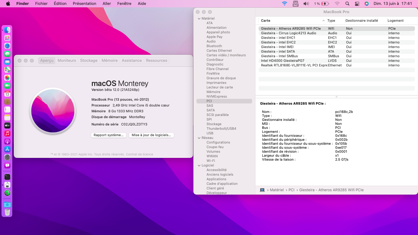

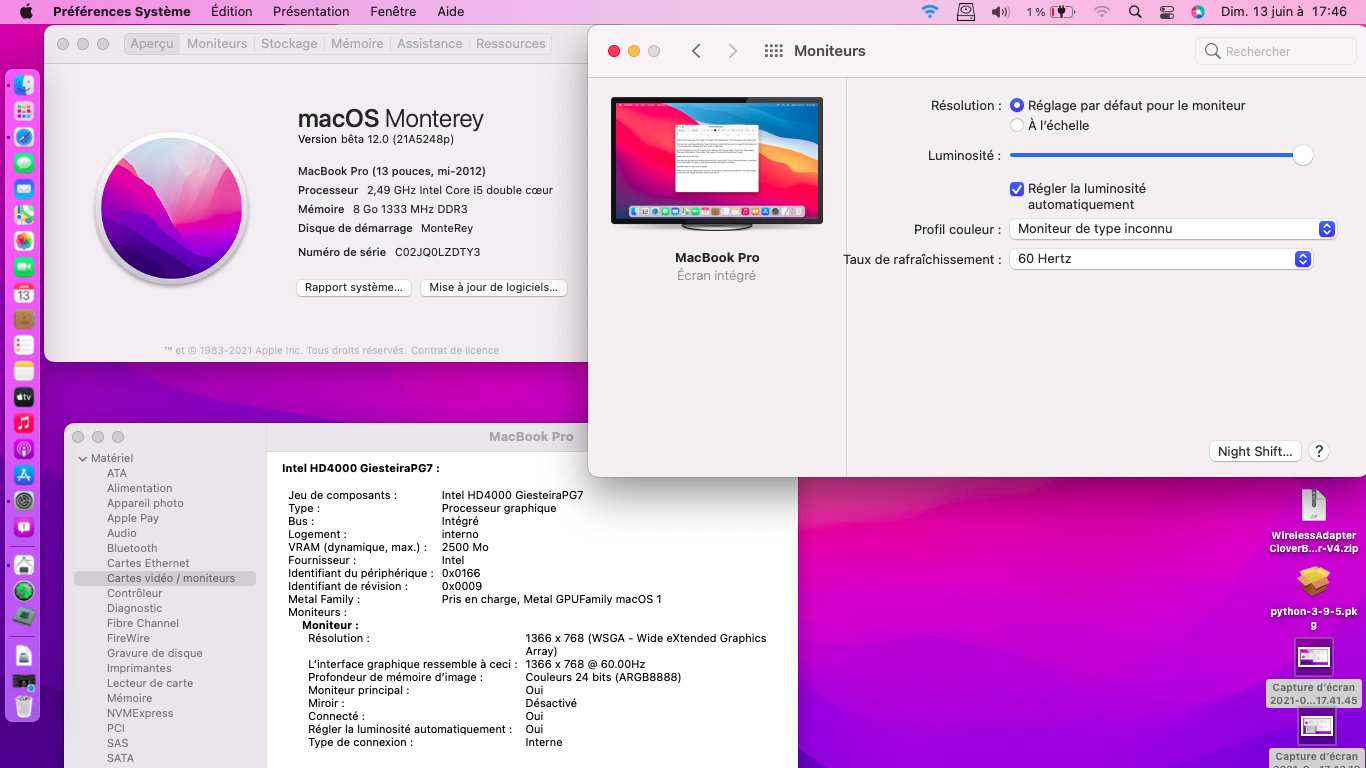

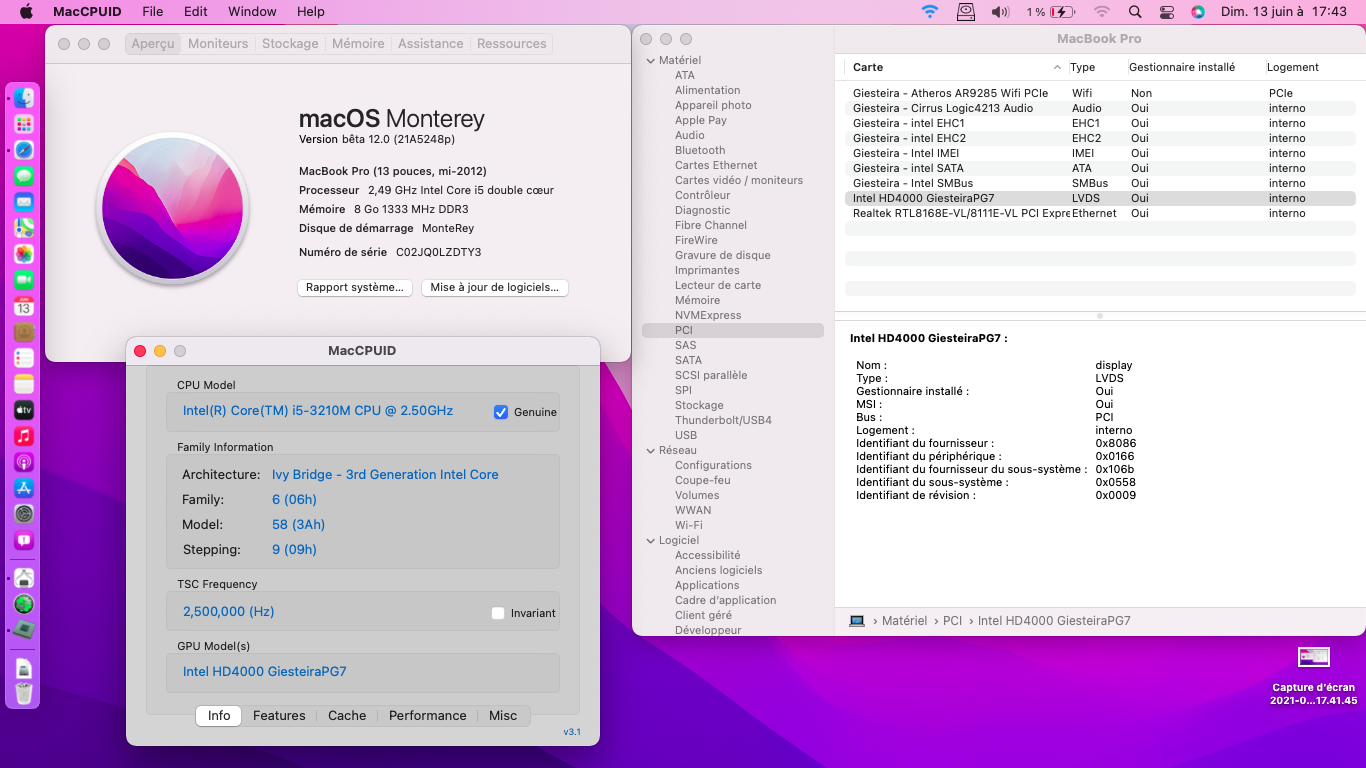

PG7 Posted June 13, 2021 Share Posted June 13, 2021 Dell Vostro 2520 MonteRey Clover Bootloader Intel i5-3210M Intel HD4000 8go RAM SSD Full QE/CI God Job Team ! Grats @JakeLuke ++++ Spoiler 1 Link to comment https://www.insanelymac.com/forum/topic/348725-pre-release-macos-monterey/page/11/#findComment-2760768 Share on other sites More sharing options...
PoMpIs Posted June 13, 2021 Share Posted June 13, 2021 12 minutes ago, PG7 said: Dell Vostro 2520 MonteRey Clover Bootloader Intel i5-3210M Intel HD4000 8go RAM SSD Full QE/CI God Job Team ! Grats @JakeLuke ++++ Hide contents But how do you do it? ? I don't know how it's going hahahaha 😆 Link to comment https://www.insanelymac.com/forum/topic/348725-pre-release-macos-monterey/page/11/#findComment-2760769 Share on other sites More sharing options...
Guest 5T33Z0 Posted June 13, 2021 Share Posted June 13, 2021 4 minutes ago, pompis12 said: But how do you do it? ? I don't know how it's going hahahaha 😆 If you want a Clover config to get you started, you can check mine. It's for a T530 so you have to change the Framebuffer-Patch. But besides that, it should be pretty similar: https://github.com/5T33Z0/Lenovo-T530-Hackinosh-OpenCore/releases/tag/r5134.2 Link to comment https://www.insanelymac.com/forum/topic/348725-pre-release-macos-monterey/page/11/#findComment-2760770 Share on other sites More sharing options...
PG7 Posted June 13, 2021 Share Posted June 13, 2021 29 minutes ago, pompis12 said: But how do you do it? ? I don't know how it's going hahahaha 😆 config.plist -> ARGS -> "amfi_get_out_of_my_way=1" (Clover & OpenCore) + "-no_compat_check" CsrActiveConfig -> 0xFEF SMBIOS -> MacBookPro9,1 / MacBookPro9,2 (Install SMBIOS MacBookPro12,1) Patch kext = OpenCore Legacy Patcher V 0.1.7 Last commit mandatory Ethernet Thanks @JakeLuke + Team OCLP https://github.com/dortania/OpenCore-Legacy-Patcher/tree/0.1.6 2 2 Link to comment https://www.insanelymac.com/forum/topic/348725-pre-release-macos-monterey/page/11/#findComment-2760772 Share on other sites More sharing options...
miliuco Posted June 13, 2021 Share Posted June 13, 2021 10 hours ago, polkaholga said: ... The RX580 fans spin up like hell for about 2-3 seconds during boot then go back to normal... This is the normal behaviour in my hack every time after ResetNVRAM, Catalina, BS and Monterey. In the following boots after ResetNVRAM fans are stopped. I also observe this behaviour in Windows from time to time, it is not unique to macOS. 1 Link to comment https://www.insanelymac.com/forum/topic/348725-pre-release-macos-monterey/page/11/#findComment-2760773 Share on other sites More sharing options...

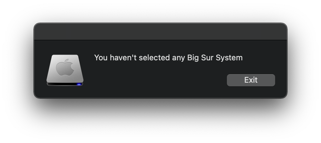

miliuco Posted June 13, 2021 Share Posted June 13, 2021 (edited) 5 hours ago, pompis12 said: P.S: I did that yesterday ... but I have discovered today that it can be done much easier, with this app that I have found and it seems to work well in Monterey: https://github.com/jacklukem/BigSurmountsrw/releases/tag/1.0 Hello, every time I use this application you are talking about, BigSurmountsrw, I get the same warning regardless of the volume I select in the initial window of the app. In your case it works well? Spoiler Edited June 13, 2021 by miliuco 1 Link to comment https://www.insanelymac.com/forum/topic/348725-pre-release-macos-monterey/page/11/#findComment-2760774 Share on other sites More sharing options...
