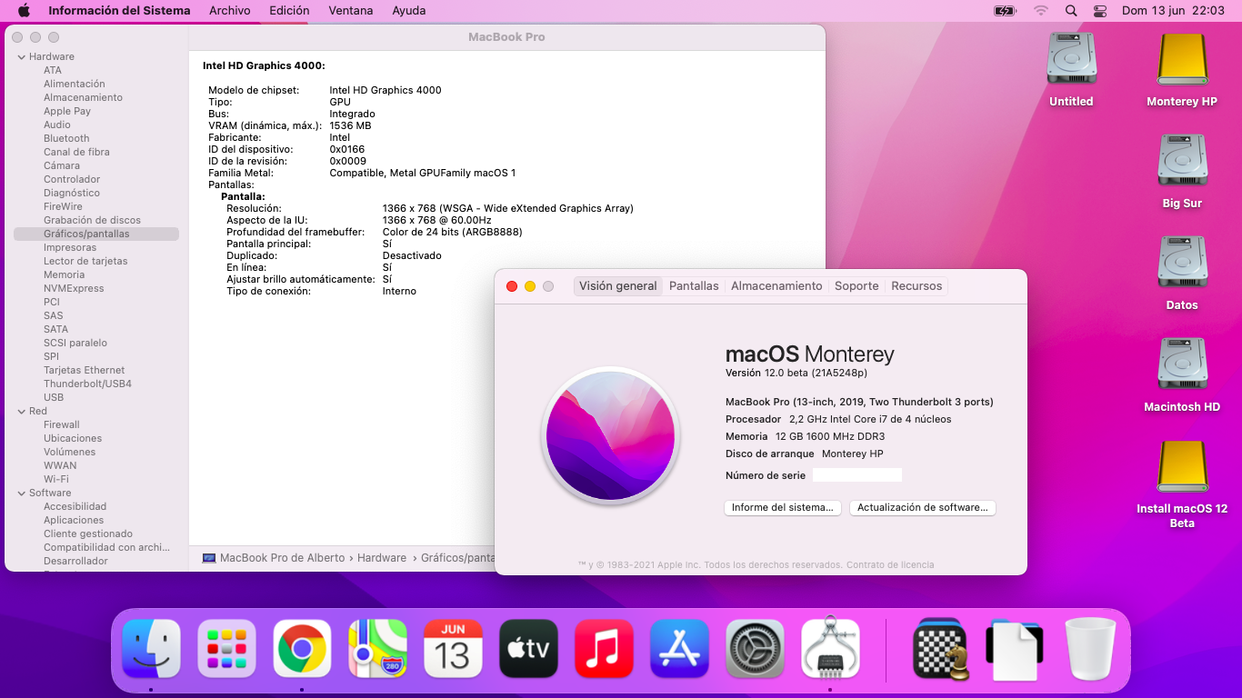

Hi @pompis12 I finally be able to get full QE/CI on HD4000 in Monterey.
Today was a hard day hehe, but finally I got it.
Spoiler
Ya veo jeje Que gusto da tener por aquí a un español también, gracias por la ayuda 😉
The process is, first as you said previously, enable auto login, because without doing this, we can´t follow to the next steps.
So after reach the desktop, I ran the OCLP, the latest Nightly, and the script detects me the HD 4000 Ivy Bridge and patch me the root volume, I have also tried to put manually into S/L/E the 6 binaries files downloaded from your previous link, but still haven´t QE/CI, but with this script it finally results succesfull.
Cheers.
  • Thanks 1
  Reveal hidden contents
Cheers.
This is great ... long life Lenovo T430 😆..
Tomorrow I get to it
Regards
Edited by pompis12
  • Haha 1

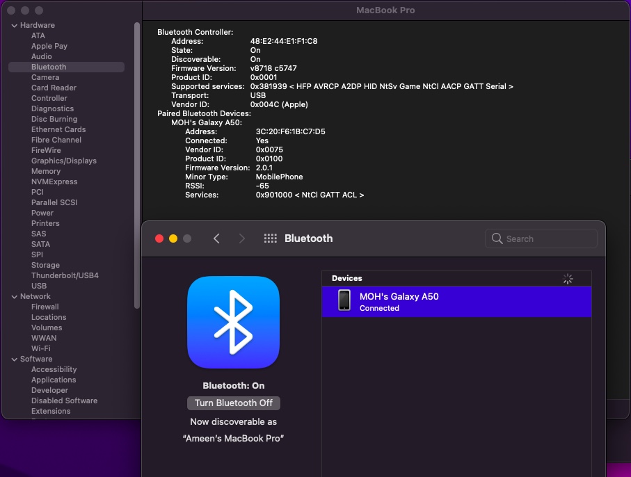

Great job @dhinakg
my first issue bluetooth of Dell 1560 BCM94352z is solved by installing BluetoolFixup.kext BrcmPatchRam3.kext BrcmFirmwareData.kext on macOS 12 now bluetooth is working fine but doesn't provide fully bluetooth info in sys
Here link https://github.com/acidanthera/BrcmPatchRAM/pull/12
Spoiler

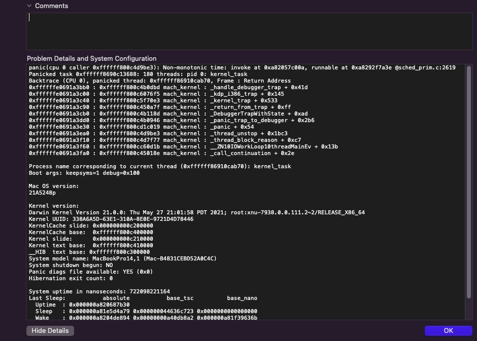

Hi guys,
macOS Monterey is a pita, today at first boot, it didn't boot again, I don't know why.
The only way for it to boot was with the usb installer, and it boots fine, anyone could tell me what is wrong?
Thanks
