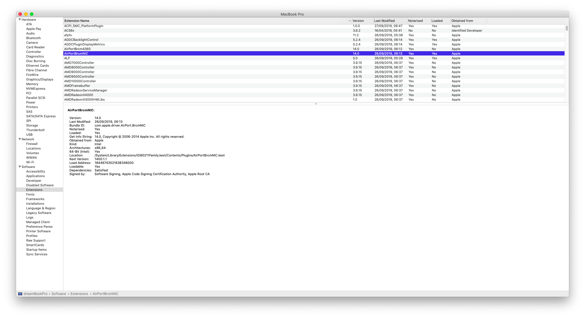

dreamwhite Posted June 23, 2020 Share Posted June 23, 2020 On 6/23/2020 at 11:00 AM, Common_Sense said: Thanks for the info! Does that mean that I have a brcm94360 and that it should work? Please see the screenshot below. It looks like the BrcmNIC driver is loaded instead of Brcm4360. So does this mean that my BCM943602BAED DW1830 will work as AirPortBrcmNIC is loaded instead of AirPortBrcm4360? Spoiler Link to comment https://www.insanelymac.com/forum/topic/344236-pre-release-macos-big-sur-in-vmware/page/5/#findComment-2726492 Share on other sites More sharing options...

Common_Sense Posted June 23, 2020 Share Posted June 23, 2020 On 6/23/2020 at 8:36 PM, Dreamwhite said: So does this mean that my BCM943602BAED DW1830 will work as AirPortBrcmNIC is loaded instead of AirPortBrcm4360? Yes it seems like AirPortBrcm4360 kext has beem removed while AirPortBrcmNIC kext still exists. Since you are using the kext file that still is present in Big Sur then you should be fine. Link to comment https://www.insanelymac.com/forum/topic/344236-pre-release-macos-big-sur-in-vmware/page/5/#findComment-2726497 Share on other sites More sharing options...
ludufre Posted June 23, 2020 Share Posted June 23, 2020 1 minute ago, Common_Sense said: Yes it seems like AirPortBrcm4360 kext has beem removed while AirPortBrcmNIC kext still exists. Since you are using the kext file that still is present in Big Sur then you should be fine. And in my case I have both being loaded (AirPortBrcm4360, AirPortBrcmNIC) with BCM94360CS2 ... I think I'm in trouble... Link to comment https://www.insanelymac.com/forum/topic/344236-pre-release-macos-big-sur-in-vmware/page/5/#findComment-2726498 Share on other sites More sharing options...

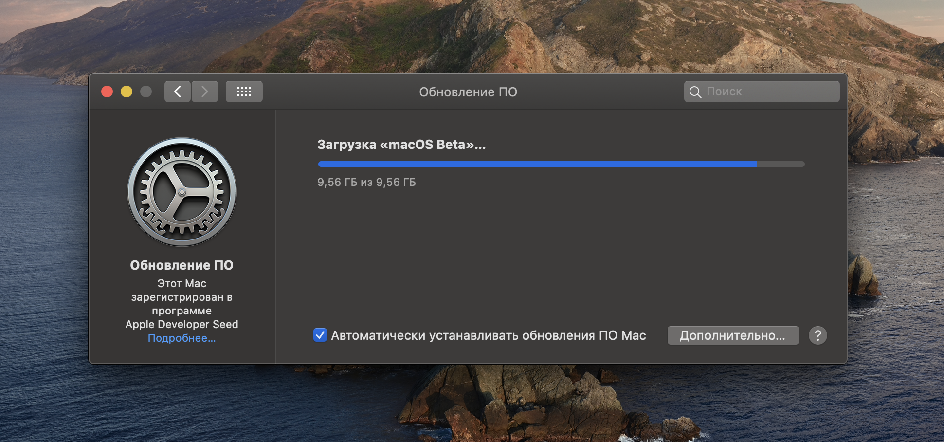

Arthur Asta Posted June 23, 2020 Share Posted June 23, 2020 Updating stuck, is it just mine problem or everyone elses too? Spoiler Link to comment https://www.insanelymac.com/forum/topic/344236-pre-release-macos-big-sur-in-vmware/page/5/#findComment-2726506 Share on other sites More sharing options...

kocoman Posted June 23, 2020 Share Posted June 23, 2020 6 hours ago, ricoc90 said: I guess the 94360 ones are using the BrcmNIC driver which was introduced in High Sierra I believe, whereas the 4360 ones are using the brcm4360 driver which indeed is reported as being removed from the IO80211Family.kext plugins Edit: My late 2012 mac mini seems to have the BCM94331PCIEBT3AX Is there some python script that can run thru the Extensions dir and compare what drivers are added and removed? between these 2 versions, and their Class (ethernet, sata, brand name, model etc)? Link to comment https://www.insanelymac.com/forum/topic/344236-pre-release-macos-big-sur-in-vmware/page/5/#findComment-2726520 Share on other sites More sharing options...

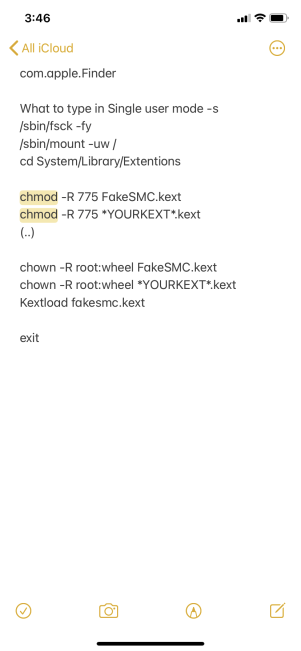

MattsCreative Posted June 23, 2020 Share Posted June 23, 2020 this is the self-injection method it has worked since 10.9 goodluck Spoiler Link to comment https://www.insanelymac.com/forum/topic/344236-pre-release-macos-big-sur-in-vmware/page/5/#findComment-2726525 Share on other sites More sharing options...
