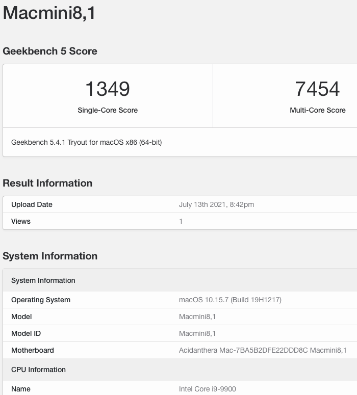

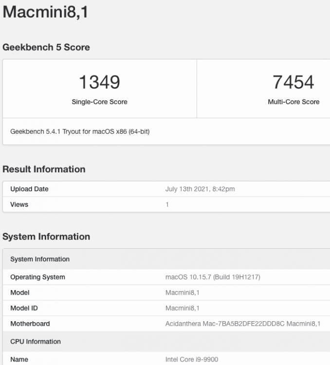

Time to admit that I was wrong about the i9-9900 - it's a beast in this HackMini8,1. My incorrect conclusion about the i9-9900 resulted from benchmarking in a way that placed continual stress on the CPU (I was experiencing the thermal limits of the tiny EliteDesk Mini package after the heatsink's thermal dissipation was maxed-out). In "normal" use where the i9-9900 CPU utilization is not continuous (CPU demand is in spurts, allowing the CPU to cool between load peaks), performance is incredible. My Visual Studio Xamarin Release builds with an i7-8700 have dropped from over 3.5 minutes to 2.5 minutes with an i9-9900.
I purchased my i9-9900 for $250. You can now find it for less. If you own an 800 G5 Mini 65W, consider this i9-9900 upgrade as CPU prices drop. No rush if you're happy with your current rig, but it's nice to know that you have future upgrade options.
Many thanks to @rafale77 who first made me aware of the i9-9900.
GB5 Benchmarks - Note the relatively poor multi-processor performance (due to thermal limit in the tiny EliteDesk Mini package)
Spoiler
708592043_ScreenShot2021-07-13at8_43_10PM.thumb.png.2806de8a38148398c4e6bc6252669f2c.png
Edited by tonyx86
Have you tried liquid metal? it was a game changer in my laptop, the thermal conductivity is so much better. Before LM I was experiencing constant throttling, and after only very rarely does it go there. The difference for me is between -15C to -20C. Under full load the CPU easily went above 90C, now the fans catch up and the CPU never goes above 65C
@theroadw Great to hear from you!  I have tried both AS5 and NT-H1.  I didn't notice much difference.  Are you suggesting a delidded CPU or just liquid metal between the CPU heatspreader and heatsink?  I imagine that your laptop doesn't have a CPU heat spreader (direct contact between the CPU die and heat pipe).
Note that I don't experience "constant throttling" on my rig (even with the i9-9900).  Most of the time, the rig is silent.  The fan ramps up during extended software builds (Visual Studio / Xamarin) and when running synthetic benchmarks like Cinebench.
EDIT: I'm not sure if the i9-9900 has a soldered IHS.  If it does, I'm not planning to attempt a delid.
Edited by tonyx86

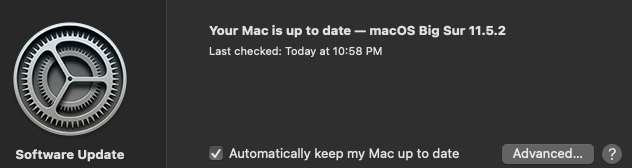

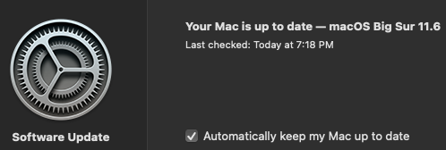

After a full backup to my spare NVMe SSD, the 11.6 upgrade proceeded without issues. I left it to complete unattended and it was finished when I returned.
Your Mac is up to date - macOS Big Sur 11.6
Spoiler

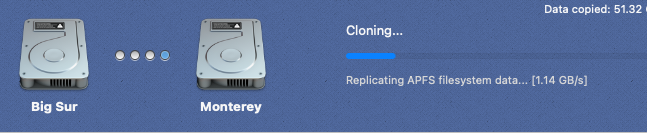

As I mentioned here, the 800 G4 and G5 Minis can accommodate 2 x M.2 NVMe SSDs and 1 x SATA HD (or SSD). In my G5 Mini HackMini8,1, I have 2 x WD SN750 500 GB M.2 NVMe SSDs and 1 x 2 TB SATA 6 HD (for Time Machine and backup). Before I apply any significant updates/upgrades to my production M.2 NVMe SSD, I clone to my second M.2 NVMe SSD (using Carbon Copy). This strategy has worked very well for me. I just performed a clone before applying the 11.6.1 update. Clone speeds are fantastic with this setup. It may seem like overkill, but if you rely on your rig for daily use and can't waste time recovering from a failed upgrade, this is a great strategy.
Cloning M.2 NVMe SSD
Spoiler
NOTE: After cloning a drive in the manner discussed above, the cloned volume will have a name identical to the original volume in OC's boot menu. Follow the instructions here for changing the name of the cloned volume if you want it to have a unique name in OC's boot menu.
NOTE 2: I disable Time Machine on my cloned volume, so that if I do boot the cloned volume (e.g. for Monterey upgrade testing), my cloned volume isn't writing to my Time Machine.

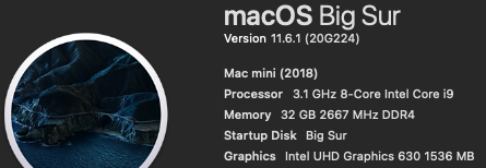

Big Sur 11.6.1 update completed without issues. I left it unattended and it was complete when I returned, so I'm not sure how long it took to perform the update. I'm running with Open Core 0.7.4.
About This Mac: Big Sur 11.6.1
Spoiler

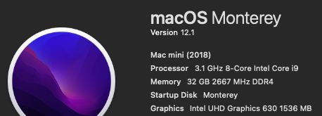

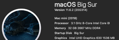

For those planning to migrate to Monterey, I have found that my DP->DVI video adapters no longer work properly with connector types patched as Dual-Link DVI (<04000000>).  In order to boot Monterey, I need to change the patched connector types to HDMI <00080000>) with DP->DVI adapters.  See my notes here.
EDIT: I have found that my DP->DVI adapters work in Big Sur 11.6.2 with patched connector type HDMI, so I will be modifying my EFI baseline to use patched connector type HDMI (replacing port type DVI).
EDIT2: Note that in order to use DP->DVI video adapters with this rig (CFL UHD630 iGPU), I must use a "mobile" framebuffer (I'm using AAPL,ig-platform-id 0x3E920000). A "desktop" framebuffer (e.g., AAPL,ig-platform-id 0x3E9B0007) with DP->DVI video adapters results in booting to black screens. This has been true for as long as I have been patching the HP EliteDesk 800 G4/G5 Minis.
About This Mac: Monterey 12.1
Spoiler
