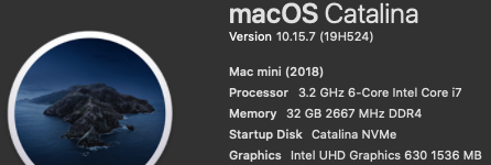

I purchased a used (like new) HP EliteDesk 800 G5 Mini (i7-9700 8-core/32GB RAM) and had some time to transfer my Big Sur SSD to the 800 G5 Mini.  After configuring the BIOS, it booted without any changes and without any problems.  The only difference I see between the G4 Mini/i7-8700 and G5 Mini/i7-9700 is that the i7-9700 multicore performance is better.  Otherwise, the units seem identical.
  • CPU: i7-9700 (8-Core, No Hyperthreading, CoffeeLake, UHD630)
  • Display: 3 x DP -> DigitalDVI
  • Chipset: Q370
  • Memory: 32GB (2 x 16GB) DDR4
  • Wi-Fi: Intel (disabled in BiOS)
  • 90W Genuine HP Power Supply
  • Cost: $460 USD with shipping (base cost before I add 2 x M.2 NVMe SSDs and add 1 x 2TB SATA6 HD)

About This Mac
Spoiler

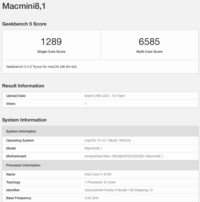

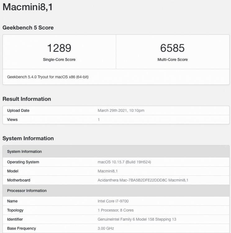

I re-ran Geekbench 5 to confirm that the RTC patch (instead of RtcMemoryFixup.kext) does not hurt performance. GB5 score seems unphased by the patch.
GB5 Scores for HP EliteDesk 800 G5 Mini / i7-9700 / 32GB DDR4
Spoiler
246340678_ScreenShot2021-03-29at10_12_30PM.thumb.png.fa0e79a12be813a198730e10bd00ffe7.png
Edited by tonyx86
