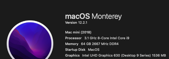

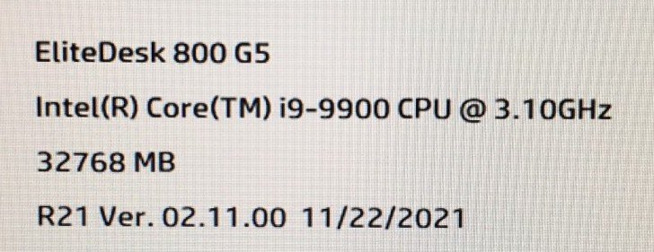

I finally had time to update the BIOS on my HP EliteDesk 800 G5 Mini (from 02.10 to 02.11) and to update OpenCore from OC 0.7.6 to OC 0.7.7. I'm still running Big Sur 11.6.2 as my production baseline OS. Both updates were without challenges. More details below...
I updated my HP EliteDesk 800 G5 Mini BIOS from 02.10 to 02.11 using HP's updater within the BIOS. This BIOS update method did not work for me when updating to 02.10 and I had to boot Windows and perform the update to 02.10 using HP's Windows executable. The BIOS update from 02.10 to 02.11 required multiple reboots (after starting the BIOS update, be patient, don't touch any keys and and wait for all updates to complete). The only "issue" I experienced after the BIOS update was that my storage boot order was reset to factory. I like USB to boot first and I disable SATA0 boot, so I needed to modify my boot order after the BIOS update. After the BIOS update to 02.11, all appears to be working normally.
I updated OC 0.7.6 to OC 0.7.7 with the changes here. The OC update to 0.7.7 was uneventful.

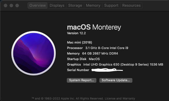

I updated my 800 G5 Mini BIOS to version 02.12.00 Rev.A using the built-in updater within the BIOS - no issues.  Just be patient with lots of reboots and messages indicating that "this will take a few minutes."  Once I started the process, I didn't touch my system again until macOS booted.
I will not be testing the firmware update on an 800 G4 Mini (I no longer have a G4 Mini running macOS), so if someone else performs this BIOS update on their G4 Mini, please report your results. Thank you.
