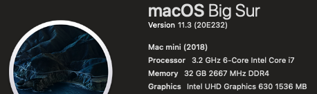

Just upgraded to Big Sur 11.3 using the OC 0.6.8 EFI r004 (attached to Post #1). No issues. Upgrade was flawless. The key to this upgrade seems to be that Kernel > Quirks > XhciPortLimit = False in the OC config.plist and you have a properly constructed USBPorts.kext with no more than 15 logical USB ports.
About This Mac: Big Sur 11.3
Spoiler

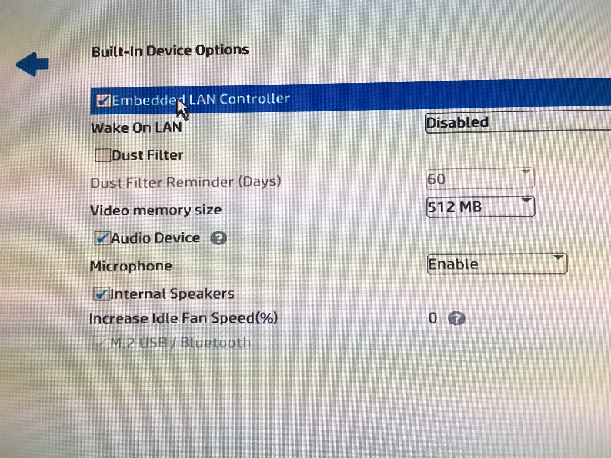

Im using your latest version (OC 0.6.9 EFI R002)  with the mini 800 g5 and I have no ethernet.  all that it there is the bluetooth interface.  I didn't modify the EFI at all.  Do you know what could be wrong?
Edit: intelmausi isn't loaded per kextstat | grep -v com.apple
Edited by lolwatpear
@lolwatpear Please post your sanitized EFI (remove ROM, MLB, SystemSerialNumber, SystemUUID).
EDIT: @lolwatpear I just downloaded OC 0.6.9 EFI R002 and copied it to the EFI on a USB thumb drive.  I edited config.plist to insert my ROM, MLB, SystemSerialNumber, SystemUUID.  All working perfectly.  Hopefully we'll be able to figure this out after you upload your actual EFI (sanitized).
EDIT2: @lolwatpear  While you're collecting your sanitized EFI to upload, check your BIOS to make sure that Embedded LAN is enabled.  I just tested to see this for myself: if your Embedded LAN is disabled in BIOS, IntelMausi doesn't load (and you won't have Ethernet).
BIOS: Built-in Device Options
Spoiler
Edited by tonyx86
  Hide contents
Sorry, for some reason my second update to that post wasnt added hours ago and thought it was.  The mini version of the 800 g5 uses realtek lan, not Intel. The realtek kext made it work.  Thanks for the setup.
@lolwatpear I have both the HP Elitedesk 800 G4 Mini and HP EliteDesk 800 G5 Mini (pictured in Post #1).  Both have Intel LAN and both use IntelMausi.kext.  The HP Specs indicate Intel LAN as well.  Are you sure you have an HP EliteDesk 800 G5 Mini?  It could be, but it's the first that I've heard this.  If you can post a picture of your PC, that would be helpful.  Thank you.
Sorry I figured it out.  Im using the prodesk 400 g5.  When I searched for an opencore EFI for prodesk 400 g5, your thread comes up and I just missed the whole elite/prodesk naming convention lol.  So the NIC must be one of the few differences between the the two.  Otherwise, your EFI appears to be working great for the prodesk 400 g5 in my case.
