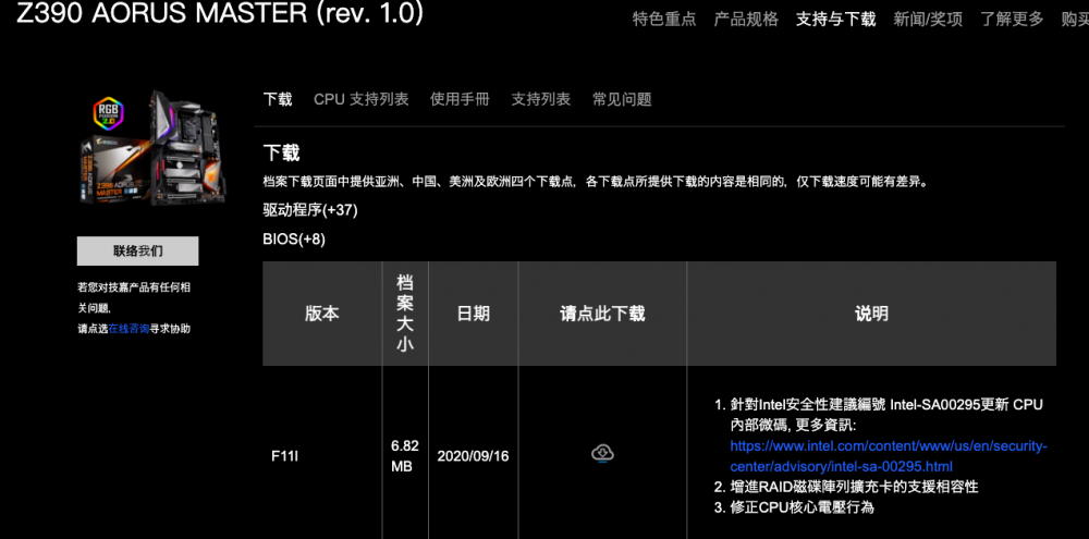

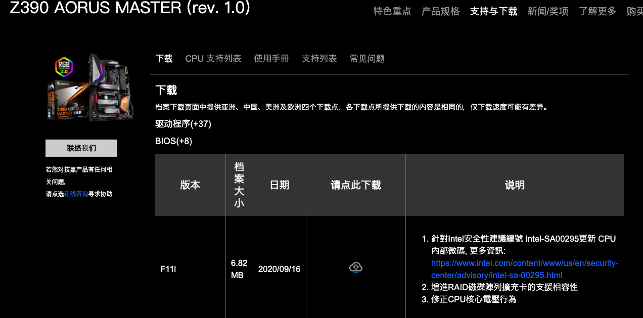

Tested OC with 11L
Unfortunately for me USB 3 (C) ports don't work - did everything as you said.
All red ports are dead - as well as USB C port. Yellow ports and USB 2.0 are fine
Edited by lygi
  • Confused 1
2 minutes ago, AudioGod said:
@lygi All ports are working normally over here, I just double checked.
did you reset your nvram before booting into the new EFI?
also are you using the new 0.6.3 EFI?
NVRAM reset, and just downloaded 0.6.3 (before I used Clover), also 11L with your default profile.
Everything booted without a single issue, but still having 15 active ports for some reason
