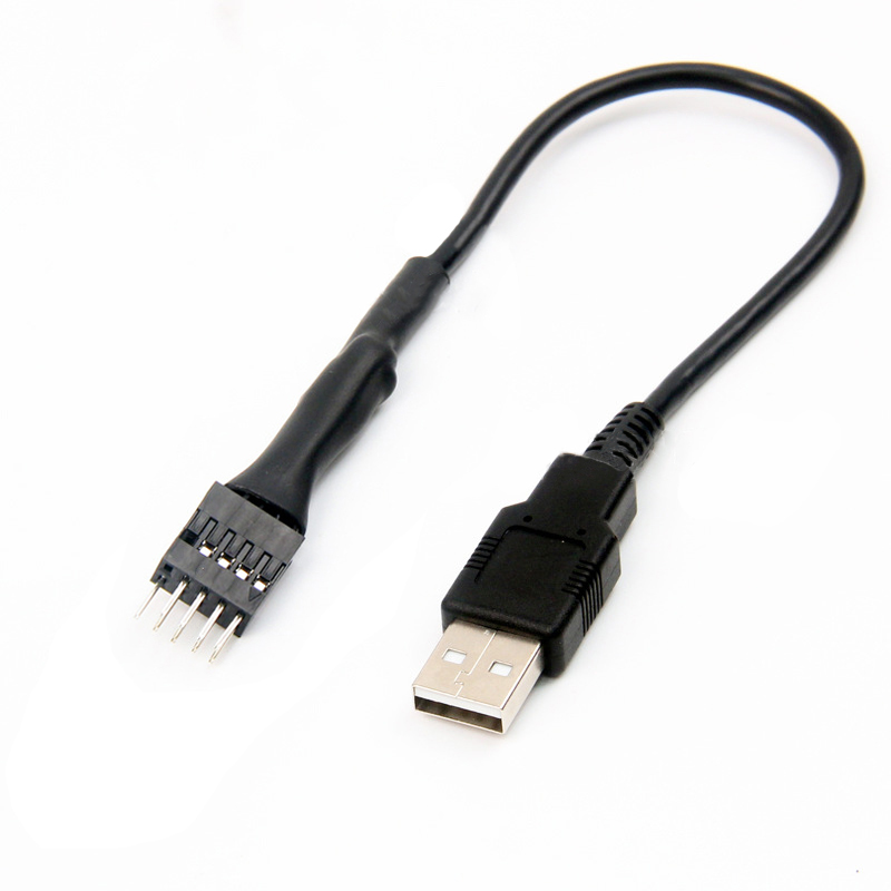

But do you know why sometimes the Bluetooth crashes and then all the USB connections/plugs don't work anymore? It is very annoying to push every time the power button to get the computer off because the mouse and keyboard aren't working when this happens.
Is this happening with the new EFI bud?
If not then wait to see if it happens again.
if it’s Bluetooth related then you could try moving the internal usb connection to the other internal header.
clear your nvram a couple of times in a row and make sure your using bios F11L or F11M (link for M is a few posts back)
and lastly if the problem started with the new EFI then try downloading it again and adding back your details.
