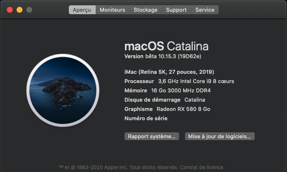

Matgen84 Posted January 15, 2020 Share Posted January 15, 2020 Hi @AudioGod Update to 10.15.3 Beta 2 with Bios F11c EFI folder: all works fine as usual Some questions: what these lines means in kernel.log? They could be ignored? (AppleSMCLMU) AppleLMUController::smcGetKeyInfo Error: received error 0x84 when getting key info for 'ALRV' (AppleSMCLMU) AppleLMUController::smcReadKey Error: received error 0x84 when reading key 'MSLD' (AppleSMCLMU) AppleLMUController::smcReadKey Error: received error 0x84 when reading key 'ALV0' Already present since BIOS F9, these lines at startup: (AppleUSBXHCI) 000003.712224 XHC@14000000: AppleUSBXHCI::createPorts: unsupported speed mantissa 1248 exponent 2 (AppleUSBXHCI) 000003.713073 XHC@14000000: AppleUSBXHCI::createPorts: unsupported speed mantissa 2496 exponent 2 (AppleUSBXHCI) 000003.714206 XHC@14000000: AppleUSBXHCI::createPorts: unsupported speed mantissa 4992 exponent 2 (AppleUSBXHCI) 000003.714528 XHC@14000000: AppleUSBXHCI::createPorts: unsupported speed mantissa 1457 exponent 2 (AppleUSBXHCI) 000003.847274 XHC@14000000: AppleUSBXHCI::createPorts: unsupported speed mantissa 2915 exponent 2 (AppleUSBXHCI) 000003.847442 XHC@14000000: AppleUSBXHCI::createPorts: unsupported speed mantissa 5830 exponent 2 Link to comment https://www.insanelymac.com/forum/topic/340936-audiogods-aorus-z390-master-patched-dsdt-efi-for-catalina-mini-guide-and-discussion/page/11/#findComment-2704338 Share on other sites More sharing options...
AudioGod Posted January 15, 2020 Author Share Posted January 15, 2020 (edited) 2 hours ago, Matgen84 said: Hi @AudioGod Update to 10.15.3 Beta 2 with Bios F11c EFI folder: all works fine as usual Some questions: what these lines means in kernel.log? They could be ignored? (AppleSMCLMU) AppleLMUController::smcGetKeyInfo Error: received error 0x84 when getting key info for 'ALRV' (AppleSMCLMU) AppleLMUController::smcReadKey Error: received error 0x84 when reading key 'MSLD' (AppleSMCLMU) AppleLMUController::smcReadKey Error: received error 0x84 when reading key 'ALV0' Already present since BIOS F9, these lines at startup: (AppleUSBXHCI) 000003.712224 XHC@14000000: AppleUSBXHCI::createPorts: unsupported speed mantissa 1248 exponent 2 (AppleUSBXHCI) 000003.713073 XHC@14000000: AppleUSBXHCI::createPorts: unsupported speed mantissa 2496 exponent 2 (AppleUSBXHCI) 000003.714206 XHC@14000000: AppleUSBXHCI::createPorts: unsupported speed mantissa 4992 exponent 2 (AppleUSBXHCI) 000003.714528 XHC@14000000: AppleUSBXHCI::createPorts: unsupported speed mantissa 1457 exponent 2 (AppleUSBXHCI) 000003.847274 XHC@14000000: AppleUSBXHCI::createPorts: unsupported speed mantissa 2915 exponent 2 (AppleUSBXHCI) 000003.847442 XHC@14000000: AppleUSBXHCI::createPorts: unsupported speed mantissa 5830 exponent 2 the usb errors are due to the USB Patching and you can totally ignore them, The smc errors I’m not so sure. When did they appear? Was it after installing 10.15.3? Are you using the latest VirtualSMC kext and is it still there with the older one? Edited January 15, 2020 by AudioGod Link to comment https://www.insanelymac.com/forum/topic/340936-audiogods-aorus-z390-master-patched-dsdt-efi-for-catalina-mini-guide-and-discussion/page/11/#findComment-2704352 Share on other sites More sharing options...
Matgen84 Posted January 15, 2020 Share Posted January 15, 2020 3 hours ago, AudioGod said: the usb errors are due to the USB Patching and you can totally ignore them, The smc errors I’m not so sure. When did they appear? Was it after installing 10.15.3? Are you using the latest VirtualSMC kext and is it still there with the older one? About the smc errors, I don't know when they appear before or after 10.15.3 Beta. Yes, I'm using latest VirtualSMC v1.10 from this topic. Don't test the previous version. Link to comment https://www.insanelymac.com/forum/topic/340936-audiogods-aorus-z390-master-patched-dsdt-efi-for-catalina-mini-guide-and-discussion/page/11/#findComment-2704391 Share on other sites More sharing options...
AudioGod Posted January 15, 2020 Author Share Posted January 15, 2020 58 minutes ago, Matgen84 said: About the smc errors, I don't know when they appear before or after 10.15.3 Beta. Yes, I'm using latest VirtualSMC v1.10 from this topic. Don't test the previous version. I haven’t got the error showing in my log. Could be the latest version of VirtualSMC so try the older version just to see if the problem remains. could also be your kernel cache so maybe clear that first and see 1 Link to comment https://www.insanelymac.com/forum/topic/340936-audiogods-aorus-z390-master-patched-dsdt-efi-for-catalina-mini-guide-and-discussion/page/11/#findComment-2704399 Share on other sites More sharing options...
Matgen84 Posted January 15, 2020 Share Posted January 15, 2020 30 minutes ago, AudioGod said: I haven’t got the error showing in my log. Could be the latest version of VirtualSMC so try the older version just to see if the problem remains. could also be your kernel cache so maybe clear that first and see I try the older VirtualSMC version 1.0.9: no smc errors Link to comment https://www.insanelymac.com/forum/topic/340936-audiogods-aorus-z390-master-patched-dsdt-efi-for-catalina-mini-guide-and-discussion/page/11/#findComment-2704405 Share on other sites More sharing options...
