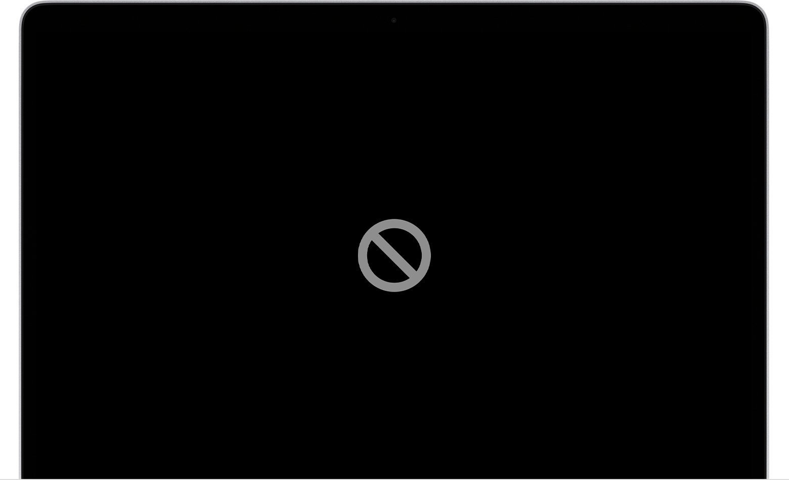

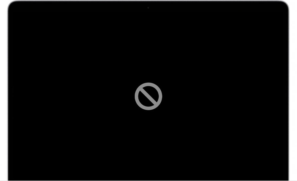

jake_mike Posted February 6, 2020 Share Posted February 6, 2020 (edited) On 2/4/2020 at 7:39 PM, AudioGod said: Yes sure no problem give me 30mins as I’m just eating my dinner bud side note - if you disable igpu and change shiki too 144 in the boot arguments it’s the same thing but your still running under the correct smbios 19,1 if you do that instead then let me know how it goes for you? I updated the new EFI, disabled the iGPU and changed the shikigva=144. I am now getting this Edited February 6, 2020 by jake_mike Link to comment https://www.insanelymac.com/forum/topic/340936-audiogods-aorus-z390-master-patched-dsdt-efi-for-catalina-mini-guide-and-discussion/page/15/#findComment-2707282 Share on other sites More sharing options...
AudioGod Posted February 6, 2020 Author Share Posted February 6, 2020 2 hours ago, jake_mike said: I updated the new EFI, disabled the iGPU and changed the shikigva=144. I am now getting this Did you do a battery reset of the bios like the notice explains to do? Link to comment https://www.insanelymac.com/forum/topic/340936-audiogods-aorus-z390-master-patched-dsdt-efi-for-catalina-mini-guide-and-discussion/page/15/#findComment-2707297 Share on other sites More sharing options...
jake_mike Posted February 6, 2020 Share Posted February 6, 2020 20 minutes ago, AudioGod said: Did you do a battery reset of the bios like the notice explains to do? No, since I am on the CFG Unlock (MSR) F11c BIOS Profile (with disabled iGPU) I thought I can skip the BIOS reset step? Link to comment https://www.insanelymac.com/forum/topic/340936-audiogods-aorus-z390-master-patched-dsdt-efi-for-catalina-mini-guide-and-discussion/page/15/#findComment-2707300 Share on other sites More sharing options...
AudioGod Posted February 6, 2020 Author Share Posted February 6, 2020 Just now, jake_mike said: No, since I am on the CFG Unlock (MSR) F11c BIOS Profile (with disabled iGPU) I thought I can skip the BIOS reset step? Try doing a soft reset instead, remove all power and then press the bios reset button on the io shield and try it that way but if that doesn’t work then pull the battery. needs to be done to fully reset the bios memory. Link to comment https://www.insanelymac.com/forum/topic/340936-audiogods-aorus-z390-master-patched-dsdt-efi-for-catalina-mini-guide-and-discussion/page/15/#findComment-2707301 Share on other sites More sharing options...
jake_mike Posted February 6, 2020 Share Posted February 6, 2020 1 hour ago, AudioGod said: Try doing a soft reset instead, remove all power and then press the bios reset button on the io shield and try it that way but if that doesn’t work then pull the battery. needs to be done to fully reset the bios memory. After the reset I should install the CFG Unlock (MSR) F11c BIOS Profile again? When should I upload the new EFI? After the reset? Link to comment https://www.insanelymac.com/forum/topic/340936-audiogods-aorus-z390-master-patched-dsdt-efi-for-catalina-mini-guide-and-discussion/page/15/#findComment-2707307 Share on other sites More sharing options...
