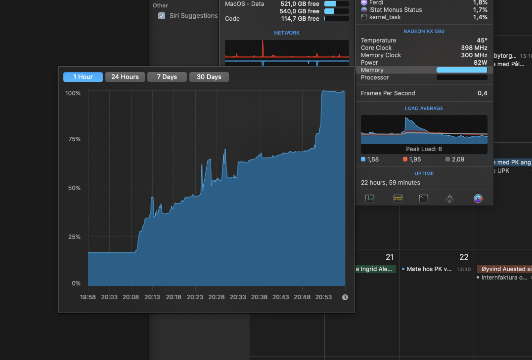

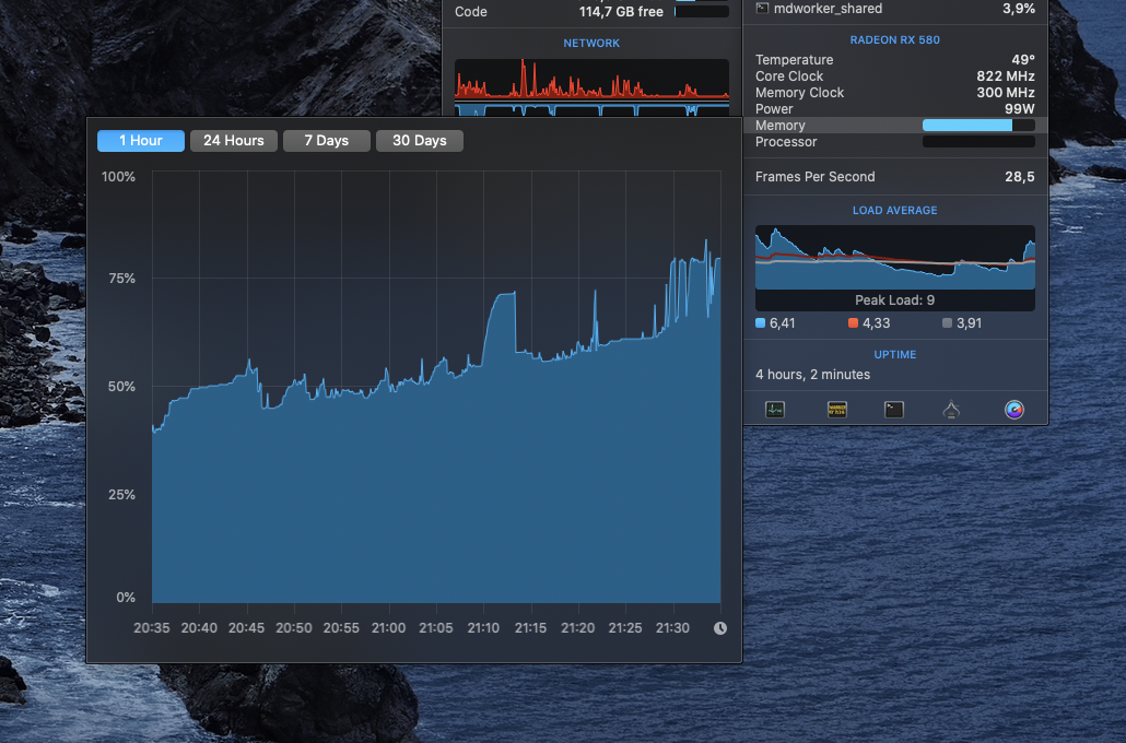

I'm starting to think it's related to the RX 580. I did notice that it was using almost 100% memory yesterday when it really started acting up. I just noticed a couple of micro freezes and it looks like the GPU memory usage is slowly increasing.. ->
Thoughts?
Edit: Note, the freezes now just happened when I connected my watch (garmin) to sync it with garmin express.

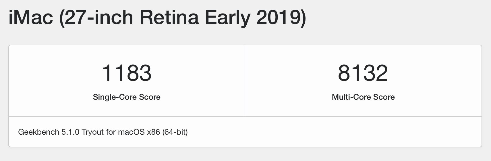

3. The Geekbench scores are super low, but the system itself seems to be working fast.

your Geekbench score are right for Geekbench 5. (they changed the scoring system from version 5 on) if you wanna see bigger numbers use Geekbench 4 but it looks correct to me. :thumbsup_anim:

Ah cool, they seemed to be off when I was comparing to yours that's why I was a bit concerned :)
